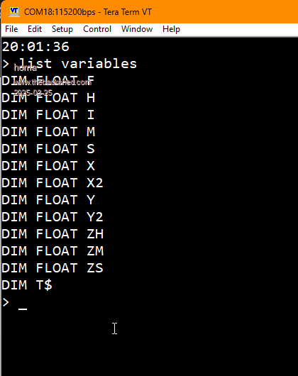

ville56
Joined: 08/06/2022
Location: Austria
Posts: 646
Posted: 06:43pm 24 Mar 2025
  matherp said
There is a newline when I use it with teraterm or on the VGA or HDMI output
Sorry Peter, there are no newline ... please see attached screenshot with control chars visible.
List-vars.zip

homa
Joined: 05/11/2021
Posts: 725
Posted: 07:06pm 24 Mar 2025
> option list
PicoMiteHDMI MMBasic USB RP2350A Edition V6.00.02RC7
OPTION SYSTEM I2C GP20,GP21
OPTION FLASH SIZE 4194304
OPTION COLOURCODE ON
OPTION KEYBOARD GR
OPTION CPUSPEED (KHz) 315000
OPTION RESOLUTION 640x480
OPTION SDCARD GP22, GP26, GP27, GP28
OPTION AUDIO GP10,GP11', ON PWM CHANNEL 5
OPTION RTC AUTO ENABLE
OPTION MODBUFF ENABLE  192
OPTION PLATFORM HDMIUSB
  ville56 said
List-vars.zip
That is astonishing ...
Matthias
Edited 2025-03-25 05:08 by homa
toml_12953
Joined: 13/02/2015
Posts: 736
Posted: 07:11pm 24 Mar 2025
  matherp said  V6.00.02RC7 is available on
Isn't TIMER supposed to be the number of milliseconds since either power-on, reset or setting it to 0? If so, I'd expect an integer. When I print TIMER, though, it prints three decimal places. Why?
If I set TIMER to 0 at the beginning of a routine, can I just divide TIMER by 1000 at the end to get the number of seconds elapsed?
toml_12953
Joined: 13/02/2015
Posts: 736
Posted: 07:20pm 24 Mar 2025
  ville56 said
List-vars.zip
I get the same output as you do no linefeeds. I use TeraTerm 5.40 on Windows 11.
I tried setting the terminal New-line options but no combination of CR and LF changes it. My terminal ID is VT100.
Posts: 12067
Posted: 07:26pm 24 Mar 2025
Try again now

Matthias
ville56
Joined: 08/06/2022
Location: Austria
Posts: 646
Posted: 07:53pm 24 Mar 2025
ad LIST VARIABLES:
is now working on RP2350 without LCD console ... thanks Peter !!!!
73 de OE1HGA, Gerald
