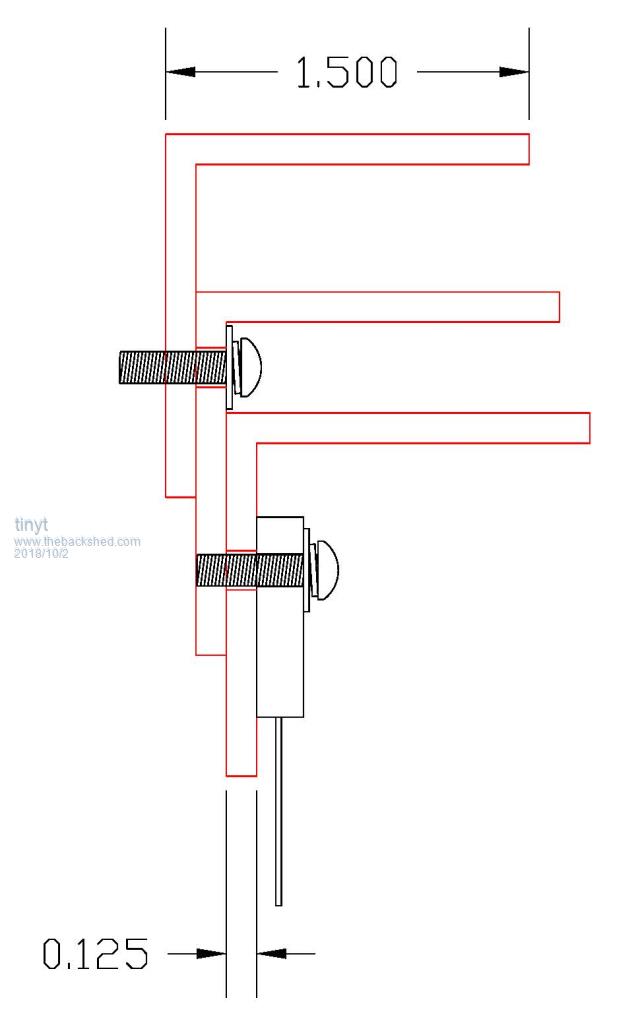

Here is a cross section of the heatsink/mosfet assembly right now.
I might try your heat sink suggestion later. I think I can get the flat bars and U channels here from Almost Anything Supplier

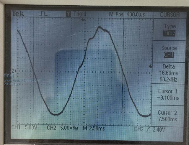

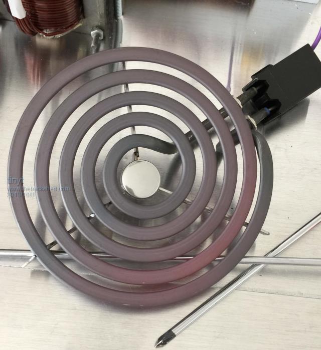

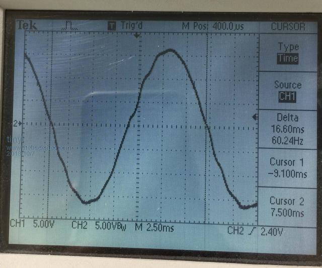

I don't have a 220vac incandescent lamp. But I have a 220vac 1.2kw stove heating element I bought for testing. Here it is powered by the inverter. Could not keep it powered for too long in the house, have to make a better testing setup outside the house.

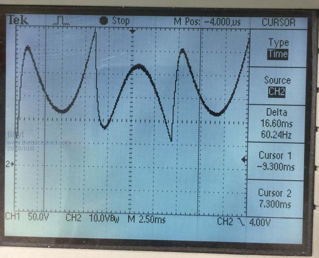

Here is the waveform.
Here are the basic readings:
DC input: 53.8V, 25.28A (53.8 x 25.28 = 1360 watts)
AC output: 229V, 5.25A (229 x 5.25 = 1202 watts)
Loss: 1360 - 1202 = 158 watts
Efficiency: 1202/1360 = .8838 or 88.38%
I am guessing that the loss is mostly in the choke which has smaller copper wire cross section compared to the toroid and power wires. I also have to measure voltage drop in the 100A switch if any.
Will do more testing later.
Posted: 09:21pm 07 Oct 2018
That 158 watts will all show up as heat somewhere, so whatever gets hot will be where your losses mostly are.
Not sure why only the negative half cycle has that discontinuity, the waveforms at the bridge might tell us something.

Posted: 11:49pm 07 Oct 2018
Something is not right, you should be getting a good waveform no matter how much resistive load you have. I would be quite concerned with that result.
My experience with power losses in the Inverter is around 8 - 10 percent.
Posted: 01:21am 08 Oct 2018
Agree something is not quite right, and as its not symmetrical so not likely to be a problem in the magnetics.
Use the 5K1/0.1uF low pass filter suggested on page six of the EGS002 application notes to look at the waveforms coming straight out of both sides of the mosfet bridge
They should look exactly like the waveforms shown.
https://www.egmicro.com/download/EGS002_manual_en.pdf
Looking at the waveforms directly with a digital oscilloscope will just show meaningless garbage. You need to have the low pass filter to average out the high frequency pwm so you can see the 50Hz component.

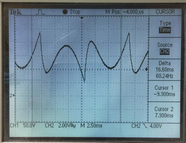

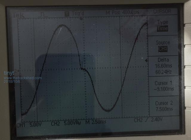

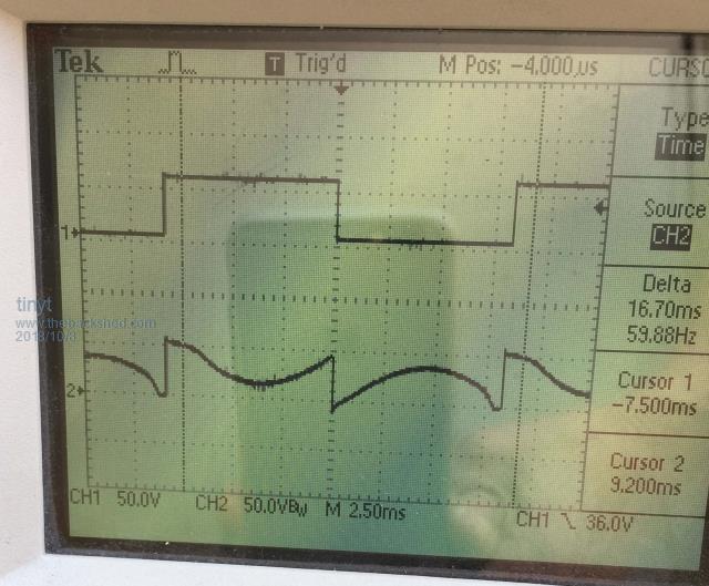

First some clarification to avoid confusion. My toroid has two 12vac windings. One I used for the VFB and other I used for scope waveform monitoring. In my earlier no load resonance test, the 'scope ground and probe is opposite to the connection I made for the 1.2kw load test. So here is that resonance test waveform again with the scope connection matching with that of the 1.2kw load test. It shows the kink starting to appear in the negative slope of the waveform.
Looks like it gets more pronounced when the inverter gets loaded.
Here is the scope with top trace for the toroid primary connection driven by the 60Hz side of the bridge. The lower trace is the other end of the primary coil driven by the choke. This is with 1.2kw load.
Unfortunately, I don't have a 'scope that can capture each of the 23KHz pwm pulse duration. Looks like the discontinuity is being introduced by something inside the EGS002. Maybe the anti cross-conduction transistors are not matched. I don't know. Will use another EGS002 later and see. Or bypass the anti cross-conduction transistors and pray.Edited by tinyt 2018-10-09

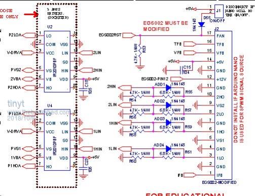

Posted: 02:23am 08 Oct 2018
The sine wave side is definitely distorted around the zero crossing points.
Using the same R/C low pass filter look right at the pins of the EGS002 board and see how it looks there.
If its suspect there, I would try removing those cross conduction transistors and see if that looks any better.
Madness
Joined: 08/10/2011
Posts: 2498
Posted: 02:28am 08 Oct 2018
What does it look like at the output of the EG002? I would think it is more likely to be something to do with your gate drive.

Apologies the post has moved on from when I wrote this. You are on the right track.
What I wrote was - it may still help if the EGS002 waveform is right-
Looks like you will receive a cross section of ideas to draw from. Looking at the RC filtered fundamental shape from the EGS002 is an easy test, if it passes then what?
From inspection it appears that one or maybe more of the drive waveform is not correct at one part of the cycle at the zero cross. I suspect the 25kHz side but dont dismiss the 50/60 fundamental stage yet.
I would do a couple of preliminary checks. With power disconnected, remove the drive cable from the output stage and check gate to source resistance of all 4 sections of the H bridge measures ~5K (1/4 of 20K). Then a resistance check of all D-S are essentially open circuit (note use a meter with a < 0.4V test for the ohms range. Then check using the diode test that D-S of each leg is open in one direction and ~ .3 - .5V in the other direction. If all is ok reconnect to driver board'
With the H power (48V) disconnected, ground the centre of the bridges allowing the upper FET bootstrap sections to have power and then use simple CRO comparisons between the EGS002 SPWM1-4 outputs and the corresponding final Gate drive outputs (after the output buffers) look nearly identical. If all Ok continue..
The next checks are whilst the Bridge stage is powered up & waveform distortion is present and therefore inherently risky. Check the 12V & 17-18 V rails are present and not sagging with a CRO. If the bootstrap rails are sagging near the zero cross a CRO is the best method of checking. An isolated CRO is a must and simply connecting it across the upper bootstrap capacitors, one at a time and ensuring the voltage never drops below 10V. ( It shouldnt drop below ~ 15V in your setup working correctly I reckon).
I would expect somewhere along this path you should identify something amiss ? Good Luck - it is best to follow the order presented, powering the bridge stage again only at the final step, impatience can be dazzling.

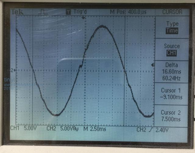

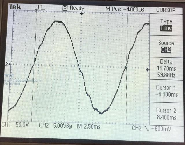

Found my R/C probe. Here is EGS002 pin 8.
And EGS002 pin 10.
The waveform looks similar. But what I notice is the negative peaks only go to 2V instead of zero. So I checked my schematic. The actual fet drivers are IR2010PBF which are driven by the IR2110S in the EGS002. Pin 8 and 10 of the EGS002 goes up to 12V instead of 5V. Edit: -> (I think my analysis here is wrong) -> So I added voltage dividers. I was thinking that maybe the EGS002 is not pulling to zero the IRF2010PBF due to the voltage divider effect. So I added diodes as shown.

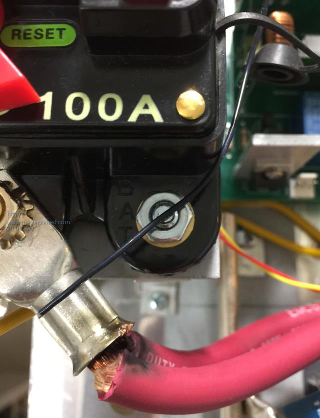

And setup to test.
As the saying goes if it can happen, it will happen. I have a test connector with a thin black wire connected to PCB ground. The 100A switch is at off but the 100A power supply which is connected to the battery bus bars is running. When I was going to connect the test black wire to the scope probe ground wire, it slipped from my finger and the exposed wire strands touched the live 54vdc connector.
The exposed wire strands were vaporized. (I already cut the burned end in the picture). Initial tests indicate that not all grounds are connected. I have to remove PCB from the chassis and do more post-mortem.
I think this qualifies me to join the exclusive club.
Thanks to all for the troubleshooting assistance. Over and Out (for now).Edited by tinyt 2018-10-09

Oh c'mon mate, one bit of singed wire? You haven't even blown a fet yet.
Not in the club yet mate.
BTW that breaker/switch you have are often dubious quality, keep an eye on it.

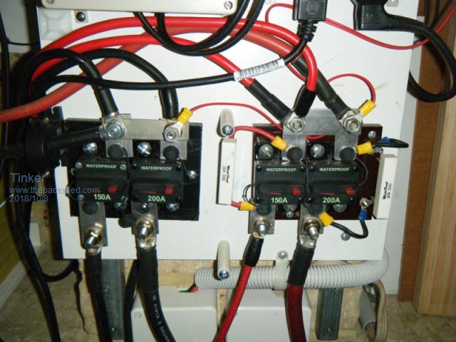

Ralph has a point there if these things were used as breakers.
I use them too but as high current DC switches. There are proper DC breakers inside my inverters and these, being rated lower amperage, will do the tripping if required.
But for a simple high current switch see pic below how I use mine.
Note that there are 4 of these things. Two are in the negative and 2 in the positive inverter connection, serving my two inverters.
Note also that the two positive switches have the soft capacitor charge resistor across the terminals.
With this set up I can:
Completely disconnect each inverter to remove its power cables without having to isolate the lugs at the end since the other end lug is at the open circuit breaker.
Soft charge the capacitors by first closing the negative switch and then, once the green battery light (on my type control board) comes on, close the positive switch.
The inverter can now be soft started by its ON switch.
This might be a bit of an over kill but for an experimenter it has proved invaluable.
A suggestion to tinyt - it apprars he has those breakers on his PCB. This is, perhaps, not the best location for them.
Mine are on the wall close to the battery bank which is to the left on the pic above.

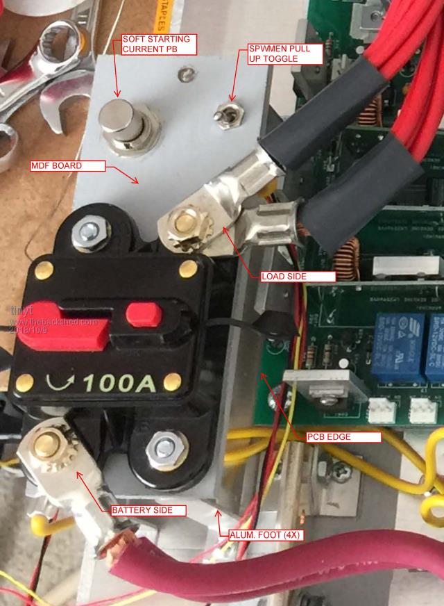

Klaus the breaker is not mounted on the PCB. Here is a close up of that area of the assembly.
It also has a LED indicator (the unlabeled round part between the PB and Toggle) to signal that there is 5VDC on the PCB so that the breaker can be switched on.
  Ralph2k6 said   Mark / tinyt
Narva sell those breakers, only rated to 48v max I think. Breaking a fault with fully juiced batteries would be over 60v ?
Here is my understanding of voltage rating of switch/breaker contacts. If switch loads are not capacitors, when the contacts break, the full dc voltage appears across the breaking contacts and an arc will form and will get extinguished if the broken contacts have enough final gap to do it. So, the higher the voltage rating, the bigger the final gap of the contacts should be when they open.
In my application, the load are bulk capacitors that get fully charged to the applied voltage when the breaker is switch on. So when the breaker contacts separate, at that moment, both sides of the contacts have zero volt difference and no un-wanted arc will form.
Add Edit: That EGS002 pin 10 waveform I posted earlier is incorrect. I think that is for the boosted fet gate drive, I don't remember anymore, I was taking too many pictures. I will have to revisit the waveforms after I fixed the PCB. They don't exactly match with what is shown in the EGS002 data sheet. Also, I think that EGS002 datasheet waveform is taken straight from the EG8010 pins or outputs of the anti cross-conduction transistors and not the EGS002 connector TEST pins, the peak-to-peak is only 4 volts.Edited by tinyt 2018-10-10

I have not had any trouble with AC, MCB breaking the 48v circuit under load .
But the AC, MCB will fail ( fuse the contacts together) if you try to switch on the 48v supply, to charge the main inverter capacitors.
cheers john

Yes, that is why I have a momentary push button that soft-charge the bulk capacitors thru a resistor prior to switching on the 100A circuit breaker.
On the inverter, I still have to make it work correctly. Lucky me I still did not qualify to join the exclusive club. Edited by tinyt 2018-10-10
