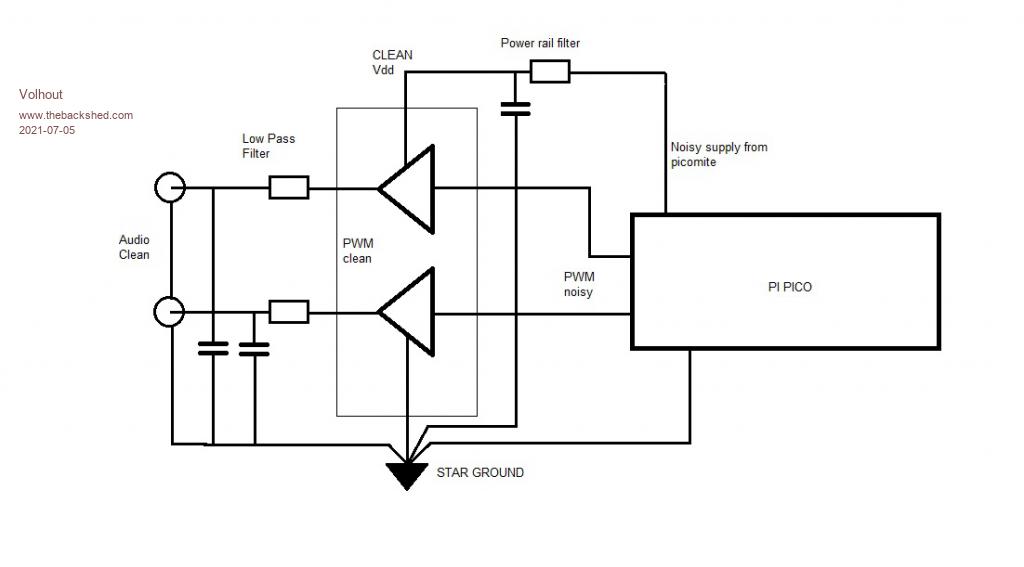

PWM signals can be used to make simple analog signals by using their pulsewidth to convert a voltage (the amplitude) by a low pass filter into a an analog voltage.
The result is a multiplication of duty cycle and digital power rail voltage.
Improving the audio can be achieved by improving the power rail (linear regulator), but also by taking it completely out of the equation.
In example:if you pass the PWM signal through a logic buffer gate, powered from a clean voltage, you achieve the same (without modification the the picomite).
The clean voltage can be a 100ohm/100uF filter on 3.3V or 5V, the buffer a 74LVC04.
An other alternative is clamping the 3.3V PWM signal to a clean voltage (in example a 3.3k series resistor to a silicon diode (1N4148), the same way Geoff made VGA video on the CMM1). Of coarse the amplitude will be 5x lower (3.3V->0.6V), but noise will be 100x lower (diode rd=33ohm at 0.75mA, Rseries = 3.3k). A S/N gain of 100/5=20x. As most amplifiers have gain, the lower level is not a problem.

You actually want to isolate everything that is related to the ground and power rail. If you choose an optocoupler it should be fast: use digital optocoulers. There are the classic ones such as 6N136, but these required high LED currents (for picomite: require a driver transistor/buffer), and the modern ones such as TLP2345/TLP2745 that can be driven directly from the picomite since they only require 2mA LED current.
But that is not needed. In the audio system you can create your own star ground (and you should) with a simple buffer, as described earlier. As long as your ground noise and 3.3V noise stay outside the logic levels of the buffer chip.
P.S. I have drawn a single stage low pass filter, but (depending the PWM frequency) you may need a multistage filter. A single RC is only 6dB/octave. If you need 60dB wideband S/N you need 10 octaves between your highest audio frequency and the PWM frequency. 10 octaves = 2^10 = 1024. For 8kHz your PWM should run at 8MHz. Many of these cheap solutions (single RC) rely on the fact that the human ear cannot hear anything above 30kHz anyway.

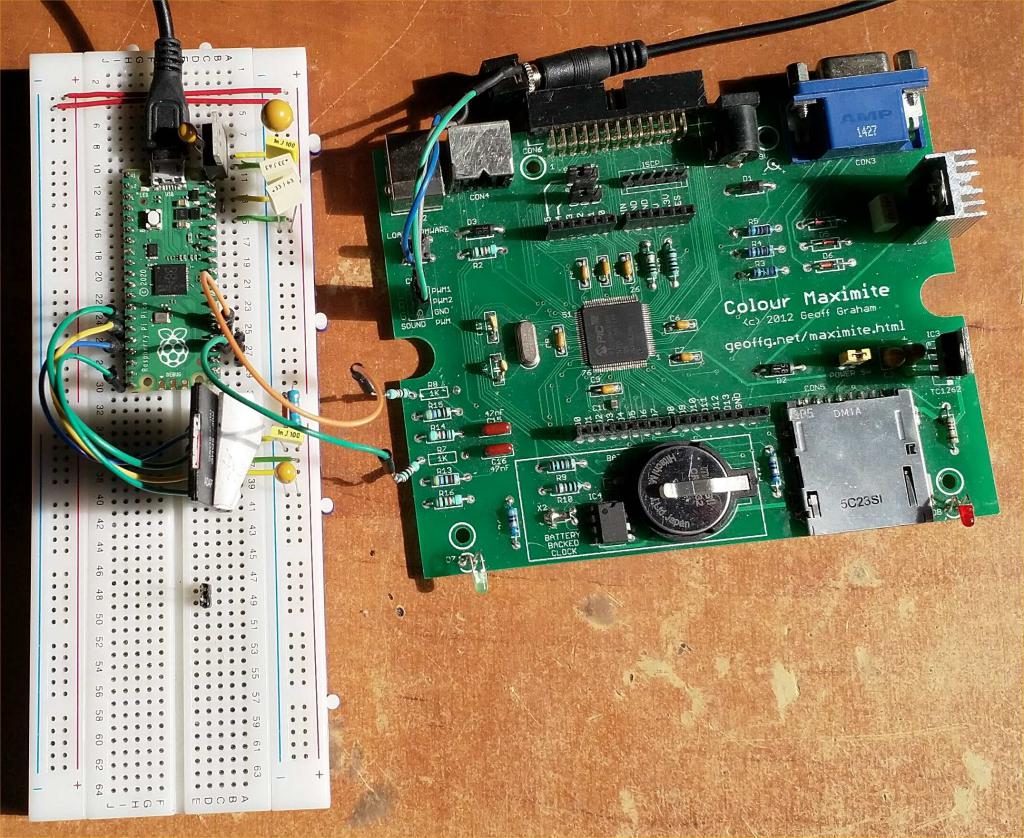

PicoMite with low dropout linear regulator (LM1084) taking power from VBUS and feeding 3V3. 3V3_EN tied to GND. 10uF across input and 100uF + 2 x 0.33uF + 0.1uF across output.
SDcard connected to 3V3 via 4R7 resistor with 100nF and 33uF caps across the SDcard power.
Using Colour Maximite for the audio low pass filter by connecting to R7 and R8
Perfect sound with no noise

Where is your ground connection between Picomite and colour maximite ? Is that running via the USB ground ?
Posts: 11870
Posted: 05:17pm 05 Jul 2021
  Quote  Where is your ground connection between Picomite and colour maximite ? Is that running via the USB ground ?
Sorry to mislead: I'd pinched the gnd link for something before I took the picture

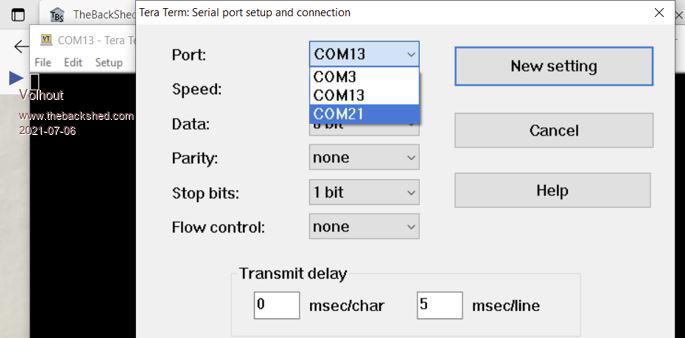

Re Picomite Doc
@Volhout
Got a couple of these units the other day to experiment with. Thanks for the summation document, it got me started and I have copied the latest UF2 file to the device but now need to know how to program it. I will be using Tera Term but I need to know if I have to connect to some of the IO pins or whether it can be done over the USB port provided.
Could you please elaborate a little on how to program the Pico.

  Glen0 said  Re Picomite Doc
It can only be connected to via the USB. When you plug it in a new COM port should become visible for teraterm. Connect using the new COM port and you should have the command prompt.

Posts: 6112
Posted: 11:41am 06 Jul 2021
@Glen0,
Can you put the firmware onto the pico ? IF yes, program the pico with the latest version. Some older versions do no start up on all picos...
https://www.thebackshed.com/forum/uploads/matherp/2021-07-04_220651_PicomiteV5.07.00a48.zip
After copying of the firmware onto the pico, simply do nothing, wait a few seconds. Then the memory device will disappear because the pi starts MMBasic.
If you can program the pico, your cable is OK. So we can rule that out.
Teraterm should see the new com port automatically (no reason to unplug and plug again. In my case COM21.
