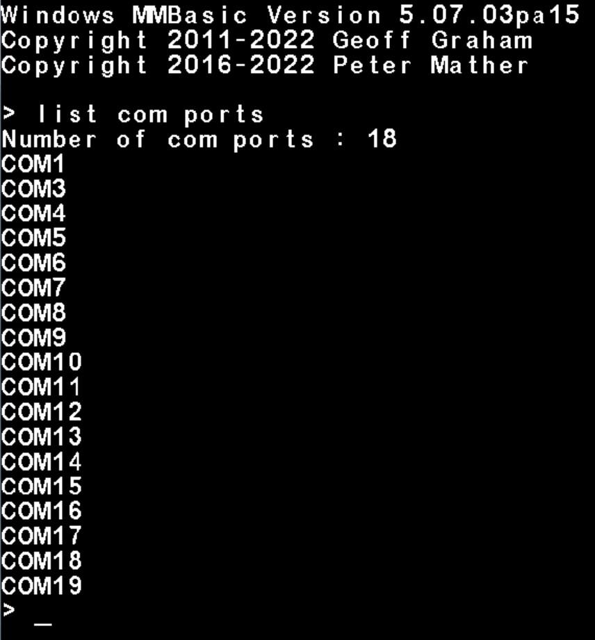

toml_12953
Joined: 13/02/2015
Posts: 720
Posted: 10:22pm 11 Feb 2022
  TassyJim said  com port recognition works for me. W10 64bit.
What OS are the ones that fail running on? Is it 32 bit?
I'm running on 64-bit Win 11. All 18 com ports (yes!) are listed properly. I use a 16-port USB to RS-232 converter.

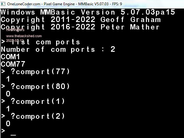

twofingers
Joined: 02/06/2014
Posts: 1769
Posted: 10:43pm 11 Feb 2022
PA15 com port recognition works for me too. W7 64bit.
