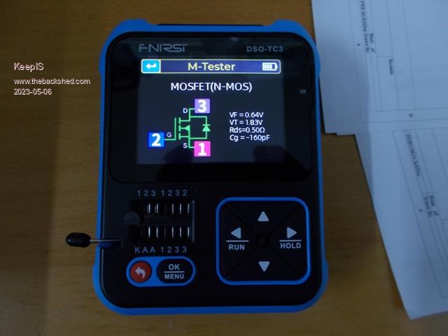

I wanted a small DSO for quick LF, audio and digital work. These were pretty cheap, rated to 500KHz, but surprised it's only very slightly down at 1Mhz. It came with a good 100mHz CRO probe and some other features I didn't even look at.
Now, I know there have been tons of testers around for years, but I never bothered as I just used a multi meter and they used to be a bit pricey for limited use. So apart from the usual inductance, capacitance, resistance, zeners to around 30V, some IR sensor decode and temperature sensors, it comes with a nice clear indication of some unknown devices.
The DSO screen is good with plenty of options, great for monitoring the Inverter AC, and it has a long battery life.
But this came in handy today whilst going through a box of unknown devices, so dam fast and easy.

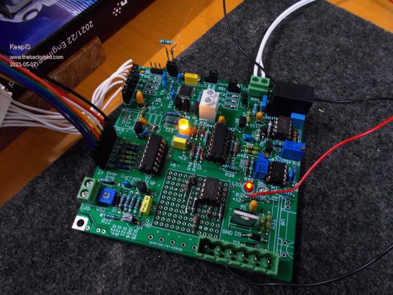

I tested the control board and was greeted by a flashing low voltage code, which I thought was great, it lives.
I fed it a 50Hz sinewave from my generator and checked I had 100HZ half wave signal out of the Pre-Rectifier. I could not make the Error code go away though.

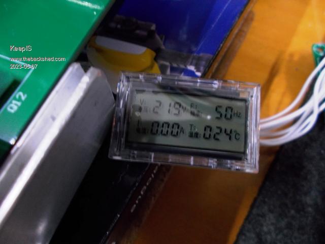

I have a few of the small LDC display units for the 8010 boards, these fit to a header on the 8010 boards. I decided to see if one would work here as it might save me some time with fault finding controller status.
Fortunately I wired in the LCD header when I built the board, and I'm sooooo glad I did. I rewired the pins on the LCD cable to suite your layout.
Result was a neat display showing 50Hz, temperature over range ,fitted a 10k and got temperature to 24deg, all appeared good.
Fed in my 50Hz and it showed the expected AC voltage on the display, but I could not stop the under voltage Code.
I checked the PWM outputs and all were working correctly, and the inhibited state logic was correct.

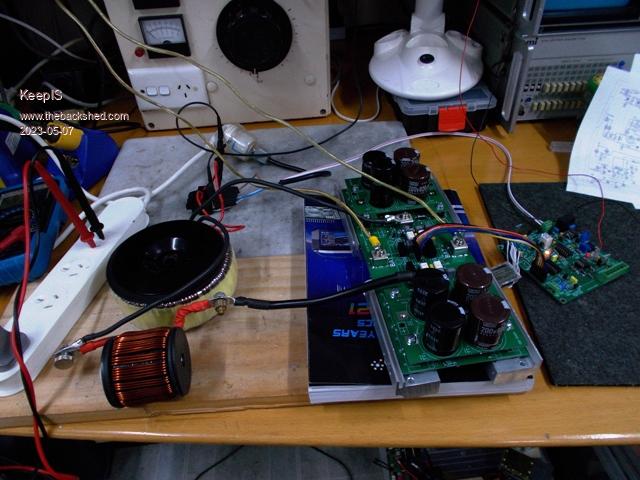

Connected a PSU to the Power unit, a small 12 to 240v toriod, a choke and a some small value cap on the power board and fired it up (resonated Toriod first).

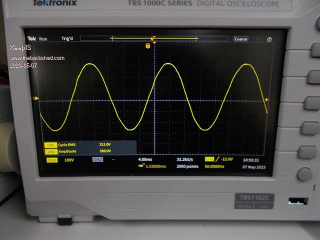

It worked first go, 240vac output and soft start working correctly, tried it with over temp, and dropping 12v DC power to Controller, it shuts down correctly, soft starts when 12V power returns, or if testing over temp, when temperature is back to normal.
AC wave form was a nice sinewave but a slightly rounded due to almost no CAPS.
So now I can set it up to Latch and not power up.
So unbelievably, I built the Power board and the Controller board over two days and the whole dam thing appears to have worked first go
The only problem is I need more capacitance, both my supplies go bit nuts with incorrect voltage shown supplying the Power board, and I cannot adjust the AC output, however the Controller and LCD correctly show me changing the expected output based on the VFB, so I think it's down to too little capacitance, the small cap I was using for the test was getting warm. Expected low current across both board though.

I fitted each test cap board with around 3000uF, for a total of 6000uF, that 4000uf less that just ONE of the eight big caps I'm going to use.
Much better behavior from the Power supply now.
I can now adjust the AC Voltage, BUT the little LCD stays at 219v now, it climbs up to that at power on and stays there? Maybe the 8010 Firmware is doing more with AC input then we think and 100Hz is upsetting the voltage calculated for the LCD display?
The VFB pot is nice and smooth and regulation under load is fine, and as I said, it adjusts 230vac out fine.
I only ran a small load as I'm limited to PSU 5A current trip at the moment. Left it running for an hour, all cold and happy so far. About to connect the Current Xformer.
Unknown transformer, did not test turns ratio, nominal 13v to 240v toriod on label.
No AC out filter, one choke and 6000uF caps.
Madness

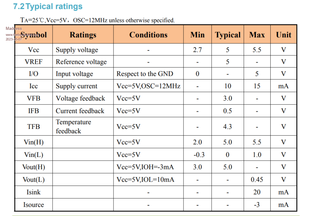

The EG8010 is VFB expecting 3VDC as per this table in the datasheet.
Just use a 12v or similar transformer, rectifier and voltage divider and you're in business.
