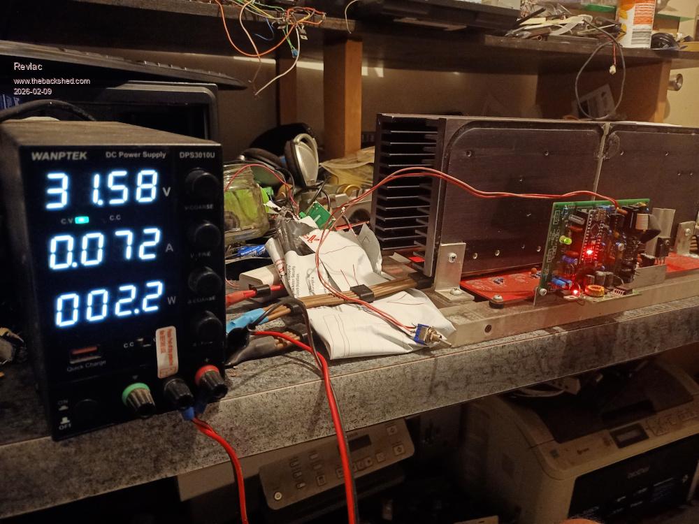

Just thought I could power up this control board with the Mad power board as a comparison...not the same as yours but might be a little help.
this is without the LCD or Toroid and no capacitors connected, 1 Fet per Leg (for testing) and was originally set for 48v, powered to 25v ans used 0.029, on or off was the same as under voltage was enabled.
Tried powering up quickly to 31.5v and the green power light come on, obviously used a little more power (0.072a) before under voltage lockout and then the green power light went out.
Your power consumption may be similar or higher.
I will try to dig a little deeper to see were the problem short might be.

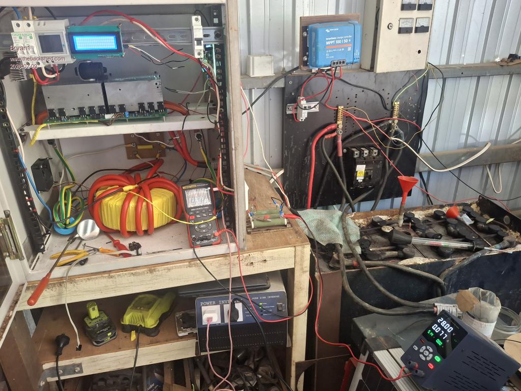

Joined: 22/02/2006
Posts: 2297
Posted: 10:30pm 09 Feb 2026
Well went thru my laptop last night trying to find the schematics for this project without luck as this project does go back over a couple of HD failures.
Now I did get Roger to solder on the nano for the brainboard and he did go right over the board fixing some some of my dodgy soldering. Also the power board connections was done by Roger where he had a gander over the board and didn't see any problems.
With that isolation paper I found on an old heatsink got 18 made so the hunt will be on for the last 2 pads so the back of the board can be isolated. Then I can have a look at the power board again with fresh eyes to see if there are any problems.
Now after I isolated the front heatsinks I did split the 50 sqmm leads on VS1 and VS2 just to see if that was the issue where I used the lead on the front heatsink side but sadly that isn't the problem.
Regards Bryan

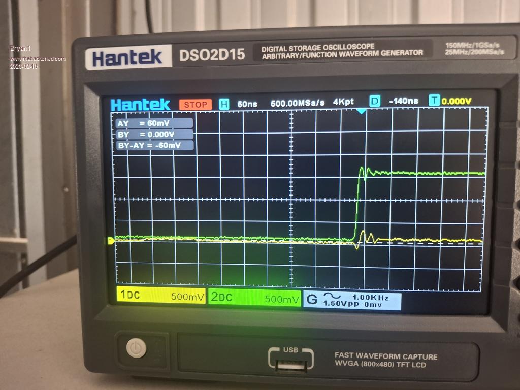

Bryan1
Joined: 22/02/2006
Posts: 2297
Posted: 01:32am 10 Feb 2026

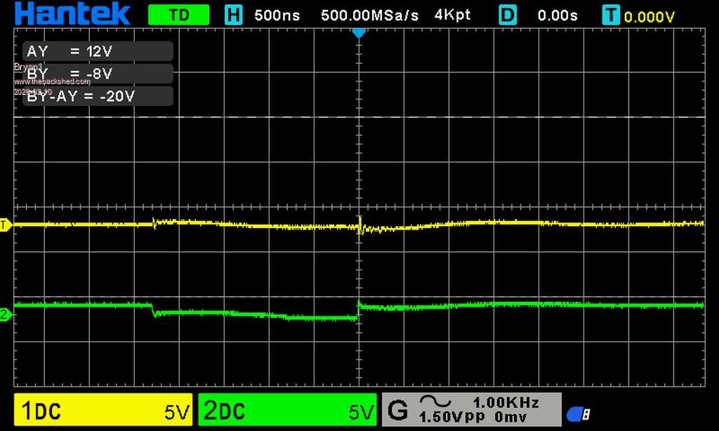

Ok setup my scope and I traced the pin position on blank pcbs.
So channel 1 is VS2 high side
Channel 2 is VS2 low side
Now don't call me a scope expert but can take some time to get the screen set.
Now I thought I was heavy handed in making the 10 pin cable as my ribbon thread is close to 20 years old and my method of using my jewelers vise to close the connection so I made another one and closed it gently and tried that but still no go.
Now as I do have the scope setup any suggestions for other pins to trace would be welcome
Edited 2026-02-10 12:24 by Bryan1
tinyt
Joined: 12/11/2017
Posts: 564
Posted: 02:39am 10 Feb 2026

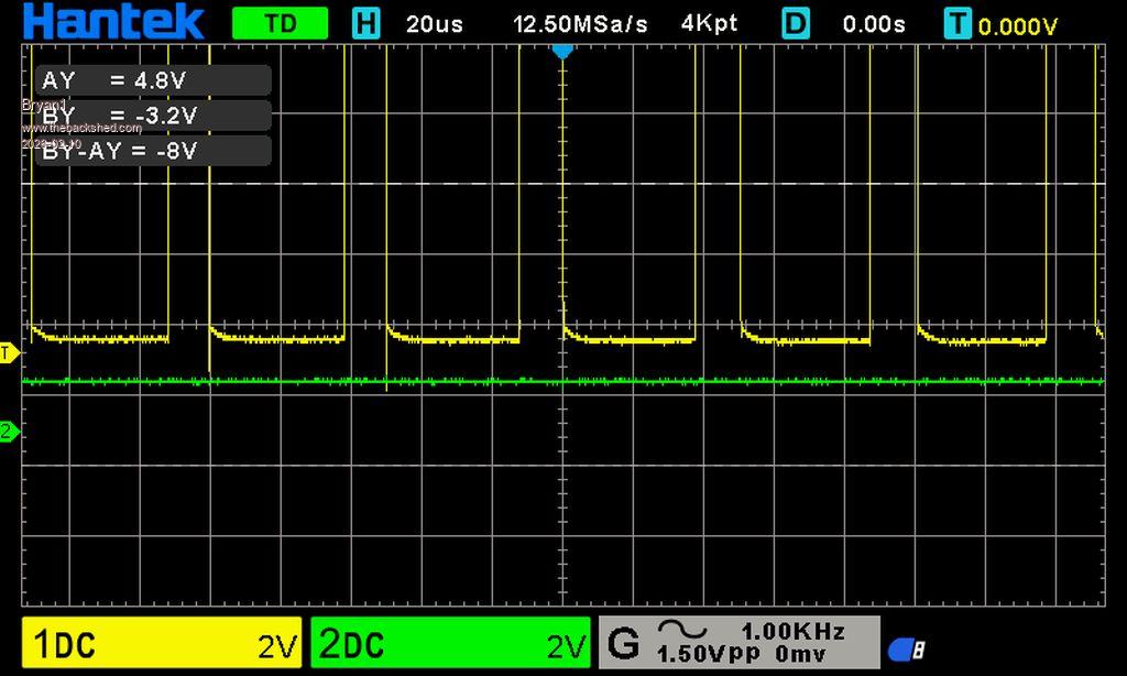

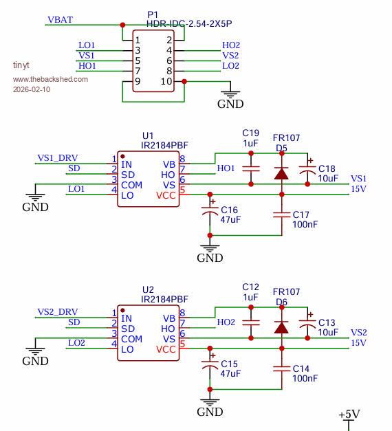

I am just going by files in my archive and the testing direction from the EGs002 document. Experts here, please review my instructions.
For stand alone testing, I think you temporarily connect VS1 and VS2 to GND. Scope Channel 1 and Channel 2 to DC, not AC.
First scope capture: probe 1 to LO1, probe 2 to LO2. Set scope H to capture 1 to 3 cycles of 50Hz.
Second scope capture: probe 1 to HO1, probe 2 to HO2. Set scope H to capture 1 to 3 cycles of 20KHz.
Edited 2026-02-10 12:49 by tinyt

  tinyt said  I am just going by files in my archive and the testing direction from the EGs002 document. Experts here, please review my instructions.
Looking again at the partial schematic, check that the orientation of the two diodes are correct on the PCB, also the electrolytic capacitors. Also U1 and U2 if they are socketed. Maybe there is no need for the scope captures.
Bryan1
Joined: 22/02/2006
Posts: 2297
Posted: 04:57am 10 Feb 2026
Ok got the first test done and found probe 1 L01 had a good wave form where probe 2 L02 was only in the millivolt range.
So changed over to the 2nd test and after connection the probes to the wires saw the VBat drop to 10 volts so I think we found the problem as both probe waveforms were flat. Now taking the ground off restored VBat.
So I'm goingto take out the brain board and have a good look as I do think that is where the problem is.
First probe test
Regards Bryan

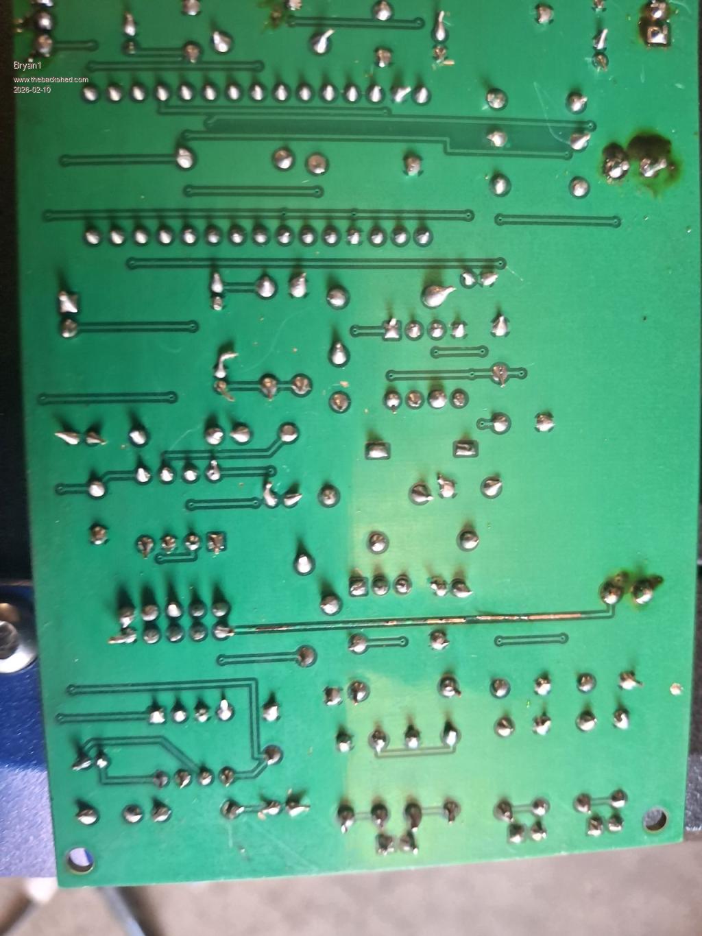

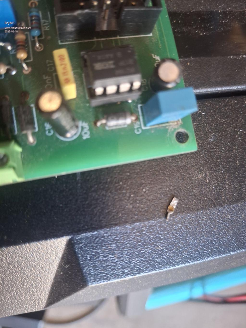

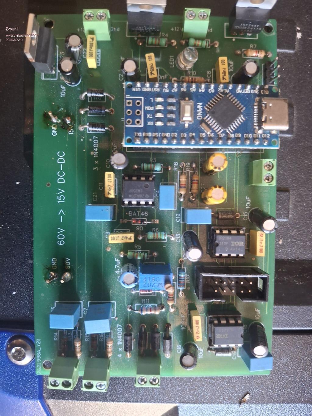

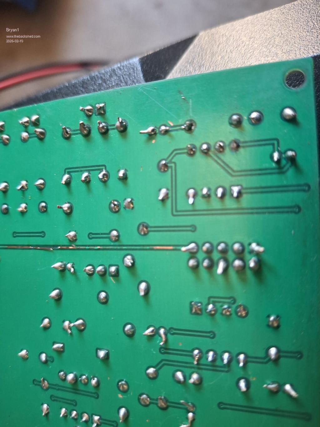

Joined: 22/02/2006
Posts: 2297
Posted: 05:25am 10 Feb 2026
Ok got the brain board out and had a look
Now the fast diode on the end of the board fourth solder joint in the top right
Now doing a diode test does show it isn't blown but that solder joint does need some attention.
Just had a look under the board and this was staring at me
So the 50 volt track has lifted and this is the real culprit that I was looking for all along so the raised track could of been touching another component which caused the short.
Edited 2026-02-10 15:40 by Bryan1
Posts: 3412
Posted: 05:34am 10 Feb 2026
The blown track in the middle of that pic. may need looking into as well!
You need to find what caused that.
Edit.
Looks like it goes from the cable socket toward the 50V pin.
Edited 2026-02-10 15:43 by phil99
Posts: 3412
Posted: 05:46am 10 Feb 2026
  Quote  the raised track could of been touching another component which caused the short.
