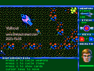

A bit of gameplay added.
- With "z" you can search for hidden items ("z" is defined by PETSCII), these are shown in comment section, not yet added to inventory, no animation of the closed boxes yet.
- game loop indicator in top right corner, showing the time needed to do all the game play (in msec.).
- the game loop is processed every 150ms (variable: h_beat) to get more consistent reaction time.
- some optimization in the algorithms.
Enjoy...
pet16.zip
P.S. for those who did not play the game on the MSDOS emulator yet: press "z" for search. Then the first arrow key press will determine the search direction (left/right/up/down). A magnifying glass with show where you are searching for items. The lander is a good place to start.
There is a technical challenge with the magnifying glass. You have the world map, on top of that the player, and the magnifying glass goes on top of that. Since there are not 3 layers, I alternate player and magnifying glass. This works, but is not very nice. We may need a player sprite with magnifying glass combined in one sprite.
Edited 2023-10-08 06:23 by Volhout

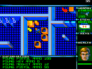

Posts: 6103
Posted: 10:40am 08 Oct 2023
Latest incarnation.
- found items are added to the inventory (press "i", "o" or "p" in this version.
- search opens boxes
- animation runs until player uses cursor cluster for search direction.
Next challenge is "move" mode....
pet17.zip

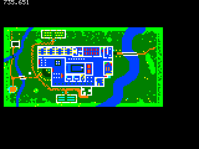

SUB Render Livemap
I've now found the right colors per Tile and optimised the sub from ~2 Seconds to 736 ms
(@CPUSPEED (KHz) 252000) to be merged to the Program  @Volhout
'test/Demo of the "renderLivemap" SUB

For f=0 To 5:LV$(f)=Input$(128,#1):Next
For f=0 To 63:LV$(f)=Input$(128,#1):Next
Close #1
MODE 2
'Call the Map Function
t=Timer
renderLiveMap
Print Timer -t
End
' Level LiveMap Preview
Sub renderLiveMap
 Local integer mx,my,mp,yy,CL(256)
 Local t$
 'Tile colors
    T$="00077777977770777770000A0000B0006740694B66EB60E777E722B724B66070"
 T$=T$+"0367000700770007770000700707077880000007776777077707770778888887"
 T$=T$+"7067700770000007700400000000000000000730073000000000000000000000"
 T$=T$+"0007700770898EEAAA233867772777677700A00AA0000000000000000000000"
 For mx=1 To 255:CL(mx)=col%(Val("&H"+Mid$(T$,mx,1))):Next
 For my = 0 To 64:mp=Peek(varaddr lv$(my)):yy=44+(my<<1)
   For mx = 1 To 128:Box 4+2*mx,yy,2,2,,CL(Peek(BYTE mp+mx)):Next
 Next
End Sub
colors:
'--Colorscheme accordung to Spritecolors
Data RGB(BLUE),RGB(GREEN),RGB(CYAN),RGB(RED)
Data RGB(MAGENTA),RGB(YELLOW),RGB(WHITE),RGB(MYRTLE)
Data RGB(COBALT) ,RGB(MIDGREEN),RGB(CERULEAN),RGB(RUST)
Data RGB(FUCHSIA),RGB(BROWN),RGB(LILAC)
Edit : now 649 ms

  Volhout said  Latest incarnation.
pet17.zip
