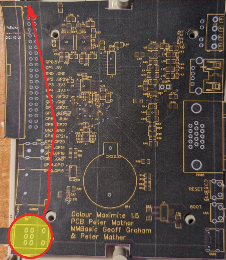

Posted: 06:35pm 07 Mar 2024
doesn't work because of the mounting holes
Posts: 5995
Posted: 06:57pm 07 Mar 2024
Maybe it fits...
You could put the audio connector in it's old place.
Alternative: change the 40 pin connector to something like 30 pin. The audio, video pins you would not route to the 40pin header anyway (like the non-USB board version 1.7).
Edited 2024-03-08 05:01 by Volhout
Posts: 11657
Posted: 07:27pm 07 Mar 2024
This seems like a good compromise. They haven't got stock of the pot/switch (RK0971224Z0H) so it doesn't show it but it is widely available. Also the RTC is showing out-of-stock again - they had 3000+ last time I looked.
Edited 2024-03-08 05:29 by matherp
Posts: 5995
Posted: 07:30pm 07 Mar 2024
Agree !!

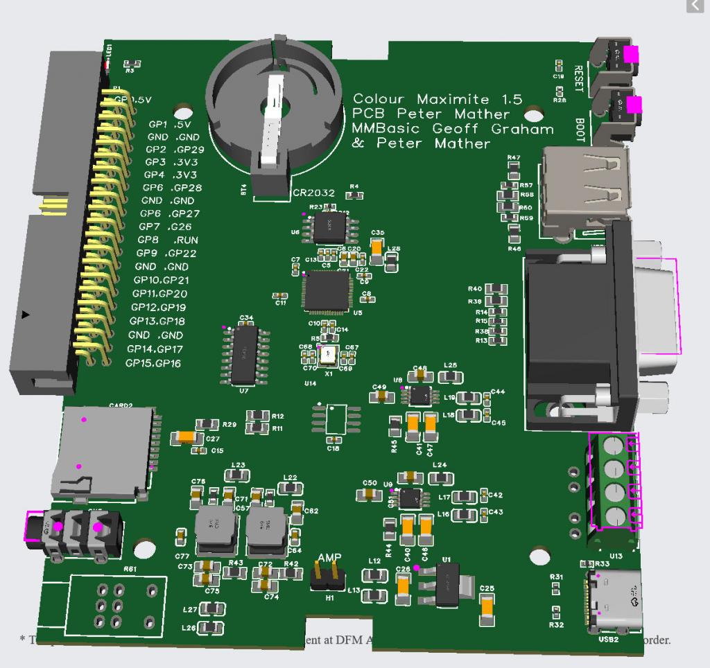

Posts: 5995
Posted: 08:34am 08 Mar 2024
Hi Peter,
This is a personal preference. When possible, dual footprint the LED with the previous (expensive) part.
The right angle SMT LED may be a nice solution for cost and automatic placement, but in a housing you may need a light-pipe embedded in the front panel to have an appealing ON LED.
A simple 3mm LED that can be mounted in 2 through-hole pads is far simpler (it combines LED and light pipe in one construction). For BigMik it is more work, so he will like the SMT part. I myslef would remove it and place a 3mm LED. And soldering a 3mm LED to the SMT pads is basically destroying the board.
Since you seem to have lots of board area next to the coin battery, maybe add a "ancient" LM7805, so you can power the board from 12V. That brings it in line with CMM1.
My personal view: The BOOT switch was internal in the CMM1 and CMM2 (except your latest G2V2). Normal users would not use it that often (one per year ?) except the guys that test al the beta's. Similar the RESET switch (I did not even install it on my boards, I just re-power or CPU RESTART). But others may have a different vision on this.
Posts: 11657
Posted: 08:56am 08 Mar 2024
LED holes - no issue
If I move the boot button internally then I can perhaps shrink the board to 100x90mm which would save a few pennies
Posts: 8968
Posted: 09:44am 08 Mar 2024
If the boot button is through-hole you could mount it on the bottom of the board as an option and access it through a hole in the bottom of the case if needed. The PCB mounting pillars are high enough to allow this. I like to put a little hole in the middle of the pads just for marking the hole position in the case.

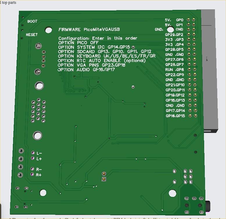

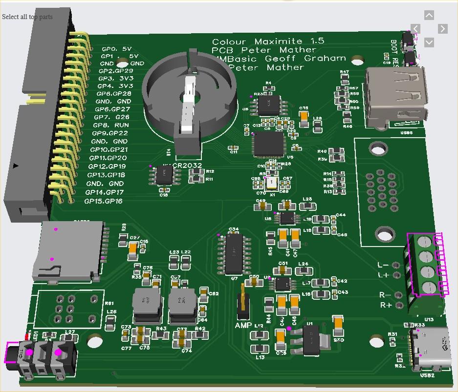

Posts: 11657
Posted: 12:53pm 13 Mar 2024
Here is the final routed version. I'll get a couple made and then release the gerbers and dxf for end-panels to fit the MULTICOMP MCRM2015S CASE
