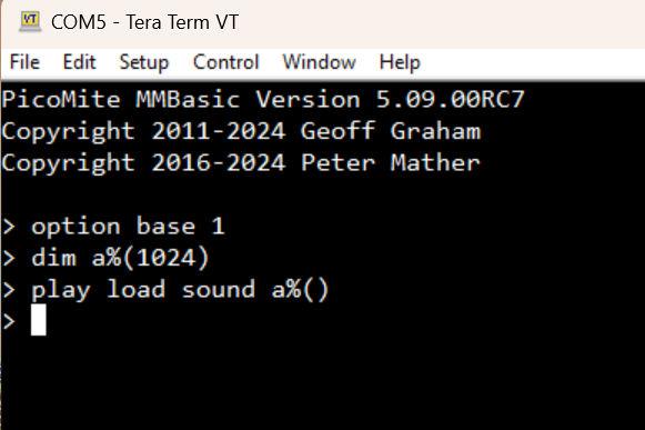

A very minor issue, when using
Option Base 1
Play LOAD SOUND WaveArray()
gives
Error : Array size
Easily fixed by converting to Base 0 but Base 1 allowed an array index value to equal the harmonic numbers in the tone and simplified the wave generation function a little.
eg fundamental had array index 1, 2nd harmonic had array index 2 etc.

  Quote  A very minor issue, when using
Option Base 1
Can't replicate
Posts: 3376
Posted: 08:15am 27 Jul 2024
Ok, that has me stumped. At the command line I can't enter Option Base 1 so I put your lines in a program and it does not produce an error. Yet my program wouldn't run with Base 1
Later I will load RC7, convert it back to Base 1 and try again.
PicoMiteVGA MMBasic Version 5.09.00RC5
Copyright 2011-2024 Geoff Graham
Copyright 2016-2024 Peter Mather
> option base 1
Error : Must be before DIM or LOCAL
Thanks for testing it.

Posts: 3376
Posted: 01:13pm 27 Jul 2024
Re Option Base 1, couldn't find RC7 so loaded latest version of RC5 and it works.
Found another odd thing, Play STOP is quite temperamental.
When sounds are loaded, played and stopped in a loop (in a program) eventually Play STOP causes an error.
[25] Play STOP
Error : Invalid character: 0
Also at the command line characters after it or a space before it cause an error.
> Play LOAD SOUND PLS02() : Play SOUND 3, B, U, 440, 25
> Play STOP 'error if anything after it, or a space before it
Error : Unknown command
>  Play STOP
Edit.
Only happens with a loaded sound, pre defined Q, W, S & T all ok.
Edited 2024-07-27 23:23 by phil99
Footnote added 2024-07-28 08:30 by phil99
The error does not occur if the loaded array is empty.
Footnote added 2024-07-28 09:08 by phil99
Filling the array directly also does not result in an error.
for n=0 to 1023 : a%(n)=n*16 : next
is ok
There must be something wrong with my program, but can't see what.

Here we are, back in Venice with more ... Play LOAD SOUND.
What am I doing wrong?
> LIST
' Print "Test for PLAY LOAD SOUND v00.bas"
Option base 0
Dim a%(1023), b%(4095), n%
For n% = 0 To 4095
 b%(n%) = n%
Next
Memory PACK b%(), a%(), 4096, 16
 Play LOAD SOUND a%()
 Play SOUND 1, B, U, 440, 25
 Print "a%() now playing"
 Pause 500
 Play STOP
 Pause 200
End
> RUN
a%() now playing
a%() now playing
a%() now playing
a%() now playing
[16] Play STOP
Posts: 11830
Posted: 01:11pm 28 Jul 2024
Try this
PicoMite.zip
Posts: 3376
Posted: 09:56pm 28 Jul 2024
Thank you, that is perfect!
