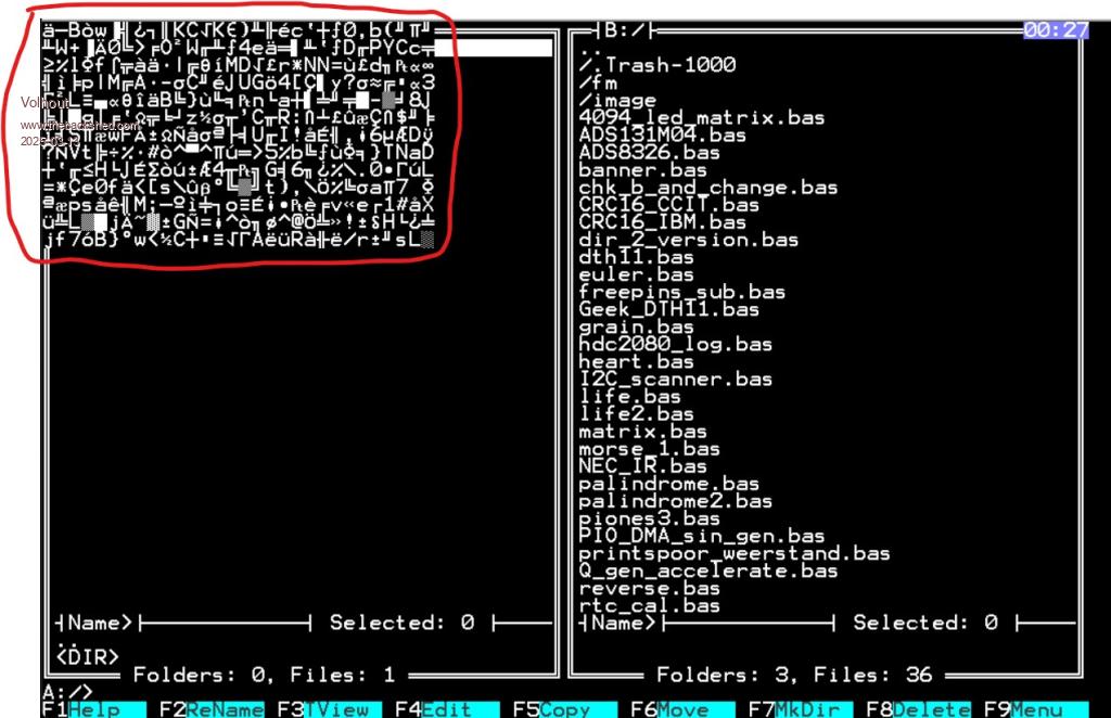

Michael,
The screensaver size is not related to update rate.
Even when slowed down, it still only manages 32x16 area.
This is caused by incorrect MM.HRES and MM.VRES, since there is no display.
But we have set terminal windows as 80x40 with OPTION DISPLAY 40,81
This has a working screen saver...
But since it has no fading, it is not as nice...

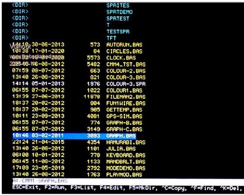

CMM2 filemanager
Teraterm is perfect since it has the Terminal (MS-DOS) font. Putty however should also work. The default Ubuntu build Putty does not have the Terminal font, but works acceptable. Only the frame (graphics characters) are not supported. The frame consists of blocks. Maybe the Terminal font can be added to Linux. But it may be copyrighted Microsoft (not open source).

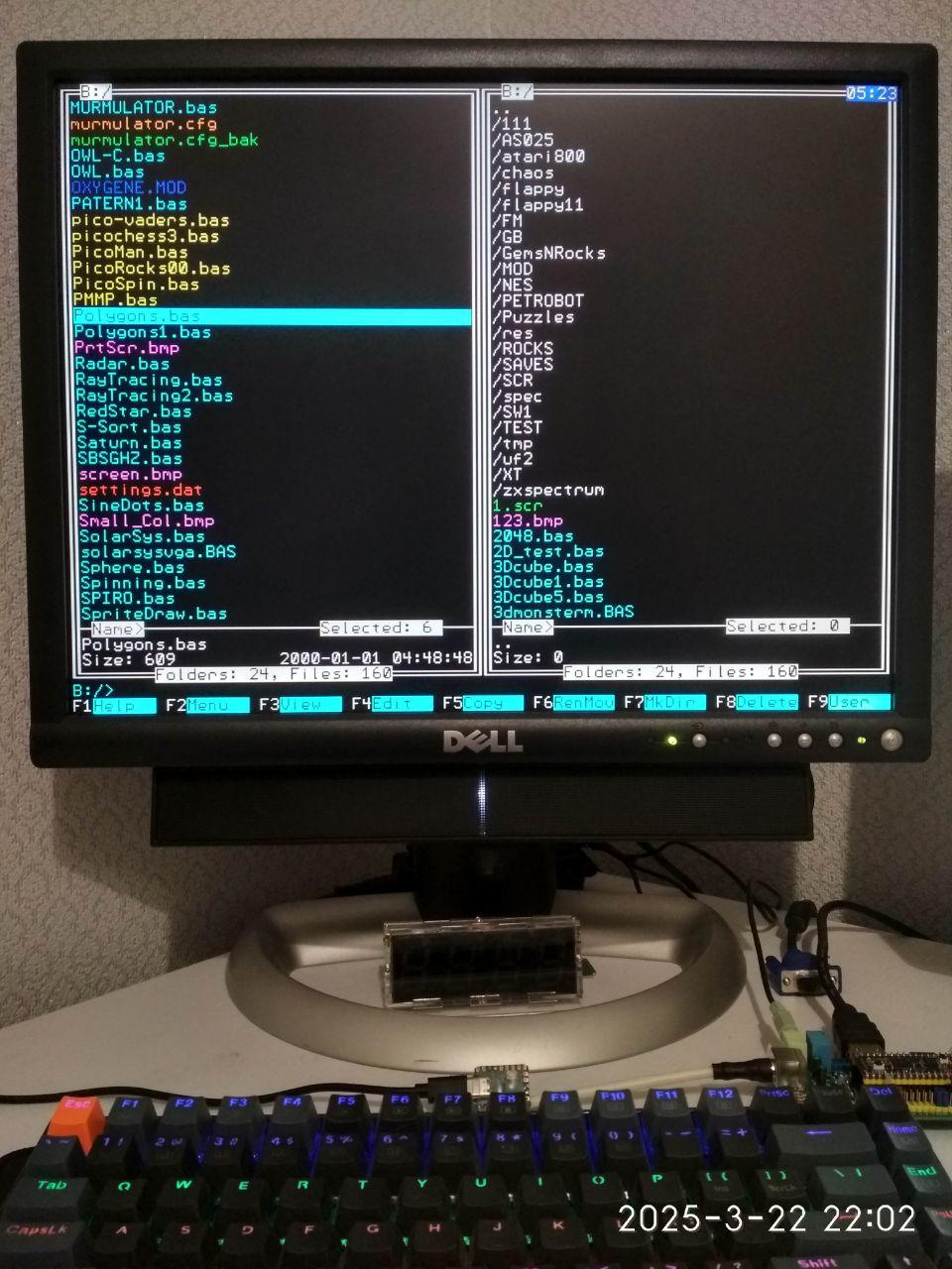

this is a current file from my test version of your file manager to provide the same functionality as in the last VT100 version (02030). The file manager now also displays the total file sizes of the selected files. The performance is sufficient for approximately 200 files. The file size function isn't very fast.
The version number is adjusted to the VT100 version (02030) to reflect the same development status.
FM02032.zip
New:
This update displays line numbers in the TxtViewer (F3). Useful for "Cutter" and "Merge".
I've also integrated a "Cutter" module. This makes it possible to cut out specific sections from text files so that they can then be inserted into a program using the merge tool, for example.
I've also fixed a few bugs and tidied things up a bit.

  twofingers said  I hope you're well.
Hi Michael & All,
Thank you for your attention and development of the File Manager version for VT-100. Very impressive!
Today I did a little programming, made file coloring and multi-select, for now it only marks files.))
FM140.zip
Need advice on coloring files, assigning buttons, etc.
Of course, I can't keep up with you, I'll dig into this further as much as possible... I'll be looking at your code.
