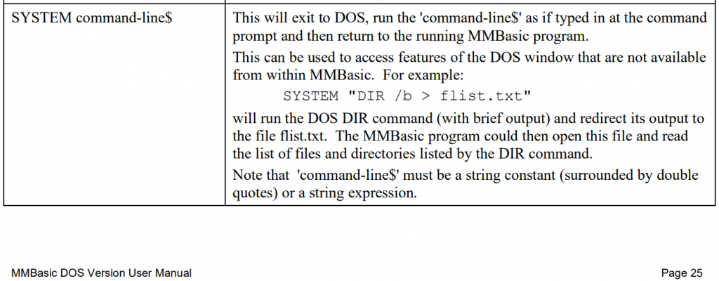

Good day! @matherp
I saw here that MMBasic DOS/WIN has a SYSTEM command for performing DOS functions that are not available from MMBasic.
I would like to have the same command for PicoMite MMBasic.
Yes, I know that PicoMite does not have a system, but it has a console shell, and maybe someday, some RTOS will appear.
In my humble opinion, such a command should already be present in MMBasic for PicoMite.
SYSTEM command-line$
This will exit to Shell, run the 'command-line$' as if typed in at the command
prompt and then return to the loading MMBasic program.
This can be used to access features of the Commamd prompt Shell that are not available
from within MMBasic.
For example:
Option ESCAPE
SYSTEM "Files \q*.TXT\q,size"
Or perform the system setup OPTIONS offered to the user from the program.
Best regards, javavi
Edited 2024-12-14 19:22 by javavi
Posts: 8966
Posted: 09:39am 14 Dec 2024
Hehe... I think if you want to do this you are going to have to write an OS for the Pico and a version of MMBasic to run on that.  ;) You can't shell out to nothing.
