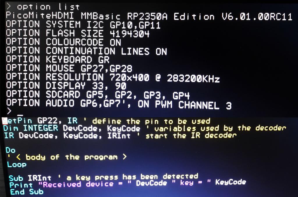

Hi Peter,
I have possibly found a bug.
IR doesn't work anymore.
Observation: If I press on my (working two) remote controlls, the code is recognized, but only one single time, other key presses aren't. If I do a power off on the picoMiteHDMI, then the whole process repeats: only one single time the remote code is recognized, I have to reboot again. There isn't an error or so, but as said it only works for exactly one single time. On previous versions (but I don't know in which this "bug" (?) is introduced) everything worked.
P.S.: I just tested a (previously working) second picoMiteHDMI, but with the USB firmware, exactly the same behavior! Ir receive just works for one single time.
Greetings
Daniel
Edited 2025-11-13 00:26 by Amnesie
