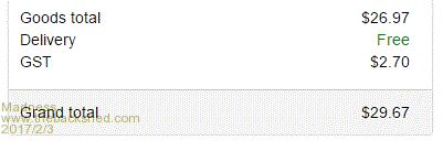

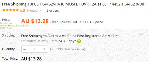

Posted: 11:05am 03 Feb 2017
  Grogster said
The TC4452's are about US$2 a pop from Microchip Direct
MOQ of 5pcs though, so that us US$10, which works out as AUD$13
Thanks for that link Grogster, if I ordered 8 today they say they would arrive on Thursday so only 4 days with those coming from Thailand. Price is as per below
However RS are a little more expensive but have free delivery, if they had 9 (lots of 3) in stock it would arrive the next day but the still would have them here in 5 days.
Then there is Aliexpress, but you need a lot more patients.

Posted: 02:27am 05 Feb 2017
Yes, those TC4452 chips certainly look a lot simpler to implement than the totem pole drivers you mentioned in an earlier post. I was looking at those totem pole drivers too but fortunately the subject of compact high powered Mosfets came up here just in time to drop that idea.
