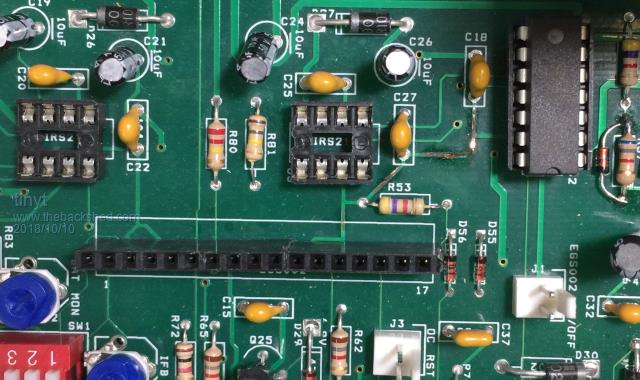

Ha tinyt, Mr Murphy has signed the exclusive club membership form for you already, he's just waiting to hand it over at the appropriate time .
Ok, power switch not on your PCB, did not see that on first picture. Anyway, can I suggest you monitor the capacitor voltage instead of the 5v rail for your switch on signal? Reason, the 5V rail is established long before the caps are fully charged - at least on my set up.

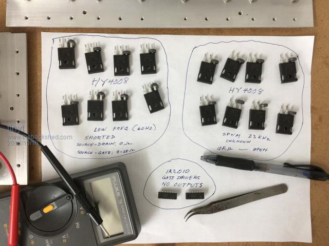

Post Mortem:
Burnt trace.
Damaged components.
Will be replacing the drivers and all mosfets. Then maybe more troubleshooting.
This is due to my carelessness. The mosfets died silently, no spectacular fireworks. So, I think I still don't qualify to join the club. Edited by tinyt 2018-10-11

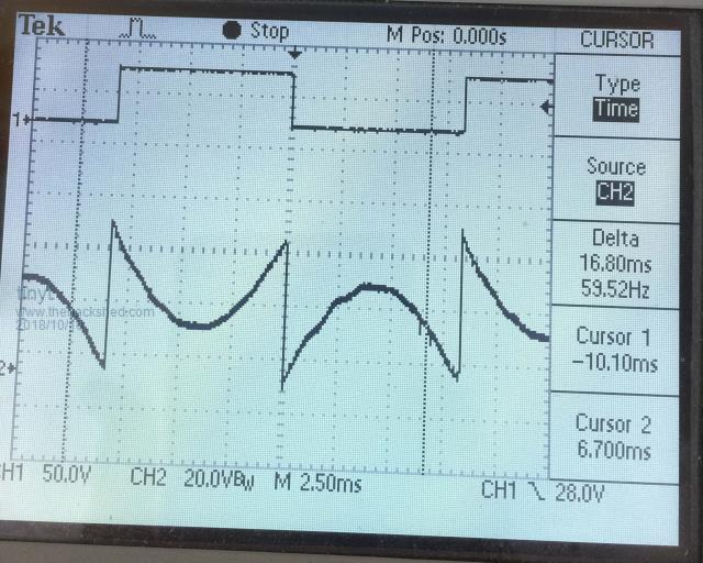

I installed new driver chips and new mosfets. This time only one mosfet per bridge leg (total of 4). Powered it up un-loaded and here is the waveform across the 12vac winding. It looks much better.

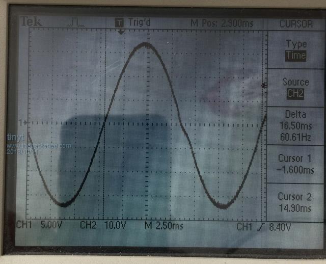

Here is the waveform across the toroid primary.
Looks like the ugly waveform distortion went away.Edited by tinyt 2018-10-11
Madness
Joined: 08/10/2011
Posts: 2498
Posted: 05:50am 10 Oct 2018
Yes that is much better, before it would have sounded pretty horrible in the Toroid also.

  tinyt said
With 60000 uF bulk capacitors, the RC time constant is 0.48 second and they will be charged fully in 0.76 second. So if I wait about one second before turning on the breaker, I think I should be good
That statement doesn't look quite right, I believe the capacitor is fully charged after 5 time constants - after 1 second I think it would only be around 80% charged. A 2 second pause would be much better ?
The waveform is certainly improved, but it is not totally symmetrical, each rising/falling edge does not start and finish at the same DC level. Not sure if that is cause for concern - does this look normal to others who have scoped theirs ?

Posted: 01:04pm 10 Oct 2018
No, the output from my EG8010 is perfectly symmetrical, even on the cheap kit digital oscilloscope.

wiseguy
Joined: 21/06/2018
Posts: 1327
Posted: 02:16pm 10 Oct 2018
Before you go crazy looking, I interpreted your post that you are scoping across the primary winding on the toroid ? Tinkers quote, I think he is scoping at the EG8010 output - these are not exactly apples for apples. I am not familiar enough yet with the actual waveform shape, scoping the toroid primary to say the waveform is ok or not, gut feeling says its not but I don't want to lead you on a goose chase either.
Just ensure that you dont have AC coupling for the CRO channel you are using - that could also cause a distortion.

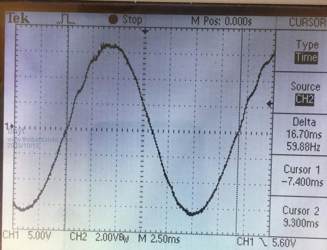

Here is the latest waveform with 1.2kw load. Not perfect but good enough for me.
And the numbers:
No load power input (54Vdc x 0.31A) = 16.74 watts
1.2kw stove heating element load power input (54Vdc x 24.78A) = 1338 watts
1.2kw stove heating element load power output (231Vac x 5.34A) = 1233.5 watts
Power Loss (1338 - 1233.5) = 104.5 watts
Efficiency (1233.5/1338) = 0.92 or 92%
On to more testing.Edited by tinyt 2018-10-12
Posted: 10:35pm 10 Oct 2018
The grid waveform can look pretty horrible, and everything runs just fine off that.
Both the no load input power and efficiency are excellent, something to be very proud of. Not too many high dollar commercial inverters could come anywhere near that.

With 92% efficiency you are very close to what others have achieved. The waveform looks near enough to perfect, I would be keeping a close eye on your MOSFET temperatures with the heat sinks you are trailing.

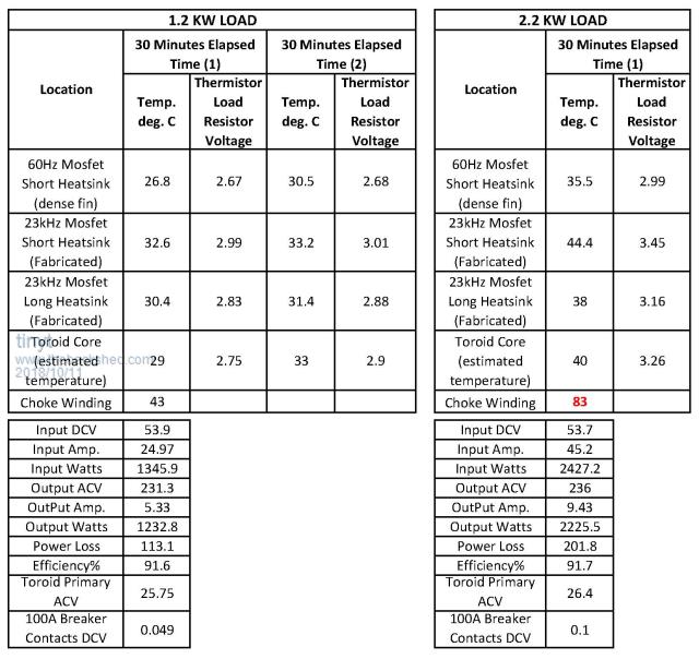

Posted: 03:38am 11 Oct 2018
Some Load testing data: temperature readings, etc. I was able to do up to 1 hour with the 1.2kw load. But for 2.2 kw, I stopped after 30 minutes as the choke winding temperature rose too high for me. I was afraid that its winding epoxy will soften.
I used a thermocouple probe that came with the clamp meter I was using.
I don't know why at 2.2kw, the output voltage rose to 236 vac from 231 vac at 1.2kw.
At 1.2kw load, the choke hums. At 2.2kw load, the choke growls and heats up.
I have to make a new choke with bigger wire cross-section. Maybe efficiency will slightly improve.
I have two 2.2kw stove heating elements so with a better choke, I should be able test with higher loads of 3.4kw and maybe 4.4kw.
Posted: 07:08am 11 Oct 2018
What is your ambient room temperature, and is there a fan ?
