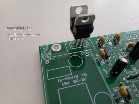

Ben was asking what fet to use for Q7& Q8
I used some of these just because I already had them.
Basically you just need a N channel fet in to220 to fit in the hole.
Ben is there an electronics shop nearby that you can go to and buy small quantities of parts?
They don't need to be powerful they are just for switching the fans on and off.
Might have something suitable in your junk box??

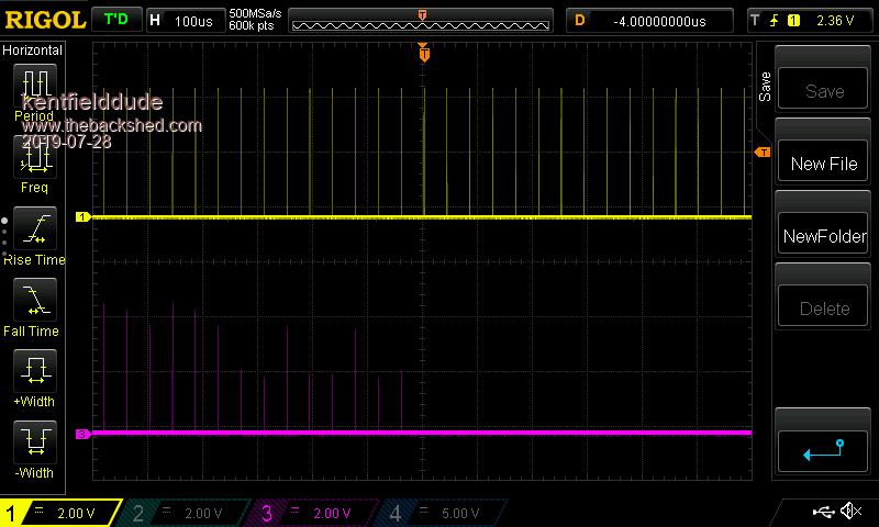

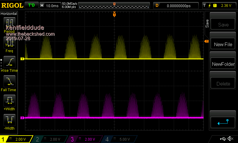

This is the output of pin 9 and 10 of nano 1 connected to my scope. The nano is not in the nanoinverter pcb. Do these waveform look right. I am a beginner scope user so I might be doing something wrong.
poida
Joined: 02/02/2017
Posts: 1497
Posted: 05:26am 28 Jul 2019
These look correct.
At all times when powered, nano1 produces very low duty cycle PWM output
on those pins.
It's not a problem to my mind since the gate drive IC outputs are disabled
unless nano1 is commanded to run the inverter.

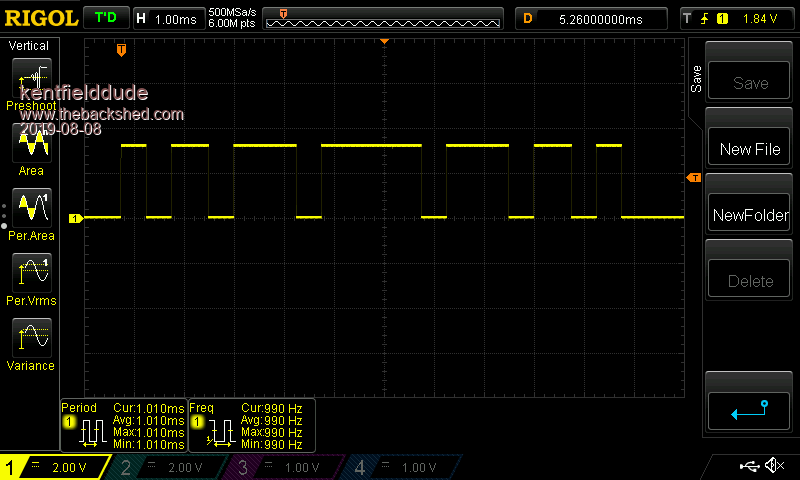

SPWM on the esp32

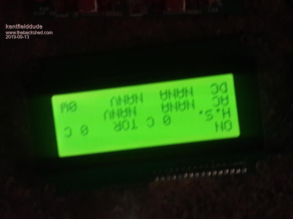

The display doesnt look right when I start it up. Might be a wrapping issue. I dont have anything plugged into the board
poida
Joined: 02/02/2017
Posts: 1497
Posted: 06:25am 13 Sep 2019
K:
it's all OK.
This is the correct display when no values are making any sense.
To get a sensible AC volts, you need to give the ADC channel something to convert
and then you use the serial terminal to define a calibration.
Same for DC volts, DC Amps and all the rest.
Try putting a 10K pot on the ntc inputs and see what happens.

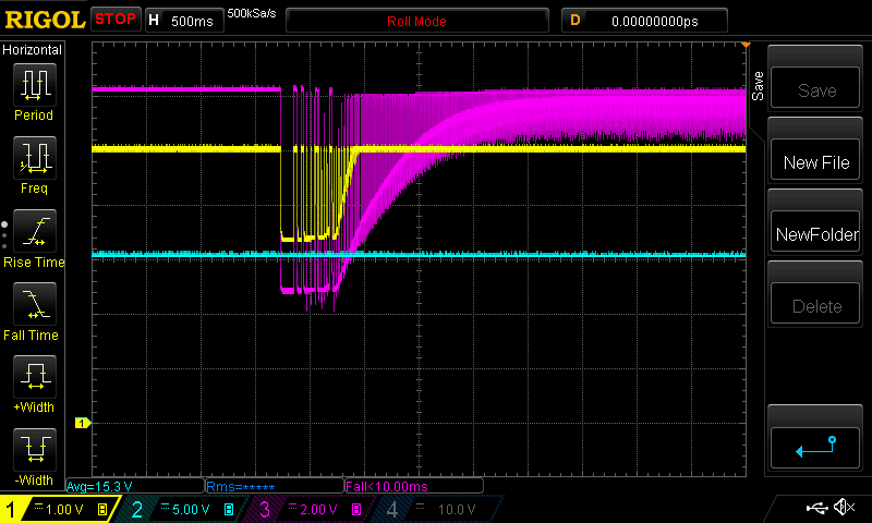

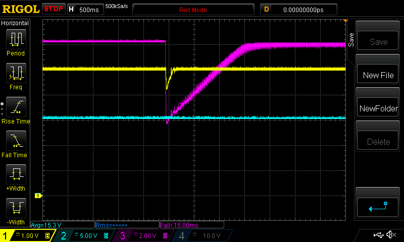

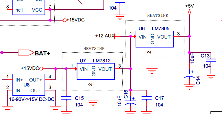

When verifying correct operation of yet another nanoverter, I found a problem.
It is centered around the 12V supply for the fans.
Both the house inverter and the new one I am building use 2 x 12V 0.4A fans.
The nanoverter 12V supply uses a 7812 regulator, taking Vin from the 15V supply.
This 12V reg output is used for the 2 fans and also is Vin for the 7805 that supplies all the control and sensors.
It's all working fine when no fans are switched on.
The rev.D design (all designs actually) have 10uF and 104 caps on their outputs.
Here is what happens when one fan is switched on.
Yellow is 5V output from 7805 1V/div
Light Blue is 15V supply 5V/div
Pink is 12V output from 7812, 2V/div
This is not good.

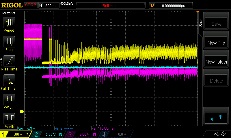

Here is when I switch on the other fan (2 different types, both 0.4A)
Not good either.
Both times we can see the 5V supply drop to about 3.4V, and for over 1/2 a second.
I think the nano microcontrollers are unlikely to give expected results during these situations.
In the event of high inverter loads, both fans might be required to be on at the same time.
Here is what happens:
This is hopeless.
Surely the inverter would just throw it's hands in the air and shout (with sparks and smoke) "I give up"?

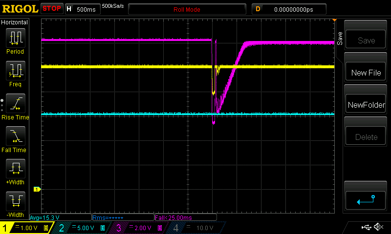

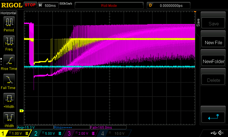

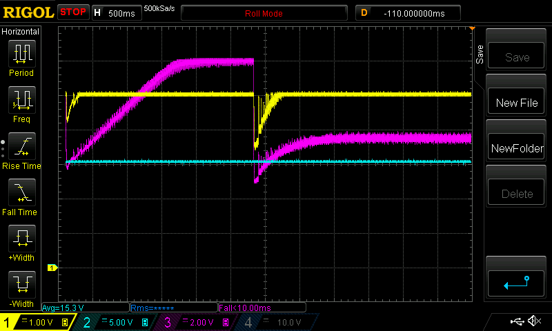

I replaced C16, the 7812 output 10uF with a 470uF.
Things look better .
Fan #1:
Fan #2:
Both:
I think the 7812 can not deliver enough current for the two 0.4A fans.
I had a good sized heatsink on the 7812 for these tests.
And what's worse is the 5V supply is adversely effected by taking it's input from
the poorly regulated output of the 7812.
At all times, the 15V supply remained stable so at least that is working well.
It's time to make some changes to the board:
1 - tonight I will cut the Vin pin track on the 7805, and connect it to 15V.
This will make for a hotter running 7805 but a heatsink will be the fix.
Replace the 10uf with 470uF
I need to do this on the home inverter immediately.
2 - replace the 7812 with a zener diode/TIP35 combo that can provide 0.8A with ease.
Until then, limit the home inverter loads to such that only one fan will ever need to run. OR get some separate 12V supply and hack that into the box.
or
cut the 12V track that powers the fans and use a separate supply for this.
It will remove the large loads on 12V and let the board supply 5V without dropouts.

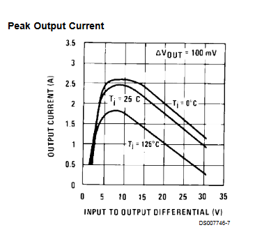

The 7812 was bought from Jaycar .
Their specs say 1 Amp. Dropout voltage is 2V at 1A output and 25C die temp.
It seems to me that supplying the 7812 with 15V and expecting 1A out is pushing things a bit:
We are operating at the very steep part of this curve - near where the dropout voltage is.
The 7812 has internal overload protection and internal over heating protection.
Even with a good heatsink and the regulator at room temperature, the 7812 reduces output with the 0.8A load. when driving 0.8A the output droops slowly, due to the increasing internal die temperature.
Edited 2019-10-22 09:19 by poida

Hmmmm, my nano control board has been running the house since mid March.
House is off grid and entirely dependant on that.
Both fans have run many times, I'll often walk past and can hear them both going.
So yeah fix it, but I wouldn't panic.

Sounds a bit redneck style, but could you just stick 2x 7812's in the board?
I just checked, the holes fit 2 of them in there.

Um... why not just run the fans from the 15v supply with a diode or 2 in series per fan.. don't use the 12v at all... 2 4007s with .4 amp through them will barely get warm, and can still supply mosfet control as same ground.. in fact ive run plenty of " 12v computer fans " from 15v let alone 13.6v... and easy to " hide " the diodes under some heatshink..

  noneyabussiness said  Um... why not just run the fans from the 15v supply with a diode or 2 in series per fan.. don't use the 12v at all... 2 4007s with .4 amp through them will barely get warm, and can still supply mosfet control as same ground.. in fact ive run plenty of " 12v computer fans " from 15v let alone 13.6v... and easy to " hide " the diodes under some heatshink..
This is sort of what I am thinking will be the way to go.
But for now, I have made the 5V supply independent of the 12V output.
Acheivement #1 unlocked.
And added the big cap to help the fans start up and run on the 12V output.
The house inverter is safe now to run a fan. how about that?
