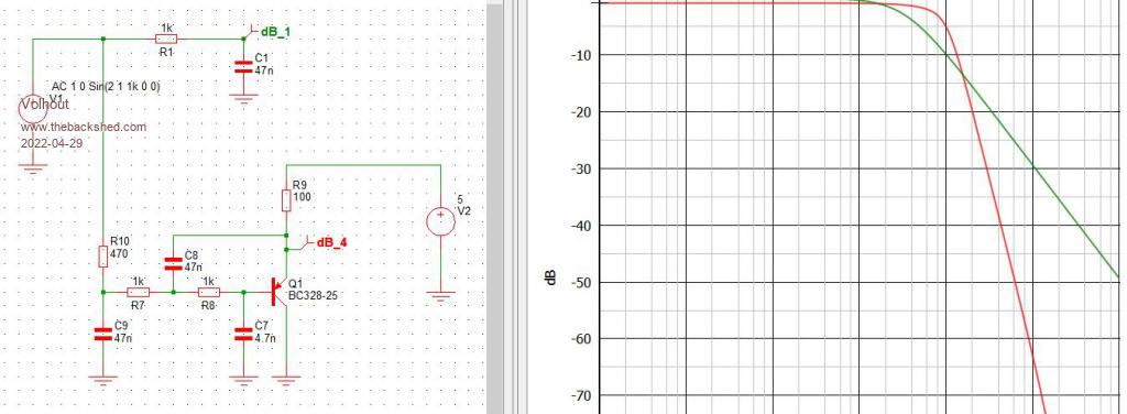

Regarding audio quality on this PCB - basically, providing it makes a noise and isn't too objectionable when you are 18ins away from cheap desktop speakers then it's probably fine. :) It's nice if it's fairly quiet noise-wise - especially in headphones.
I've tried:
The "standard" filter with linear regulator.
Low level output was good. Headphones were good but a bit quiet via the filter. Using just resistors they were better and I'd say acceptable with 470R.
The "standard" filter with SMPS.
Low level not bad, but some hash. Not too horrible with headphones via the filter. Headphones with resistors too noisy. Had to increase values and still poor.
Volhout's filter with linear regulator.
Low level output good. Headphones quieter via the filter, but quality nice. Headphones via resistors were louder than expected (I suspect the filter places less load on the pin, resulting in more headphone drive).
Volhout's filter with SMPS.
Low level output good - about the same as linear regulator. Headphones louder and noisier - no good.
Volhout's emitter follower.
Disaster. Plenty of volume, but very noisy. It gives a much better impedance match but that allows any digital noise to also be amplified. It was especially poor with the SMPS, which is probably putting all sorts of rubbish on all the supply lines. I decided that it simply wasn't needed as an I/O pin and a resistor is near enough - and uses a lot less board space.
Conclusion.
I like the emitter follower concept as it gives better control over the headphones. Unfortunately it would definitely need a potentiometer volume control and there isn't space. A series resistor doesn't help the bass response, but 470R-680R isn't too bad and, with the right source material, can sound pretty good. Low level output seems to be fine, no matter which filter is used (I didn't test it properly though, I admit. I haven't got an amplifier and speakers in this room). It seems better with a linear regulator, which is why I recommend one.
Posts: 5998
Posted: 07:19am 29 Apr 2022

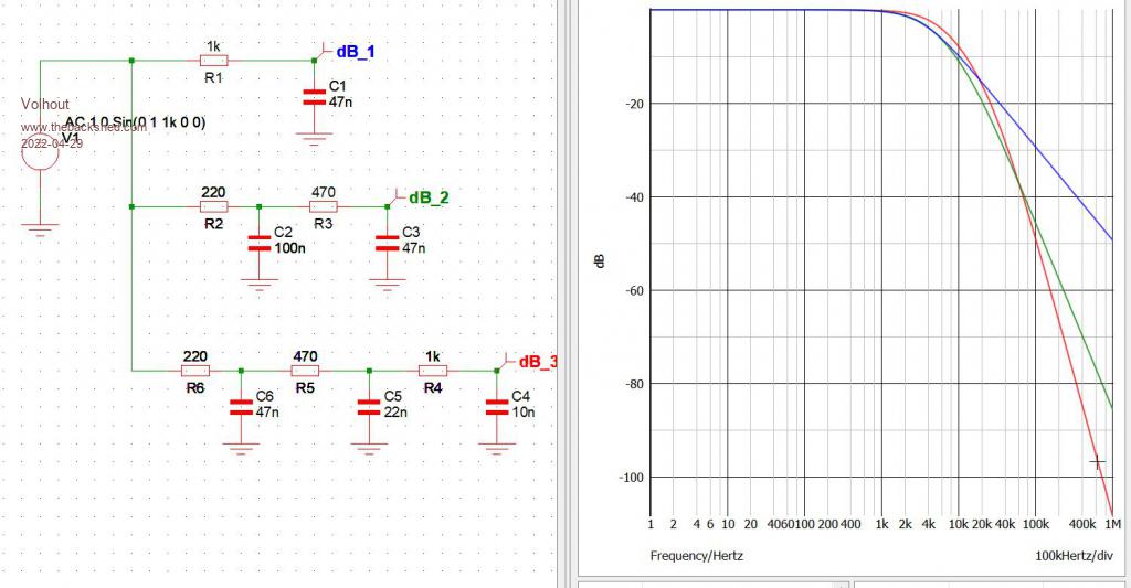

Hi Mick,
Yeah, there is a lot to experiment. And the switchmode PSU is far from ideal.
Reason I am investigating this (previous suggestions like the emitter follower where designed around the DAC in the Armmite F4 and CMM2). This (with 44.1kHz base frequency in the PWM) is a total different beast.
If you do nothing about the 44.1kHz, your amplifier (tweeters) will be driven peak-peak with 44.1kHz. And it is depending on the filters inside the audio amplifier how much of it is attenuated. Also headphones... and your cat will stay away from you when you use these on picomite. Cats heat the 44kHz (I don't). And to them the 44.1kHz is louder than anything in we hear.
The 1k/47nf filter will attenuate the 44kHz with roughly 20dB (10 times attenuation), but the audio spectrum starts to roll off at 1kHz. 10kHz is -10dB (blue line)
This may be useable. But with some more passive components you can achieve better (green, red line).
Just playing.
My goal would be to get the 44.1kHz at 1%, and a spectrum up to 8 or 10kHz -3dB.
That would give a very good audio quality if you would feed it music from the SD card. And it would be in some way compatible with the 11 bits that we have in customer satisfaction. It won't get to CD quality anyway, but I like to get it close.
Similar I will look at the VGA sync signals. These at directly driven into the VGA cable. Technically that is possible (proven) but some impedance matchin (serial resistor) may lower the ringing that is bleeding into the audio circuits.

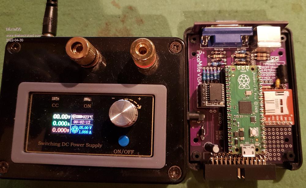

I have very little bench space most of the time, so I came up with a creative idea. I use one of these modules in a plastic box, with a barrel jack on the back and terminals on the top. I can then plug in a laptop power supply (which can stay on the floor) and get a variable voltage, variable current output with a power switch. I need my glasses on to set it (the text is small) and it's a bit clunky to use, but it's cheap and it works well.

  Mixtel90 said  I have very little bench space most of the time, so I came up with a creative idea ...
Neat. I have a cheap Duratool single-output linear bench supply (D03233). The LCD diplay on the one buck-boost supply I have failed almost immediately, but otherwise it seemed to work the last time I tried it.

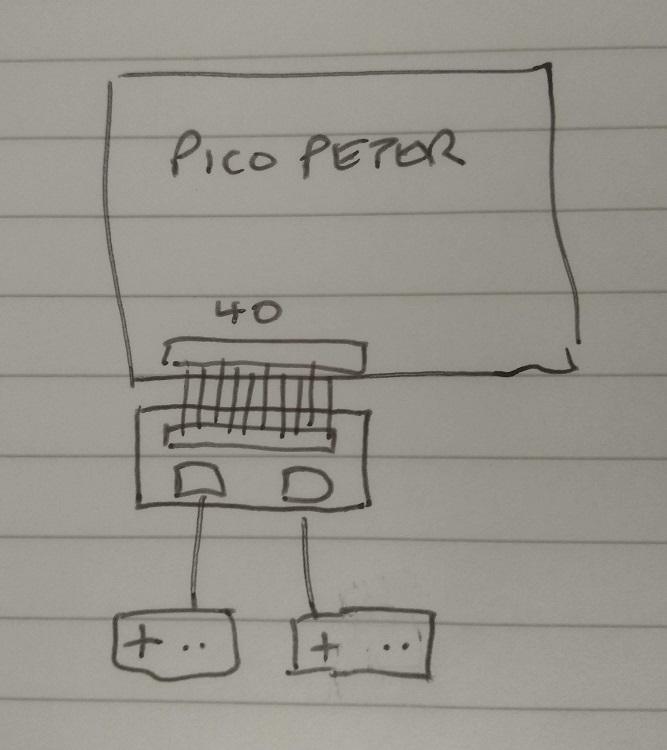

I'm not sure that I will get any of your VGA game boards but would you consider a game daughter board for Peter's VGA board that would provide the facilities that yours provides that are missing from that board?
I'm thinking of a board that would end parallel with the back of the mother board (or the front) so the sockets could fit in a back or front panel. It could plug half into one of the Pico sockets and half in the other for stability if needed.

I assume Bill was asking for you to design a PCB with a 40 pin female(?) header that would plugin to the 40 pin male(?) header on the front of Peter's board with/out cable and provide the two 9-pin controller ports (and audio? RTC?) wired appropriately so that any game/program that targeted the PicoGAME could also be used with controllers on the PicoPETER - basically a "dumb" joystick/controller interface board.
I guess it depends on whether there are any incompatibilities with pins that Peter has already assigned to duty.

The PicoPETER has a standard spaced 2x20 header at the "front" that breaks out all the pins of the Pico. It looks like it's intended to take a right-angle male header.
What you want is a small board with a corresponding right-angle female header (probably overhanging from the PCB as far as is mechanically possible so it can be attached without needing a cable) and a couple of male DB9s (plus any other gilding you might decide to squeeze in).
Obviously you'd need one of Peter's boards for trial purposes and if the design can't be pin compatible (there may be some leeway to handle minor incompatibility in software) then the idea is a bit of a wash.
Not to scale

Bill is asking for a "piggy back" pcb that sits inside the case, over the top of Peter's pcb, and stacks on top of the 40-pin sockets in that board (it has 3, one for the Pico and two for expansion boards). The port connectors would be flush with a panel so that joysticks could be plugged in from outside the case. I think that's the idea. For it to work I need to know exactly where those 40-pin connectors are on Peter's board relative to the board edges.
Plugging into the 2x20 header is a completely different thing. It might work, but it would probably be rather flimsy. As much a kludge as Sinclair's Interface 2, in fact. lol
