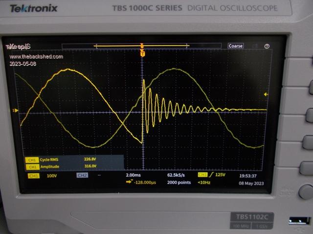

Posted: 08:43am 08 May 2023
A question for Mike [wiseguy].
I have your Solenoid control system working, I found your Nucleo Auto startup interface wiring, it applies to the 8010 as well, and that confirmed my rough drawing of how it should work.
So I set up a test layout with this on the bench to see how it powered the inverter on / off, I was looking for any glitches etc.
Before I did this I cut the ground pin off of the SSI jumper block, we discussed the SSI the other day. I can now see how this can be used to control SPWMEN via on/off.
The Inverter powers up correctly, but will not turn off the Solenoid when the On/Off switch is moved to OFF.
A: The Low V LED lights when switched to the off position which is correct, but it appears the VFB signal might be holding the Solenoid ON.
B: On, Off functions correctly if the Power unit is inhibited, and the only signal difference is VFB driving Q8 to latch the Solenoid.
If I remove the SSI link, it turns off correctly when SPWMEN is pulled low via R30 when Q6 is switched off. And it powers up correctly with Soft start. I like this scheme if this is the expected behavior.
I do notice a slight decaying ring on the DSO across the AC output as the inverter is powered off. About 10 cycles rapidly decaying and I guess under under 50Vac, looks to be around 400hz, but hard to tell at this stage, it does not seem to be an issue at all in the inverter at this stage. Likely normal as energy is released.
The first difference I notice with this signaling scheme when HUM / Growl was introduced in the standard Inverter, it is now a Buzz much higher in frequency, likely 100Hz but sounds higher, must look when I get a chance.
Really like how this is preforming so far. Hope above makes sense, understand if you are busy, this can all wait as it appears to be doing exactly what it was meant to do.
EDIT: Managed to get this at power off, looks like decay as SPWMEM is cut dead.
FYI: I have tried every combination of power removal, interruption, over current, over temp, low voltage etc and I can not fault it.
Edited 2023-05-08 19:45 by KeepIS

Hi Mike, just got back from a night out so might not make a heap of sense. The SS1 link should not be installed for normal operation. After the run switch is set to on, Vcap and Vlow Leds will go out and then spwmen is activated via Q6 & ramp up begins.
When the switch is set to stop the low voltage is activated via Q7 and Spwmen is set low, but the solenoid is still driven during the ramp down phase. When VFB has fallen to a low voltage - less than 0.6V and after a short delay, U3b & Q8 which were holding the solenoid on now turns off Q7 and allows the solenoid to open and then full galvanic isolation resumes.
Let me know if this makes sense.
That power off decaying oscillation picture looks suspect - never seen anything like that before and it happened at normal running amplitude ? Why did it not decay to almost nothing before it turned off.  The rampup when switched on and then rampdown after switch off really should work flawlessly, it should not be possible to stop it mid cycle like that ?
Cheers Mike

  wiseguy said  Hi Mike, just got back from a night out so might not make a heap of sense. The SS1 link should not be installed for normal operation. After the run switch is set to on, Vcap and Vlow Leds will go out and then spwmen is activated via Q6 & ramp up begins.
I'm running SS1 without a link.
When you say, rampdown, are you saying that if SPWMEN (Output enable) is pulled low, the 8010 continues output SPWM and ramps down?
It always ramp up nicely at power on.

I warned you about my night out. Yes I was confusing it with the nano. The VFB is just monitored to ensure SPWM/mains output had stopped before allowing the contactor to open. Ramp down was a nano function not EG8010 function. The decaying ringing I had not observed but then again I probably spent less than an hour from first turn on to bug fixes to shelving for playing with later.
Cheers Mike
KeepIS
Joined: 13/10/2014
Posts: 2282
Posted: 11:43pm 08 May 2023
No worries, but I'm trying to get my head around the SPWMEN pin.
I wondering if when SPWMEN is pulled low, it disables the output immediately mid stream or, does it disables it at a zero crossing portion of the cycle.
In other words, is more then just a dumb fail safe disable.
I just tested by disabling SPWMEN "ONLY", it appears to stop at zero crossing, BUT I may be getting fooled here as everything is more dynamic when you use the use the OFF switch, not only is SPWMEN being pulled low but the DC supply is also being dropped via the contactor switching off, I'm just trying to see if this ringing is a problem.
Just pulling the power to the inverter shuts it down with virtually no ringing.
