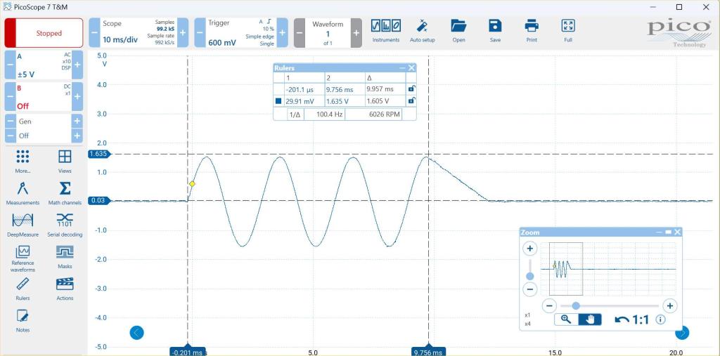

@Peter
Tested on V50707b30 picomite (non-VGA)
The picomite uses PWM for audio output.
PWM=50% is no signal
PWM varies between 0% and 100% (or 5% to 95%) when a tone is produced . The duty cycle is representative for the audio tone.
PLAY TONE 1000,1000,50000
When tone output is stopped
PLAY STOP
The PWM's are not updated anymore with the audio modulation, but remain running at 44.1kHz.
However....
The PWM's are stopped at the last value they had. If this is the top of a sinewave, the  PWM is at 95% duty cycle. And there it is stopped. When this PWM duty cycle is demodulated (filtered) to audio, stopping the PWM results in a DC output voltage.
When possible, I suggest to include a PWM=50% when stopping the audio tone. This returns the audio level to "no tone" voltage.
P.S. This may as well contribute to clicking between notes played.
Edited 2023-03-31 22:28 by Volhout

Posts: 6104
Posted: 02:48pm 31 Mar 2023
Hi Peter,
  Quote  All OK again now
95% there......
do
 play tone 1000,1000,2000
 pause 1000
 play stop
 pause 1000
loop
You start tone for 2seconds, but cut it after 1 second with play stop.
In 95% of the cases it returns to 50% PWM. In the remaining 5% it stops at the peak of the sinewave (for whatever unknown reason only that value).
Attach the scope to the audio output and you will see the sine wave alternating with DC level. 95% of the time that is 50%, bot sometimes not.
P.S. Maybe it is me, but F2 will not run the code from the editor. I need to press F2 2x (or F2, RUN). Haven't investigated this yet, just an observation.

Posts: 11850
Posted: 04:51pm 31 Mar 2023
The point is that if stop just sets to 50% then that itself creates the pop sound - it is a discontinuity. By using the tone with a finite duration it automatically aligns with the waveform and therefore finishes without a pop. It is much better to code without every using stop
In the latest releases setting SOUND to null or 0 volume automatically ramps the voltage to 50% over a short period to avoid any pops. TONE with a duration will automatically modify the duration to an exact number of waveforms. WAV files typically finish with silence.
If it worries you so much I can put a ramp down in play stop but much better to use the play command so it isn't needed.
The F2 issue is a bug introduced after a simple obvious suggestion by Gerry that I followed without remembering why I hadn't done it in the first place - will be fixed in next beta when I revert to the original code
Posts: 11850
Posted: 05:20pm 31 Mar 2023
Does this make you happy
play tone 330,330,100:pause 10:play stop
wherever the analogue value is at the time of the stop command the firmware ramps the voltage to vcc/2 over a period of 2.4mSec
Edited 2023-04-01 03:22 by matherp

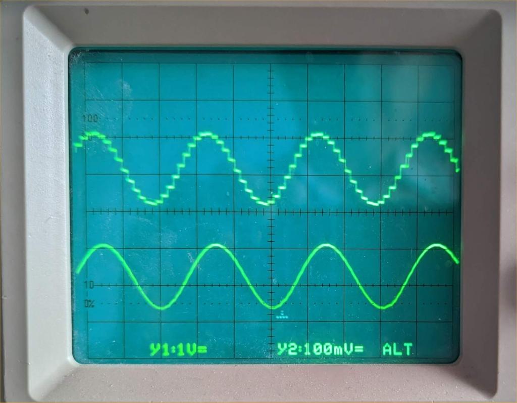

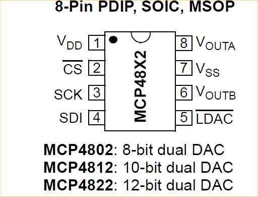

Posted: 09:59am 02 Apr 2023
V5.07.07b33 / WEB V5.07.07b3
Support for MCP4822 DAC (8 pin version) for audio output
USE:
OPTION AUDIO SPI CSpin, LDACpin, SCKpin, SDIpin
to enable this.
NB: SCKpin and SDIpin must be valid SPI TX and CLK pins as per the manual.
The SPI channel is dedicated to the DAC and can't be shared.
This mode will also use the PWM channel associated with the CLK pin chosen.
e.g OPTION AUDIO SPI GP0, GP1, GP2, GP3 uses SPI and PWM 1
USE standard syntax for PWM AUDIO output
Advantages of the DAC
Available as a PDIP
No complex filters needed
Less noise on audio
Internal 2.048V reference so voltage swing is between 0 and 2.048 volts
Cheaper for production by JLC (less extended range components)
Disadvantages
2 extra pins required
one SPI channel and one PWM slice dedicated
b33/b3 also changes the frequency used for PWM and SPI output for audio as follows
CPU frequency 48-251MHz - 44100Hz
CPU frequency 252-377MHz - 88200Hz
CPU frequency 378MHz -132300Hz
Picture shows PLAY TONE 3000,3000 with a CPU speed of 378MHz. This gives 132300/3000 = 44 samples per sine wav which you can just about pick up the individual levels on the scope. This is taken with the DAC on flying leads - hardly ideal - but still an excellent result

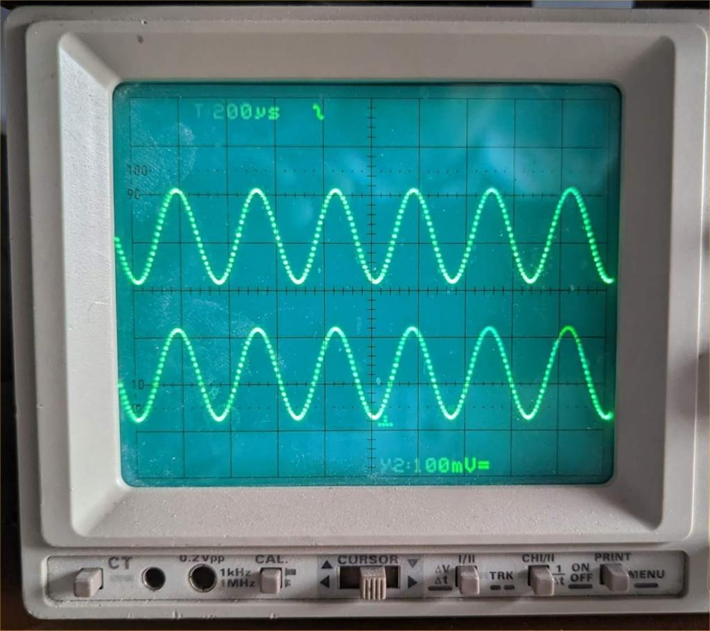

And here is a picture of PLAY TONE 13230,13230
The frequency is chosen to fit the DAC update rate so we get exactly 10 samples per waveforms

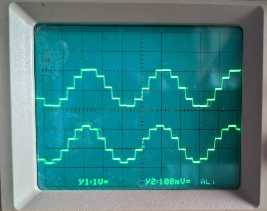

Final Pic
PLAY TONE 13230\2,13230\2
Bottom trace has the DAC connected via a 100ohm resistor into a 100nF capacitor - all that is needed for a perfect trace
