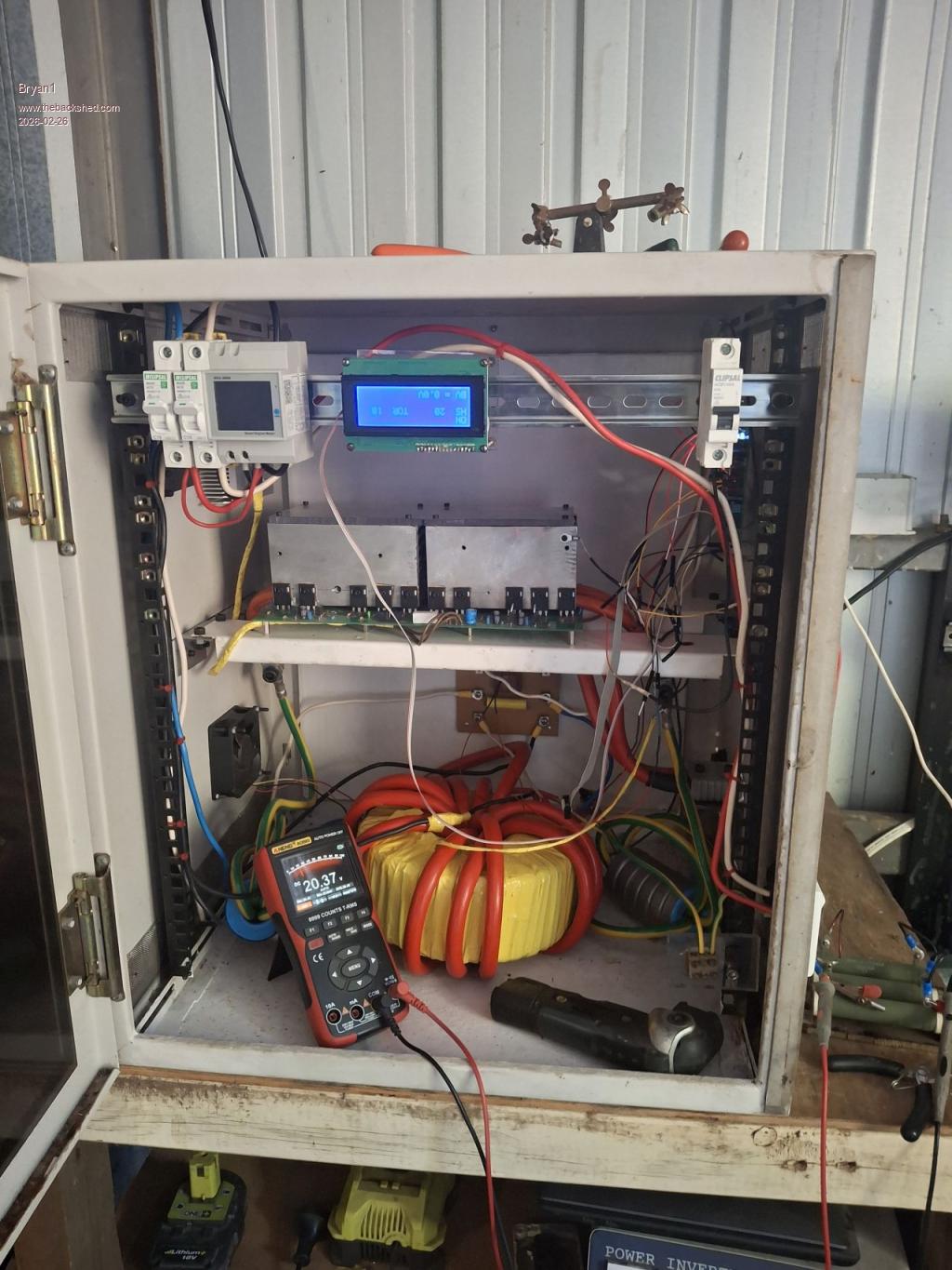

Ok another day to try and sort this out
So the 240 volt AC side does show a dead short and as we can see in the photo above with the output from toroid the white wire go straight onto the AC board where the black wire goes thru the hole of that energy meter then onto the other side of the AC board. Which naturally would show a dead short as a single wire is used.
Checking my first inverter build the AC board is the same yet when connected it does startup ?
So looks like I need a hard lesson on the output side of this inverter as I am sure it is the problem
Regards Bryan
Posts: 3412
Posted: 11:41pm 26 Feb 2026
The 240V winding of the TX will have a very low resistance. Is that what you are measuring?
Disconnect the 240V winding then separately measure it and the rest of the 240V circuit.
