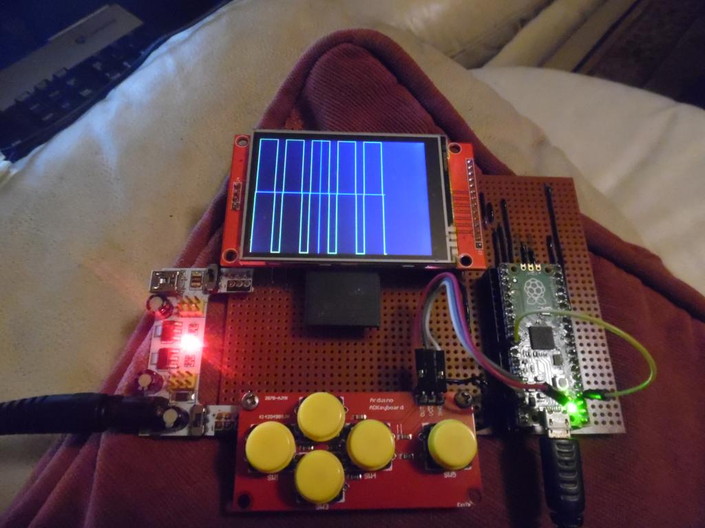

GP16 pin21 is spi so use any free pin if 3 button option. I'll try ili9341 not 9488.
I'll try my 3.3V vga kb clk, data, +,-.
my intentions gui touch area for 3 button option but need to follow code to implement.

I tried Jims's scope on ili9341 but errors
RUN
[303] PWM 1, PWM_Freq, PWM_Duty+PWM_Jitter*Rnd  ' Randomize duty cycle to ensure displayed Signal isg
Error : Pin not set for PWM
> C:\Users\stanley555\Downloads\2023-09-01_071921_cro\cro.bas
Uploading using:  'target port\COM13:115200 s\picomite
Upload started
NEW
AUTOSAVE
Upload completed
Saved 12426 bytes
RUN
[267] SetPin GP18, PWM1A               ' Set up pin 24 for PWM test Signal output
Error : Pin 24/GP18 is reserved on startup
Upload started
NEW
AUTOSAVE
Upload completed
Saved 12425 bytes
RUN
[315] Math window buffer(), limit1,limit2, buffer2()
Error : Syntax

Ilil9341 works with frame and layer L.

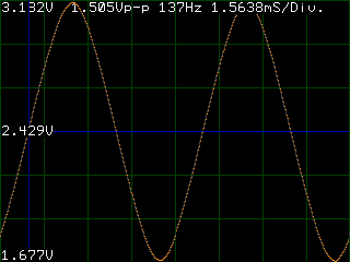

And here we are, back in Venice with more... Scope progs. *
Now with optional automatic Frequency and Voltage adjustment, thanks to Peters Math Window.
Hopefully the comments in it are helpful.

Stan, no Subs, all linear to make following it easier.

Posts: 2807
Posted: 02:05pm 04 Sep 2023
In the last photo I posted "frame and layer L works on ili9341" the button pad is analogue to gp26 but now that's scope input adc0. Could I still use adc1 for the button pad or would I lose adc resolution?
The button pad works, it was a Tron game running and was more responsive than gui touch area for playing the game.

It works on 3.3V but sold as arduino so meant for 5V but 5 buttons using 1 pin is neat and it was cheap. stan
ps. no debounce code
