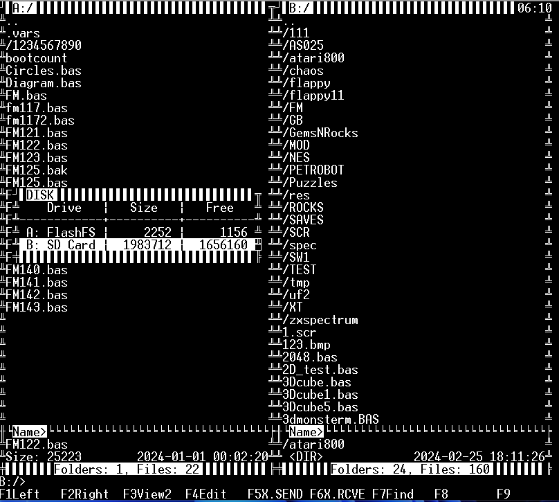

FM v.1.45 for PicoMite VGA/HDMI
FM145.zip
This version supports multiple file selection for copying, moving and deleting. (No folders yet)
Attention! When multiple selection, files are processed without confirmation of the action.
I have stopped using TILES, only the PRINT command.
javavi
Joined: 01/10/2023
Location: Ukraine
Posts: 637
Posted: 07:11pm 31 Mar 2025
FM v.1.46 for PicoMite VGA/HDMI
FM146.zip
Now it can delete folders with files and subfolders, also by multi-selection...
Be careful!

I have only now find time to play with this. On my PS2 controlled 2040 VGA platform, <shift>-F does not work. So this improvement is useless for me. I cannot change drive anymore. B.t.w I used your earlier 02032 to completely re-arrange an SD card. Worked well.
Posts: 6259
Posted: 08:08pm 31 Mar 2025
@javavi,
FM146 works nice, also with copying selections.
If I may make a suggestion: the blue color for audio files does not work nice on my screen. It is too dark. Maybe use a different color.
And files types that you do not recognize are colored green. Maybe these should be left white. Then use the green for audio files.
I think I need to get used to the color changes. The early versions had a very simple interface, easy to the eye. The new coloring sometimes looks like "too much". It works well, but too many colors confuse. In hind-sight, just coloring the BAS files in one color, and the known audio and video files in another color. The rest stays white.
I know that everyone taste is different. I hope you do not feel offended by my comment.

  Volhout said  Maybe use a different color.
There you can disable Colorer by specifying a color constant. You can even disable it for just one panel.
Suggest your own colors for file types?
I think I'll make a settings panel in the future.
