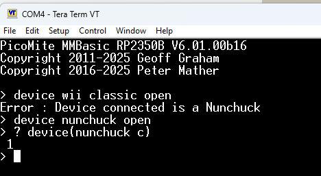

Posts: 6197
Posted: 06:50am 01 Oct 2025
@Peter,
Have you ever been able to find out what causes the issue with the 2 WII controllers ?
When you open a WII classic, but have a WII nunchuck connected, it gives an error message. When you next try to open a WII nunchuck, it says this is not possible (the channel is open). Closing the classic in between does not help (the channel is already closed).
Do the reverse
When you open a WII nunchuck, but have a WII classic connected, it gives an error message. When you next try to open a WII classic, that works.
I already use a work around (doing the I2C in MMBasic) but I was curious if you ever found out why. I think this was on b11.
