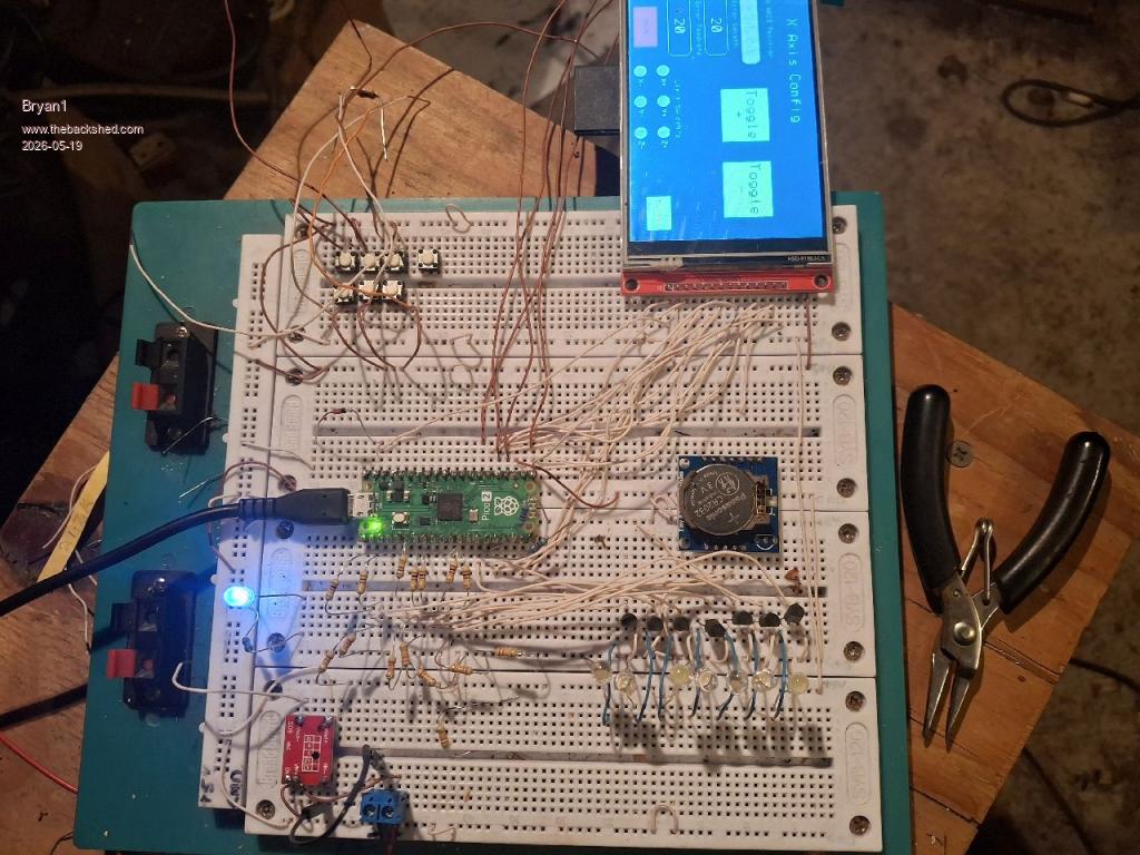

Ok loaded the code up and no errors   now on MCCC it does say the stepper is running and after I input numbers for travel and feed the press the toggle switch nothing happens, no change on MCCC and no change on the actual machine position display box.
So yes Lyle in order to get the steppers to move my idea is put a distance in the top display box along with a feedrate in the lower display then when the toggle swicth is pressed the axis moves the amount entered then more press's of the toggle button can move it again.
Now the numbers in the display box's were done via stepper position in the setup code.
Here is a picture of my breadboard setup for testing.
I have white LED's on the the Axis outputs for indicators to make sure the code is working, the 1K and 22K resistors for the outputs is all setup. Now the picture does show the X axis config page.

Thanks for that Lyle   so in the morning my second caffine intake can while I use this code to see if I get atleast the led's lighting up.    I still need to finish wiring up the DM556's and run a solid wire from my cnc where I have a wire with the battery voltage. So the Vcc on the DM556's will be around 26-29 volts depending on the state of my shed battery.
So tomorrow hopefully this project will move one step further.
Regards Bryan
