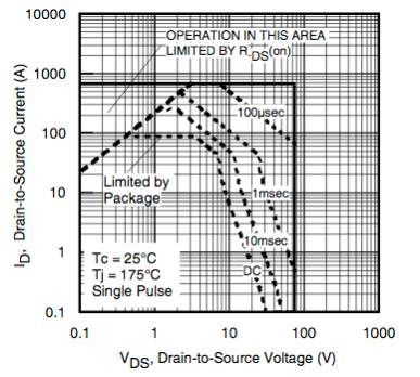

The pair of IRFP2907 in TO-247 packaging arrived today.
Given the SOA
I was surprised it lasted to 3 Amps at 30V
The HY4008 are still more robust in this DC test.
(just when does DC become AC when we are feeding a squarewave of some duty cycle...
When I read DC I think it's damn well DC. The specs say "oh, our device can handle 200 Amps. Yeah right. Oh, it's "continuous current". OK, it must be continuous for about 10 msec or less.)
Anyway, just tying up loose ends. In 5 days the IRFP4110 will arrive. Probable same result.
Posted: 07:25pm 23 Oct 2018
Yup.
When you start to look at the de-rating curve and transient thermal impedance curve that huge "200 amps dc at 25C" rated device starts to shrink down into a midget.
All that many novices see at the top of the data sheet is that "200 amps maximum" and fail to realise that is just an unachievable theoretical maximum.
Somewhere to anchor one end of a sloping line that could otherwise just rise to infinity at some impossibly low sub freezing temperature.
Once you have defined that operating line between 25C and 160C, you can then pretty easily work out a reasonable safe operating current at any practical operating temperature somewhere in the middle.
That is the purpose. Nobody expects to work at either 25C or 160C they are the absolute unattainable limits. We are only interested in the region between.
You cannot run even at moderate power and hope to keep the little silicon thingy inside at 25C, even with chilled water cooling. But strangely its the 25 Celsius operating point that is used as the baseline temperature for the advertised maximum current rating. Its just the commonly accepted way of presenting the specification which is totally misleading to the uninitiated.
Those skinny mosfet legs are not going to be able to carry 200 continuous amps (laugh) and the whole idea of 200 amps continuous is ridiculous for either a TO220 or TO247 package.
Not only that, too many people think that the MAXIMUM rating limit line on the safe operating curve, just a whisker short of total destruction is a mighty fine place to plan on running that device.
But worst of all, those counterfeit Asian parts might never even come close to what a genuine part might be capable of doing. They could be perfectly o/k or maybe not.
Are you feeling lucky ?Edited by Warpspeed 2018-10-25

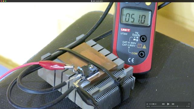

Today I put one HY4008 on a PC cpu heatsink, no fan.
I then put it on the high side supply to a spare inverter (Powerjack LF something)
with a 10 litre hot water urn as AC load.
The idea is to put about 50A DC through one HY4008.
The only load of this size I have access to is an inverter powering a large AC load.
I had to set up a camera to video this just in case we had some 'splosions.
I precharged the inverter caps via a resistor, switched on the HY4008 with 14V gate drive from the bike battery charger and ... no sparks.
I switched the inverter on and .. no sparks.
I switched the urn on and .. no sparks.
It ran fine for 6 minutes or more. In this case the heat generated from the MOSFET was conducted efficiently to the heatsink. I had the copper plate of the heat sink warmer than the front of the TO-247 case of the HY4408.
Not a lot of heat actually, maybe 15C more than ambient with no fan.
So at last I have a test that shows heat conduction to the heat sink working well.
I repeat I was concerned with this but after this test today I am happy to use
the heat sink temp as a guide to HY4008 junction temperature.

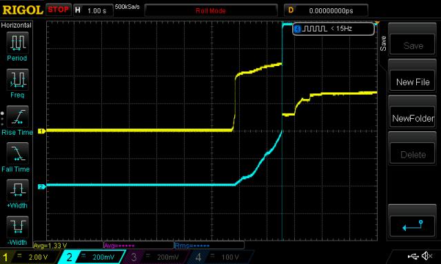

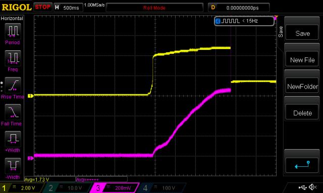

Posted: 11:38am 30 Oct 2018
And I have done this test against an IRFP4110.
It is just like the others (HY4008, IRFP2907).
These 3 MOSFETs do not like intermediate gate drive voltages.
They want to be either fully ON or fully OFF.
For completeness sake, here is the DSO capture of the 4110 failure.
I am not trying to use these MOSFETs for any novel application involving heating.
I am trying to understand, in a hands-on, experimental way, how they live and die.
Once one small part of the MOSFET starts conducting more than the rest of the chip, this small part gets hotter and hotter, conducting more and more and then it shorts the entire chip. If you look at the specs of some of these MOSFETs you will see the transfer curves have a temperature dependence, if the gate voltage is below something like 4V then heat induced feedback destruction will occur, if gate voltages are well above these sorts of values, there is a small negative temperature driven feedback.

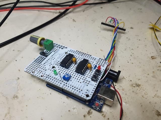

Oh, and here is a pic of the Arduino inverter controller I am using now.
It is much more compact and probably more reliable without so many flying leads going everywhere.
I run the usual 1/2 squarewave 1/2 SPWM signalling, a la EG8010.
I also run my full SPWM on both 1/2 bridges type signalling, which makes for a smoother output waveform and my code has both a soft start as well as a soft stop function.
This daughter board for the Arduino also allows me to run modified code which permits you to have variable output frequency (from 40Hz to 100Hz AC at full power).
Additionally, I can experiment with arbitrary PWM frequencies, continuously variable from 2kHz to 70Khz. This illustrated resonance peaks of the primary choke/capacitor LC filter very nicely. Again I run this at reasonable loads such as 500W.
The device only needs +12V which is referenced to DC bus ground.
The trimpot allows adjustment of deadtime from about 400ns to about 2us.

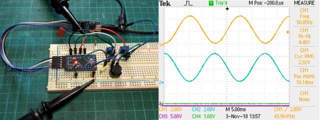

Thanks Poida for the code.
Loaded the 2x_sinewave_pwm into pro-mini and it worked right away. I was surprised how short the code is, almost fits whole on the screen.
Nice soft start and stop of the sine wave. When I stop the sine wave generation (with button) there are still 20Khz varying length pulses (~100-500ns) running on the outputs. Is that intentional?
Now I need to get those IR2184.

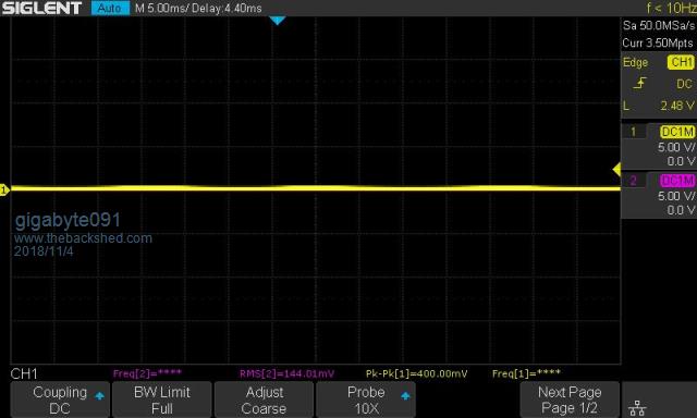

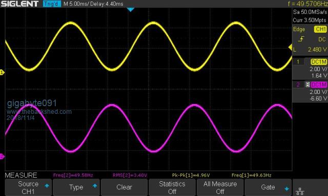

Posted: 02:54pm 03 Nov 2018
Great work Poida, i was also suprised to see how code is small...
Here are my results:
Code running, waveform after RC network (4k7 and 100n)
Code stopped, waveform after RC network (4k7 and 100n)
And setup:

  gigabyte091 said   Great work Poida, i was also suprised to see how code is small...
Excellent to see again someone looking at this. I hope you find some fun &/or value
from it.
The enable output (pin 5 or PORTD, bit 5) is used to enable the IRF2184 outputs via
the Shutdown input. Gate drive output enabled = logic HIGH, disabled = LOW.
If you want to build something based on these codes, I want you to place a 1000R resistor on pin 5 to ground. This will pull this pin to zero volts until it is driven by the code. I found that on bootup, the Arduino lets this and other pins float with a high impedence. This may, and has in my experience, let the IRF2184 shutdown pin go high in an uncontrolled manner, at unwanted times.
The Arduino outputs can easily drive the 5mA as seen due to the 1000R pulldown resistor.
If you have any questions just ping me here.

poida
Joined: 02/02/2017
Posts: 1497
Posted: 11:54am 05 Nov 2018
I bought 2 boards from Madness and intend to run one via my Arduino plus IR2184 drivers board combo as seen in recently here. The other is a spare, for when my desoldering skills render the board completely munted.
I want to see the difference in MOSFET gate signals between totem pole drive and gate drive IC.
I will probably use the traditional code (50Hz squarewave on one 1/2 bridge & 20kHz SPWM on the other) first, then move to the 2x sinewave code.
You will enjoy a lot of support from here if you build a system based on the EG8010.
No board level changes are needed (on the power board) for the Arduino to work.
You will need to make an interface board (taking Arduino 5V signals and driving the 2 1/2 bridges of the power board). I can help you with this if needed.
