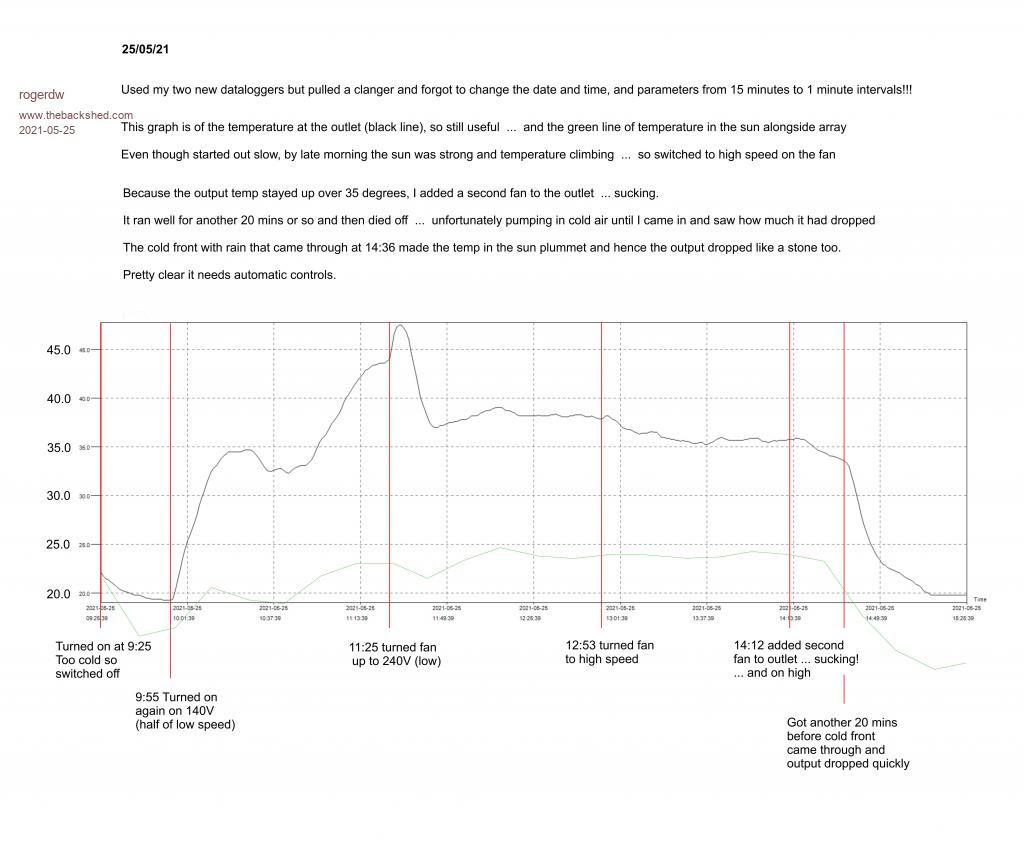

I haven't posted in here for a few days, but the system is still working well and I am very happy with the results.
I have been paying a bit more attention to the higher temperature levels when they occur  ...  and turn up the speed of the fan to push that heat through quicker.
Of course that reduces the output temperature  ...  but seems to increase the inside temperature more quickly.

  Quote   Turn up the speed of the fan to push that heat through quicker.
Definitely on the right track.
Variable speed blower (a big one) should make a lot of difference.

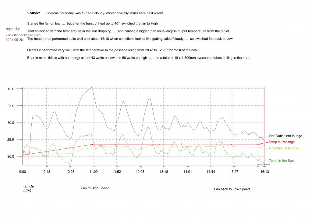

In the mean time I had a discussion with someone about the air temperature and the volume of air.
Their suggestion/argument was that 3 cubic meters of air at 25 degrees was no different to 1 cubic meter at 75 degrees  ...  but of course you and Mike have been saying all along to aim for more volume at a lower temperature differential.
And since taking that on board I feel that I do get a better result  ...  but not sure if that is really measurable or how to actually prove it.
In my research I see that with airconditioning the recommendation is to pump in air 10-15 degrees above the desired room temperature  ...  say 28-33 degrees  ...  but with a gas or oil furnace the input may be around 54-60 degrees.
I do notice that if I let it get too low (much under 25) that up close it feels like a cool/cold breeze  ...  so at the moment I feel I would like to keep it at least 25 minimum and aim for around 30 or so. If it gets any higher than 30  ...  my blower should ramp up and really push that in while it's got the chance.
Cheers,  Roger
Posted: 12:47am 28 May 2021
  Quote   but not sure if that is really measurable or how to actually prove it.
You can prove it easily enough, by the ratiometric power measurement system you are already using. However many watts it takes to double the temperature rise will remain a valid power measurement, be it one degree or fifty degrees temperature rise.
  Quote  In my research I see that with airconditioning the recommendation is to pump in air 10-15 degrees above the desired room temperature  ...  say 28-33 degrees  ...  but with a gas or oil furnace the input may be around 54-60 degrees.
The heat generating mechanisms are totally different.
With combustion, the heat source runs at an extremely high relative temperature, and the heat energy available from the burning fuel is pretty much fixed.
With airconditioning, particularly cooling, the refrigeration system is always battling to maintain a temperature differential.
The lower the temperature differential between the hot side and cold side, the more efficient the refrigeration system will be, either heating or cooling.
Likewise, a solar system that relies on radiant heat from the sun. The heat absorber temperature has a great bearing on how much heat is absorbed, and how much heat is re-radiated.  A piece of red hot metal cools very fast just from radiation, because it is so much hotter than the surroundings.
Anything hot will radiate heat, and the hotter it is than the surroundings, the more heat that is lost through radiation into the surroundings.  So a solar thermal collector needs to run ideally at ambient temperature, or not much above ambient temperature to absorb maximum heat, and reduce the heat losses.
Thermal conduction is an entirely different process, but there again, the nearer something is to the surrounding ambient, the lower the thermal losses through any insulation.
So for solar thermal, you want to run your black solar heat absorber at as lower temperature as possible for maximum heat gain, and minimum heat loss through re-radiation.
There will be diminishing returns though, when blower or circulating pump power becomes ridiculous. So a variable speed blower makes a lot of practical sense to capture what is there.

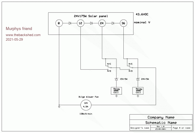

Can a standard automotive A/C blower be used to move the volume of air you need?
Could an MPPT controller be used to produce an optimal fan speed based on the amount of sunlight? There must be an optimal flow rate where a maximum amount of heat is transferred at any given solar flux. Tracking the power point to set the fan speed for could be fine tuned with an in-line resistor. Or is that just silly talk?
Posted: 03:32am 28 May 2021
I suspect that all that will be required is a dc blower powered direct from a solar panel.
There can never be too much airflow, although air roar and blower noise may become intrusive and objectionable at some point.

  InPhase said  Can a standard automotive A/C blower be used to move the volume of air you need?
I would gaurantee it witht he right unit. The subaru one I have does over 100w and the one roger is using now I think he said does 54. The AC systems in cars are complex and have narrow passages now and it takes a decent blower to do the volume and pressure.
  Quote  Could an MPPT controller be used to produce an optimal fan speed based on the amount of sunlight?
Not at all sure it would be needed. Been running fans off panels for years direct connected and they work fine. Not like you need any optomisation with this really, at best all one would need at best would be a voltage limiter. I have one on one of my inverter fans just cause the thing gets carried away in summer and screams with the high voltage but been running like that for years and has been fine.
MPPT is to really get best efficiency from the panel. If you have an old 190- 250w panel  on a 12V fan/ blower, it will do plenty of power. Panels will still outpower the load even if dragged off their efficiency curve and who cares about max efficency?
PWM may be ok for just high voltage control though.
  Quote  There must be an optimal flow rate where a maximum amount of heat is transferred at any given solar flux. Tracking the power point to set the fan speed for could be fine tuned with an in-line resistor. Or is that just silly talk?
I'm not sure even a resistor is needed.
I was up the shed this morning poking round for some stuff I need and the fans were blowing and it was bloody cold.  I was just about to go over and disconnect them when a cloud came over and the things went from a roar to barley turning.
There must be a linear relationship between the heat a tube produces and the power a panel produces.  I was thinking a fan as well but I think it could be even simpler, just shade the panel. Bit of plywood/ cardboard/ plastic whatever across the panel  should be all that was needed.  If the output of the panel and tubes is linear as is the relationship, then all I can see is needed is get the power of the panel down to match the fan more so than the tubes.
The other way as I already suggested is just restrict the blower intake or output.
From what I have seen with my direct coupled fans I just dont see a lot of control is going to be needed. The energy from the sun will be proportional even if the efficiency is different so I would just start off with the easiest and simplest method and that's direct hookup and then IF control was needed, just shade the panel or restrict the airflow.
I think if the airtemp is too low the fan won't be running. From what has been said. I think the tubes will be up to temp before the fan kicks in. If not, reduce the panel output with a shade  until the amount of sun falling on it and getting it to kick in is at a point where the tubes are already making heat.
Like everything, Simpler, lowest cost and minimal setup time I think the better.
As I mentioned above, I picked up a commodore fan assy today. It claims 12.5V and 230 Watts  ..  but with my power supply it was only about a hundred watts!!!  But that is still twice the power of high speed on my current motor  ...  and it seems to move a lot of air  ...  so if I can build an efficient housing and duct, I'm pretty sure it'll be up for the task.
I was surprised to see that it has a pretty gutsy looking brush motor driving it.
I am of two minds when it comes to driving the fan, whether to try and use just a solar panel with zero electronics  ...  or to build a dc control that can vary the speed to keep a relatively even output coming from the heater.
I kinda like the idea of both really  ...  so will have to see how my experiments go.
From what I have seen so far  ...  I think an intelligent control could ramp the motor up and down to even out the temperature really well  ...  though the motor speed would be constantly changing  ...
...  and as Tony says, the minimal approach leaves less to go wrong.

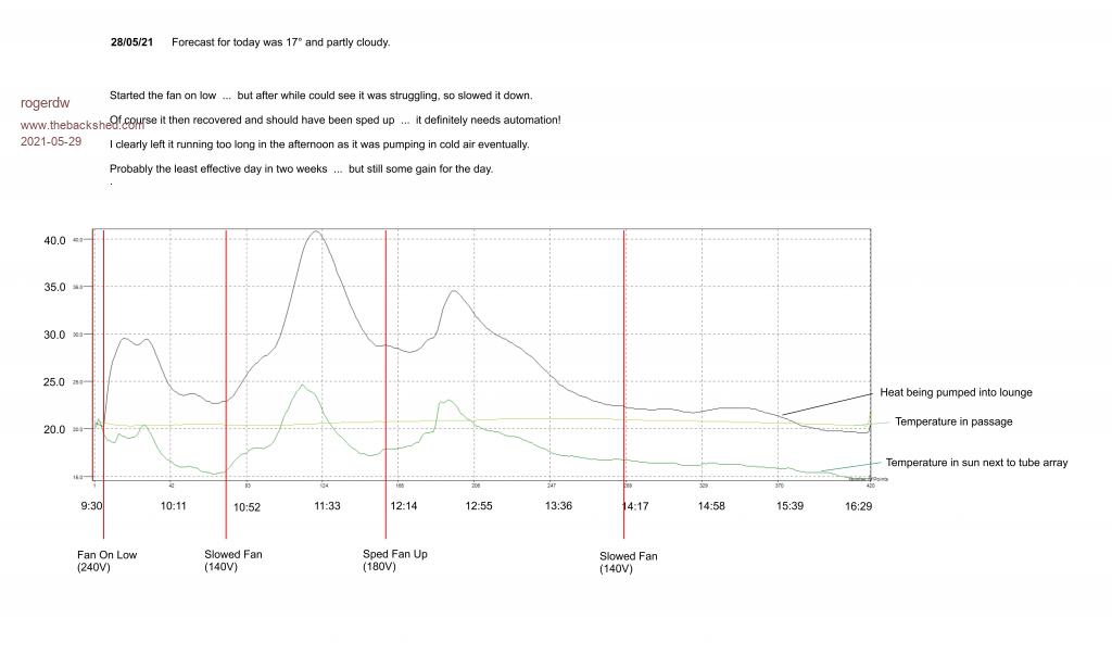

Todays results were probably the poorest of the last two weeks  ...  but considering the run I have had so far, am still very happy.
There was pretty much full cloud cover all day  ...  and in fact at one stage they were really black. Was expecting some solid rain, though nothing came of it.
It is amazing to me just how much the conditions must change during each day, despite the physical outlook appearing to remain much the same.
Uploading the data from the loggers is always a surprise as there are often temperatures that I wasn't expecting because I didn't see any sun or extra brightness  ...  but the numbers don't lie.
And it reinforces the fact that I need better control so that when excess heat is available I pump it out faster  ...  and conversely, when there is no heat, the fan needs to stop so I don't pump in cold air and undo all the good work the sun has already done.
Cheers,  Roger

Placed out all the dataloggers and turned on the fan  ...  44 degree heat blowing into the lounge!!! Turned it up to high speed and has now settled down to ~30 after 40 mins. Edit: 1 hr now!
Because the array is at ground level the bottom 18 inches are still shaded by the fence, so should improve once it's all on the roof.

I have hooked it up to a 250watt panel and it's ripping along at 7.5 volts. I know it has no load yet, but it seems it could be comparable to my 240V fan.

Yeah, good point  ...  though since you guys convinced me I need to aim for higher airflow at lower temperatures rather than lower airflow at higher temperature  ... and my results seem to be bearing this out  ...  I want to stay on top of the speed and temperature to gain the most heat.
I know it's great to look at the chart for the day and see all this time up around 40-45  ...  but I've realised if I can pump it out quickly and keep it down around 25-30  ...  then I get the best gains. (I believe)

This might be of interest to the current topic.
I have an old 175W/24V solar panel which had the wires cut off right at the connection box, so no good to connect anything.
But, being curious, I opened that black box where the wires came from and, after removing the three plug in diodes and the snap on carrier for them, I was left with 4 alu strips coming out of the panel.
I have a 12v  130cf/min bilge blower which I connected in turn to these strips. It was very overcast but the fan started turning from as little as 3V.
So I thought of a simple fan speed controller - see schematic below:
The idea is with low solar the fan runs of the full panel voltage available. As the solar voltage increases the relays pull in and stop the fan from screaming its head off.
I have not yet tried that and would appreciate any suggestions regarding the functionality of this idea.
