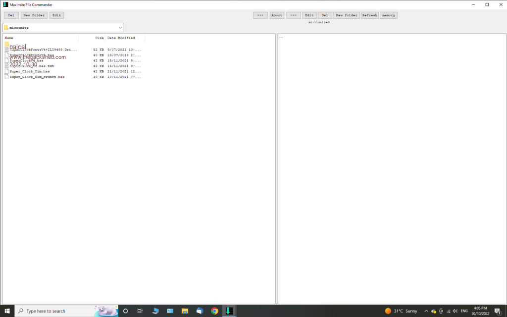

No go. Instead of SDcard it now says Memory and when I click on it it does not change to SDcard. The file in the Micromite is not shown.
Posts: 6603
Posted: 06:31am 30 Oct 2022
Sorry, I misunderstood.
Go back to 'micromite'
When asked to select flash slot, select 'current program'
The picomite would be showing all slots but the micromite only shows what's available - the current program in memory.
palcal
Joined: 12/10/2011
Posts: 2052
Posted: 07:00am 30 Oct 2022
OK that worked 'Current Program" transferred to the PC OK. Still don't understand why it says SDcard in the box at top right.
Posts: 6603
Posted: 07:02am 30 Oct 2022
  palcal said   Still don't understand why it says SDcard in the box at top right.
I should have that greyed out for systems that don't have one.

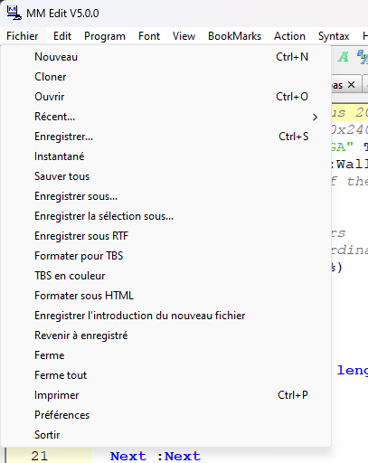

Posted: 04:43am 02 Nov 2022
MMEdit5 has almost reached some sort of stability thanks to the feedback received.
It's time to think about the next big thing - multilingual.
Like most native English speakers, English is the only language I speak.
I assume that speakers of 'other than English' might like the menus etc to be in their preferred language.
An example of the File menu in French:
This is as far as I have gone until I find out if it is worth doing.
The number of languages is unlimited but it will need native speakers to do the translating to get the meaning right. This is what Google translate gives me for the file menu:
[Language]
Edit = Modifier
Close all = Ferme tout
Exit = Sortir
Save as rtf = Enregistrer sous RTF
Clone = Cloner
Save new file intro = Enregistrer l'introduction du nouveau fichier
Tbs in colour = TBS en couleur
Format for tbs = Formater pour TBS
Open = Ouvrir
About = À propos de...
Quit = Quitter
New = Nouveau
More = Même plus !
Recent = Récent...
Save all = Sauver tous
Print = Imprimer
File = Fichier
Save language = Enregistrer la langue
Save = Enregistrer...
Save selection as... = Enregistrer la sélection sous...
Info = Informations
Format as html = Formater sous HTML
Save as... = Enregistrer sous...
Preferences = Préférences
Close = Ferme
Snapshot = Instantané
Load = Charge
Revert to saved = Revenir à enregistré
The way it works:
I write the program in English with one small addition
xlate("Snapshot")
the xlate function looks up the translation for "Snapshot" and if found, uses the translation. If not found, English is used and the missing translation is remembered. Users doing the translation can export the language file and look for lines marked as missing. These lines get attended to.
For a new language, one of the existing lists is used as a template. Native speakers can type their translation much quicker and more accurate than using Google translate.
Changing menus and tooltips is no problem. Changing text on buttons can cause grief when the new text doesn't fit.
Having multilingual menus will slow the startup slightly but will not have any effect on speed once the windows are open.
MMBasic code will not be affected and you still need to keep comments and strings as 7 bit ASCII. No extended ASCII allowed.
I am not intending to translate the help files.
I will only continue with this if there are sufficient users of MMEdit who will make use of multilingual menus.
Over to you...
