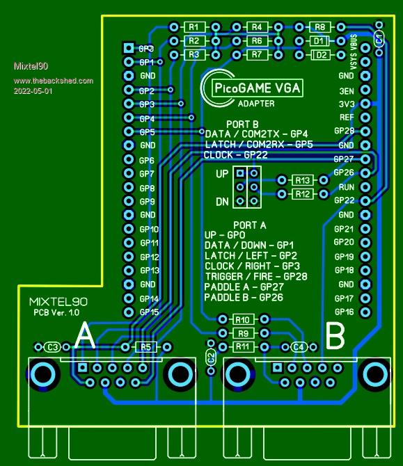

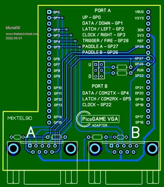

Posted: 08:42pm 30 Apr 2022
Done it. It's remarkably compatible with version 1.4 too. I also discovered that the silkscreen on the back of version 1.4 is wrong! lol Note that compatibility is with 1.4, not the prototype.
Port A takes Controllers or joysticks as before. All signals are the same except Trigger/Fire, which is now GP28. Peter has used GP14 and GP15 for I2C.
Port B takes Controllers or works as a COM port. All signals are the same except that there is no Paddle input (was GP28) and no Trigger/Fire (which isn't needed without the paddle).
Peter used GP6 and GP7 for audio so I've not needed to do anything with that (I used the same pins).

Posted: 08:57pm 30 Apr 2022
Seems like the 10k pull-ups to GP0-3 are missing. The 10k pull-ups for GP4, GP5 and GP22 are missing, along with the two BAT48 diodes on GP5.
Posts: 8978
Posted: 09:18pm 30 Apr 2022
Oh, come on... I design two PCBs in one day and you complain about a few missing bits?  ;)
TBH I never even thought about them. It'll give me something to do tomorrow when I'm more awake.

Posts: 8978
Posted: 09:16am 01 May 2022
I got the mole grips out and squeezed the rest of the bits onto the pcb.
circuit.pdf
Yes, al18, no pins left. One of these days I'll experiment with the pad underneath that gives access to the LED pin. :)
On Version 1.4 you can indeed connect stuff as you describe.
Port A - Atari joystick: GP0-up, GP1-down, GP2-left, GP3-right, GP14-trigger/fire
Port B - Controller: GP4-data, GP5-latch, GP22-clock
JS1 - GP26-Y, GP27-X, GP15-switch
GP15 does go to Port B, but the Controller doesn't use it. It's only there for if a paddle is being used on GP28.
You can't use the RTC if GP26 or GP27 are being used for something else though.

Mick,
Wow - thanks for the Pico Game VGA adapter board. Looks like another board I’ll need to build. I’m looking at Peter’s VGA board and it looks like the reset button is obscured by your game adapter board. Not a big deal, as I haven’t needed to use it yet. One thing you may want to adjust is the board profile around the notch. I can’t tell for sure, but it looks your board may contact IC2 on Peter’s board. You may want to trim the board where ‘Mixtel’ is on your board.
Thanks for answering on the trigger. On your schematic notes for the 1.4 board, you mention JS1 trigger is GP14, not GP15.

Posted: 05:12pm 01 May 2022
My board fits with the DB9 connectors over the top of the 2x40 connector.
The board will be at the same height as the PicoMite - If IC2 is in the way tere must be plenty of lead length, just bend it over (It goes over the top of Q1 and Q2 as well - where it would be awkward to shorten it). Certainly, on my boards, a TO92 comes just to the top of the SIL sockets (about 9mm). That gives about another 2mm to the underside of the PCB.
The Reset button is partially obscured (by about 1mm), but you could still get to it easily. You can't use it if the system is cased anyway.
(Of course, I could ask why you want to pay more money go get Peter's board then pay again to get my adapter when you could have just got the PicoGAME VGA for the same price as the adapter alone. :) I can only assume you need the expansion positions that are taken up by the adapter board...  ;) )
