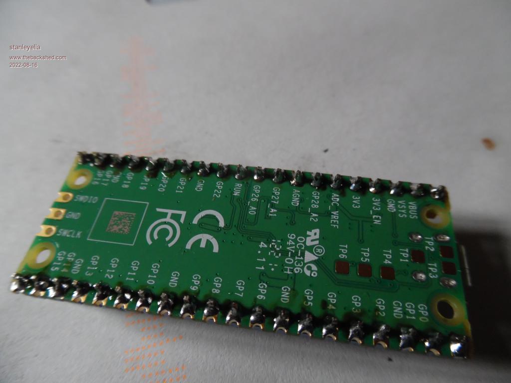

  Mixtel90 said  If you put male header pins onto the same side as the button then your PicoMite can't be plugged into standard sockets on anything. It's just unfortunate that the pin labels are on the bottom.
In many ways I prefer the VGA version, personally. The main problem is that you lose the Touch capability of the display.
Bit late I done it but it's for bread board so dim problemio?
still not sure should I use the vga firmware. it's like it's not a  ucontroller it's a uprocessor.
I don't plug it into anything.

If you only need it for breadboard then that's fine. :)  It has the advantage that you can see the labels and, as such, is very good as a self-contained experimenter's board. You just need to remember that pin 1 is top right and you count clockwise rather then top left and count anti-clockwise.

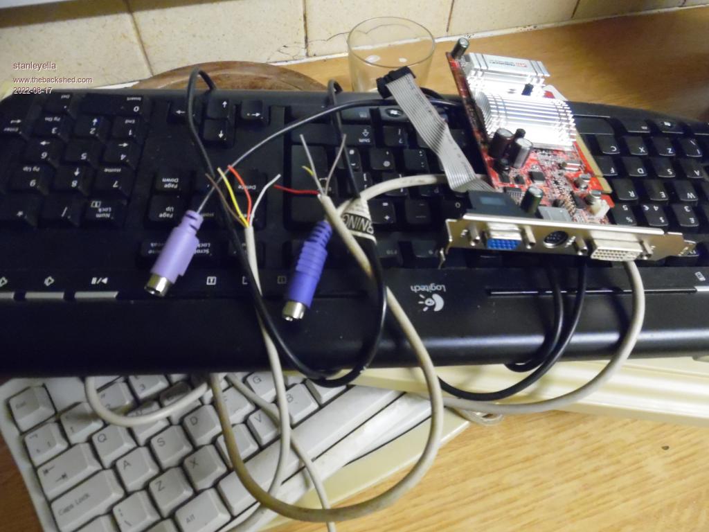

ok got ps keyboard and a vga connector just add headers to picomite/rpipico and flash vga firmware.
yeah. I'm mean :)

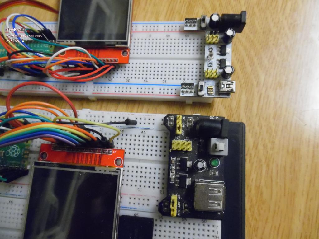

On bread board I use the linear 3.3/5v regs. 5v for the display but not 3.3v for the pico yet. got to sort 3.3v enable so it gets a clean supply cos I read a-d is noisy with picomite cos it uses a buckboost converter that's noisy and it's the a-d ref voltage. some interesting circuits you posted link to, cheers.

A-D on the PicoMite isn't good because there is an error on the chip. Treat it as 8-bit.
Apart from using a linear regulator you can also improve the noise figure by fitting a LM4040 precision 3V reference from 3V to GND and using
OPTION VCC 3.0
to change the input scaling from 0-3.3V to 0-3V, although the linear regulator will be pretty good on its own. The linear reg is very much recommended for audio use as the SMPS is simply too noisy.

A-D is obviously on the to do list but reading about psu noise and it's 10 bit but first and last are somehow lost.
These breadboard psus can give two 3.3v supplies.
a-d is a basic often used thing. got to sort it for poor psu noise. big cap?choke?
