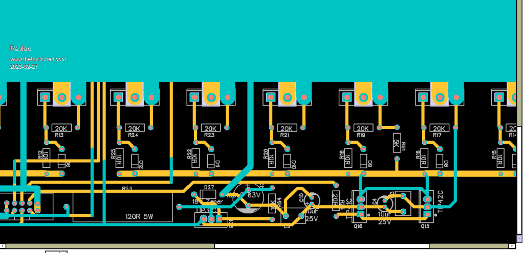

Revlac
Joined: 31/12/2016
Posts: 1309
Posted: 02:33am 27 Feb 2026
Also agree with comment above.
Brian, did you (or someone else) see the last Gerber PCB mad board file, there might have been some changes to the power board Depending on which board you have, the latest has a 10K on Pin 1 of the TIP35C, as well as the 18v Zener,  my board has not got the 10K, not sure if there was anything else, or if that is correct?
Don't want to create any confusion, but worth checking solder joints around the TIP41 and 42C just to be sure.
Cheers Aaron

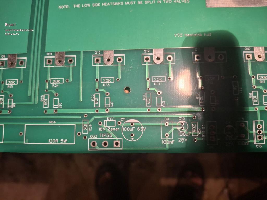

Bryan1
Joined: 22/02/2006
Posts: 2297
Posted: 02:58am 27 Feb 2026
Hi Aaron I do have that latest board but that 100uf cap is around the other way

KeepIS
Joined: 13/10/2014
Posts: 2282
Posted: 03:38am 27 Feb 2026
Both boards look right with respect to the CAP, different tracks, unless I'm blind.
