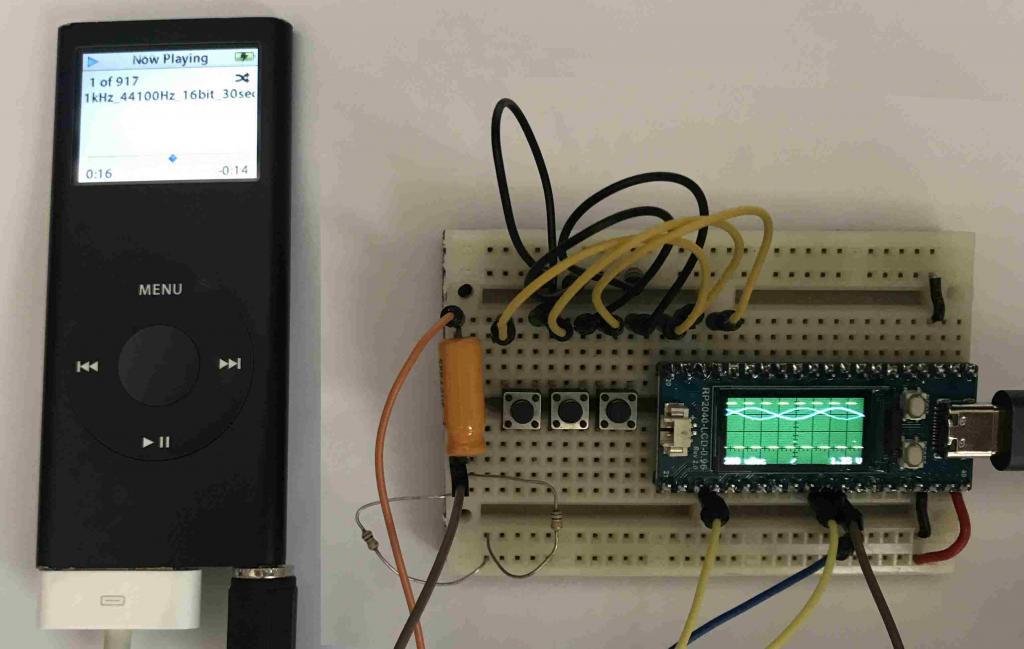

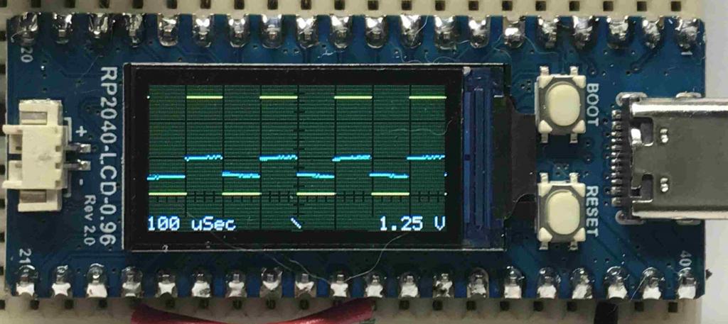

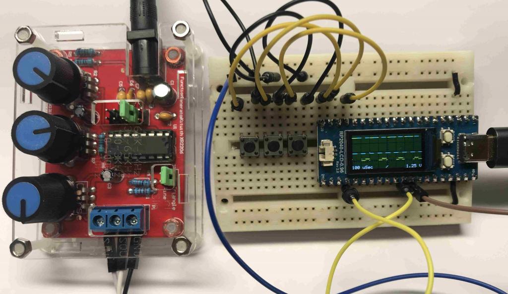

Mick: Mission accomplished! Here's a two trace scope. At the moment, triggering is only done on Channel 1, and the fastest time has dropped from 50 uSec to 100 uSec.
(Pin 31 wired to test signal; pin 32 is floating)
I had been thinking about how to do it this morning, and figured that my first whack at it would fail due to too much memory usage (second buffers for both the raw signal and the displayed trace), but wouldn't you know it, it worked first time out.
What a wonderful environment to code in!

LOL! Excellent. I wondered if someone would take me up on that one. :)
I anticipated that the ADC would now run at 1/2 speed compared to a single channel, so the maximum displayed frequency will be lower. Very pretty though. :)

Here's a photo using both the on-board test signal (from which trigger is derived) and an off-board XR2206-based (but exceedingly crappy) "signal generator" (well, my test leads are nothing to brag about either).
I don't have access to better signal generators. Sorry!
Posts: 8973
Posted: 09:09pm 04 Sep 2023
Unfortunately you almost certainly can't display a sine wave from that without level shifting the input. You are seeing just the top half of the sine, the bottom half is being clipped.
This will bias the trace to mid voltage (about 1.65V) and let you see both halves.

I got XR2206-based (but exceedingly crappy) "signal generator" as well. they messed the circuit for cheapness but it can sweep freq which tests a scope.

Well, that's better. Reviewing the XR2206 IC schematic, it's biased up to half the (9V) supply voltage, so it's a wonder that I got anything at all.
With a 47 uF capacitor (your previous recommendation) and the 10K resistors, a 1KHz tone played from my old iPod looks decent. The square wave is internally generated on the Pico.

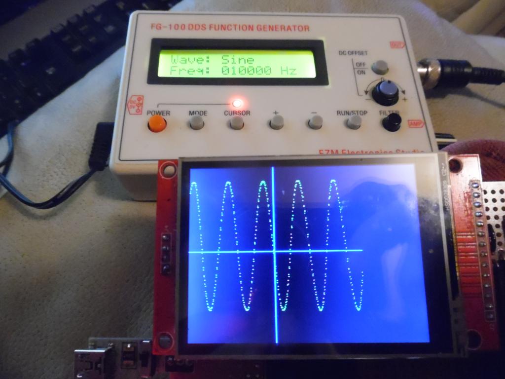

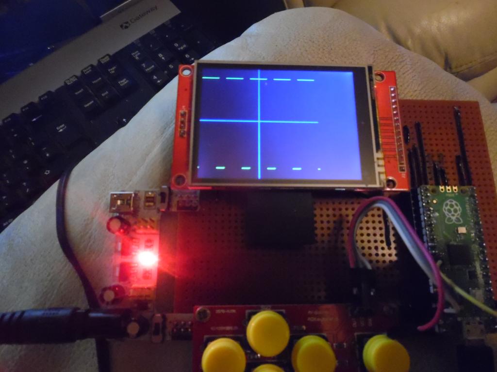

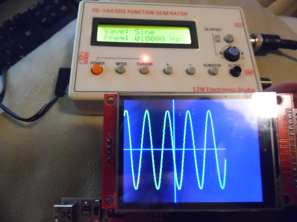

The photo with my scope prog. used the same cheap signal generator. Its output has a DC bias so all that is needed is a pot to reduce the level to suit the Pico.
Its own level control does not change the DC bias.
@Stan, speed isn't very important on my scope as does not erase and redraw the whole screen all in on go.
It only erases one vertical line at a time and drawing the new pixels on it before moving on to the next. Most of the time it is seamless.
Edited 2023-09-05 08:18 by phil99

Pixels look ok with sines,you can tell it's a sine. Dunno about squares as my usb hantek dso draws waves not plot so what a real scope look like? rhetorical.
