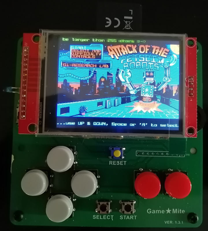

@thwill .. I already added the Controlls for Game*Mite for the Menu.

No, I don't have the game running on the GAME*MITE yet, I'm currently just using it for the intro to make sure the controls are supported
