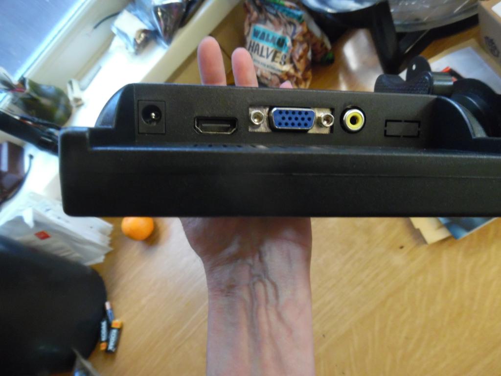

hi PhenixRising. it's a £14 car monitor that's got vga,hdmi,avi composite....but no audio. I posted it before as an alternative to a large screen lcd and cost and pins needed.
ebay and ae is dynamic so good luck finding it.

Heck Yeah...I can live with just over £20

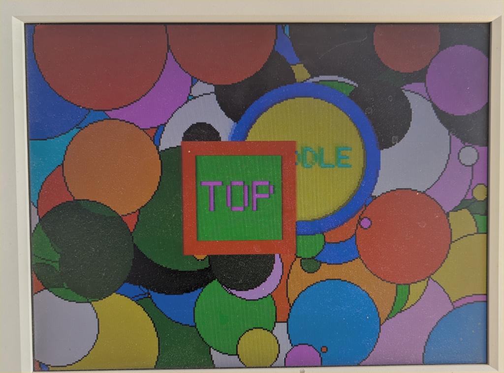

V6.00.00b6 for VGA and VGAUSB
PicoMiteVGARP2350.zip
Should fix a couple of bugs that Harm found
New functionality:
Optional second functional layer for mode 2
Optional second framebuffer for general use
FRAMEBUFFER LAYER TOP
FRAMEBUFFER CREATE 2
Then use T and 2 in the various copy, write commands
Try this example code (excuse the poor picture)
MODE 2
FRAMEBUFFER layer
FRAMEBUFFER layer top
FRAMEBUFFER write T
'Box i,MM.VRes\6*2,MM.HRes\4,MM.VRes\3,10,RGB(red),R
GB(green)
FRAMEBUFFER write l
'Circle MM.HRes\2,MM.VRes\2,MM.HRes\4,10,1,RGB(blue)
,RGB(yellow)
'Text MM.HRes\2,MM.VRes\2,"MIDDLE",CM,,3,RGB(CYAN),-
1
d=1
i=0
rr=0
x=Sin(Rad(0))*40
y=Cos(Rad(0))*40
FRAMEBUFFER write n
r = Rnd * 255
g = Rnd * 255
b = Rnd * 255
Circle Rnd * MM.HRes, Rnd * MM.VRes, Rnd * MM.HRes/7
,,, 0, RGB(r,g,b)
Inc rr,3
xl=x
yl=y
x=Sin(Rad(rr))*40
y=-Cos(Rad(rr))*40
FRAMEBUFFER wait
FRAMEBUFFER write l
Circle MM.HRes\2+xl,MM.VRes\2+yl,MM.HRes\6,0,1,0,0
Circle MM.HRes\2+x,MM.VRes\2+y,MM.HRes\6,10,1,RGB(bl
ue),RGB(yellow)
Text MM.HRes\2+x,MM.VRes\2+y,"MIDDLE",CM,,2,RGB(CYAN
),-1
FRAMEBUFFER write t
Box i,MM.VRes\6*2,MM.HRes\4,MM.VRes\3,0,0,0
Inc i,d
Box i,MM.VRes\6*2,MM.HRes\4,MM.VRes\3,10,RGB(red),RG
B(green)
Text i+MM.HRes/8,MM.VRes\2,"TOP",CM,,3,RGB(magenta),
RGB(green)
If i>=MM.HRes/4*3 Then d=-1
If i=0 Then d=1

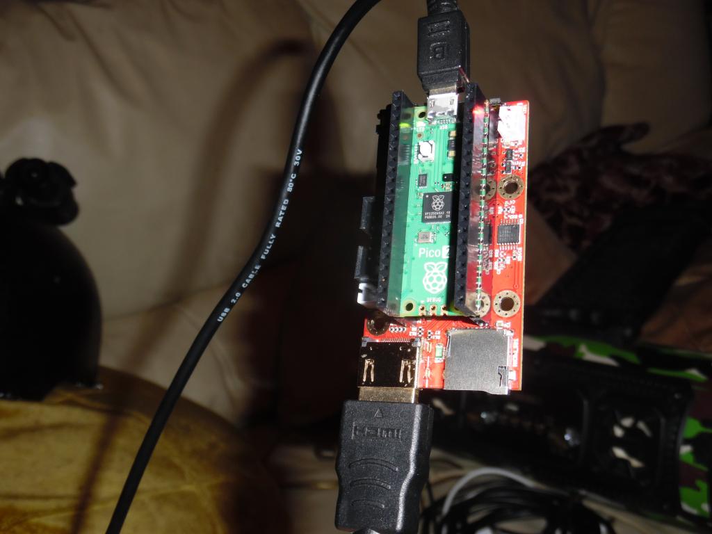

I got 2 pico2 from cpc today and soldered long lead female to male for olimex.
the olimex one went back to ili9341 board picomite2350 and all the setting it up again.
I had to set up the 2350 hdmi again but got glcd and hdmi working fine.
were the female headers a waste of time?
it seems more normal using the pico board pins than sockets
Edited 2024-09-14 05:49 by stanleyella

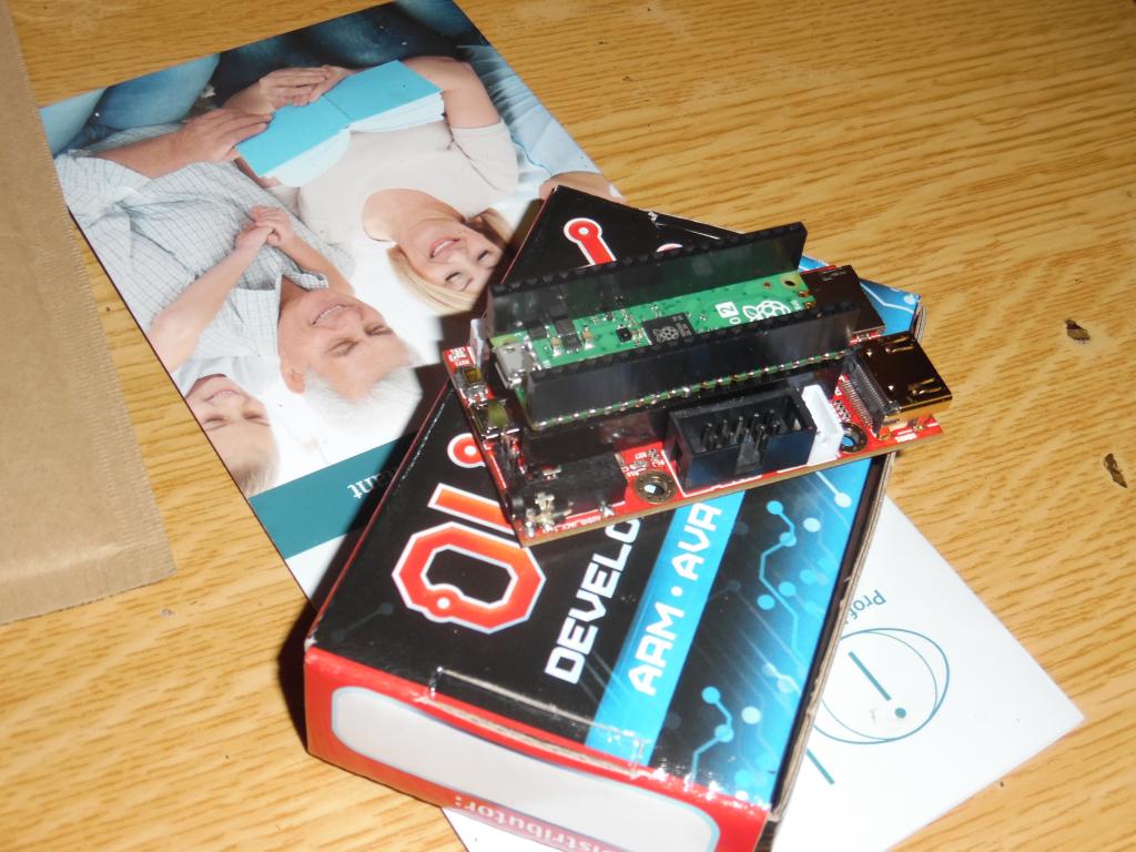

Posts: 2807
Posted: 08:17pm 13 Sep 2024
I guess posting olimex board is pissing off developers own board designs. not my intention, I hate pcb, it's cheating using cad and pcb maker :) viva vero c'est moi.
but value for money seems a tidy compact board.
I was gonna try usb version with usb to ttl and female headers seemed easier than the sockets
it's option platform "olimex" or says expecting string
not set up mod as not sure about memory,

Posts: 9119
Posted: 06:50am 14 Sep 2024
I've posted about this earlier. There are few free pins available on the Pico 2. On the Olimex board Some (I2C and SPI) are brought out to the 10-pin connector and a com port is on a 3-pin connector. The female headers are ok for convenience (avoiding the tiny connectors if you have no plugs) or for monitoring but no real use for connecting much as all the pins are allocated to something. You can connect to everything that's even remotely available (sometimes shared) using the existing connectors on the board.
