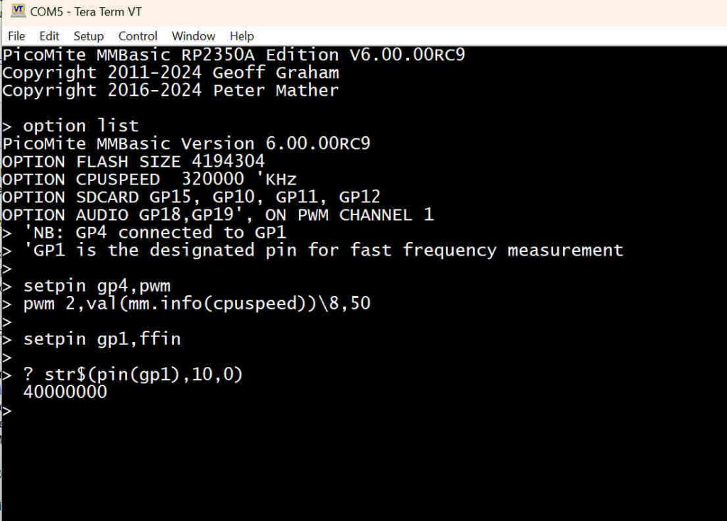

I'm supposed to be documenting but this seemed like more fun
This will only be available on the RP2350
Here is just the standard PicoMite version if anyone wants to play with it. The fast frequency functionality is fixed on pin GP1 and uses PWM channel 0 to do the counting.
I've tested up to 50MHz using an external signal generator. I think the theoretical limit is CPUSPEED/4 but can't get a good enough signal to test at those rates
PicoMite.zip

Posts: 6101
Posted: 08:40pm 19 Oct 2024
Why not use PIO?
Measures up to cpuspeed/2 and can use any pin.
Posts: 6101
Posted: 08:42pm 19 Oct 2024
Why not use PIO?
Measures up to cpuspeed/2 and can use any pin. And on 2040 also.
