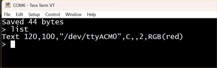

Posts: 6101
Posted: 09:40am 16 Dec 2024
PicoMite MMBasic RP2040 Edition V6.00.01RC8
OPTION SYSTEM SPI GP10,GP11,GP24
OPTION AUTORUN  2
OPTION FLASH SIZE 4194304
OPTION LIBRARY_FLASH_SIZE  20000
OPTION COLOURCODE ON
OPTION HEARTBEAT OFF
OPTION PICO OFF
OPTION LCDPANEL ST7789_135, LANDSCAPE,GP8,GP12,GP9,GP25
OPTION SDCARD GP23, GP18, GP19, GP20
OPTION PLATFORM RP2040-GEEK
> list
CLS
Text 120,10,"Geek",C,,4,RGB(yellow)
Text 120,70,"PicoMite V60001",C,,2,RGB(cyan)
Text 120,100,"/dev/ttyACM0",C,,2,RGB(red)
Fails. You cannot use "/" in a string anymore in a TEXT statement.
This seems wrong.
P.S. I re-programmed the LCD for landscape (not rlandscape), since (in my laptop) the USB ports are at the right side, and then all GEEK text is upside down.
Edited 2024-12-16 19:42 by Volhout
Posts: 11829
Posted: 09:44am 16 Dec 2024
  Quote  Fails. You cannot use "/" in a string anymore in a TEXT statement.
This seems wrong.
I can
Edited 2024-12-16 19:49 by matherp
Posts: 6101
Posted: 09:59am 16 Dec 2024
Peter,
This is strange. When I run the program it errors.
When I manually replace the first "/" with a "/" (built-in editor, replace it) it runs fine. When I save the changed program , and run it, it fails again.
As if running from the editor is different than running from flash.
Same happens when I run from flash slot.
[4] Text 120,100,"/dev/ttyACM0",C,,2,RGB(red)
Error : Syntax
Edited 2024-12-16 20:01 by Volhout
