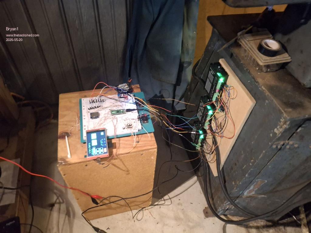

yes mate that code was buggy and the lcd did a white out, now with that code from yesterday got the X axis trying to move so playing with current and step resolution.
I did take some time to get it all wired up and here is a picture of the setup
Lyle I do hope this makes your day mate   got the X axis working on the grinder doing the calibration now and I did find putting the feedrate upto 1500 works a treat
Regards Bryan

Now what I've found got the X axis moving and calibrating is fun but getting there but with the Y and Z axis got no movement at all with both axis. Both are in holding current mode too.
Now when I jog the X axis the power supply does go just over an amp and with  switch 4 off on all 3 DM556's the holding current is 0.567 amps, when I do to jog the Y and Z axis the power supply doesn't move at all so it doesn't look like they are working.
I've checked all my wiring and nothing is out of place too

Well finally got to start on this today and silly me had the 1K resistors out on the pico 2 pins so corrected it and turned it on.
First tried the Y axis and it just moved smoothly so started on the Z xis where the next bit of fun is there to solve
With the play in the screw I'm going to put a thrust bearing under the flexible coupling as it does look like the coupling is fouling when it hits home.
Now so far today about 6 or more white outs  on the LCD and I found while playing with the DM556 when the stepper bogged the white out comes. Other times when Z wouldn't work going back to Y and X axis nothing with touch so the code hung, now I have setup the limits switch's and all work nicely so when a white out does happen I can stop the stepper code and the holding current does fall to mA when the E_Stop or a limit is pressed.
So the fun continues

Well had a few hours off as I was getting nowhere now just fired it all backup again and I'm finding with the Z axis the log+ and jog- are both going down and not eachway.
Just reflashed the pico 2 with the code and it is still the same so not sure if this is a hardware or code fault.
Anyway time to take the Z stepper motor and coupling off so I can get the Z travel wound up so it's close to the lower limit.

A couple of thoughts on the issue you are seeing:
The stepper drivers output a LOT of RF noise on both the power input cables and the motor output cables if they are not screened. This might be getting into the breadboard LCD connections and causing grief. Perhaps try sticking an earthed metal tin / box / cover / baseplate around the breadboard and see if it changes anything.
With multiple drivers being enabled together, there may be a momentary dip in the power rail, enough to upset the Pico / LCD. Try running with only the moving axis powered and see if it makes a difference.
The coil winding machine is much smaller and the Pico / LCD are in an earthed aluminium housing but until I connected a short 2.5mm2 direct from the control box to the machine I still had problems with noise / dropouts / missed steps.
There may also be a problem with your shed, I can see at least 2' square of bare concrete floor not something seen here in a while
Regards, Lyle.
