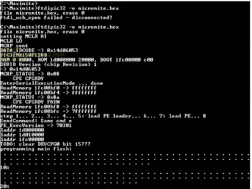

OK I keep getting
FTDI_USB_OPEN Failed - disconnected errors.
I suspect it is something to do with Zdiag.. I am not sure what I am supposed to put in the box.. it doesnt have anything detected in the pull down selection when zdiag runs..
I tried creating my own device and added the PID VID in the USB ID box but Zdiag fails when I click install.

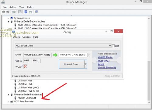

Posts: 2981
Posted: 02:10pm 14 Aug 2014
John,
I played around a bit more and `installed' a winUSB driver. now the FT chip appears as a FT232R USB UART (no port No as before)... Ok I try to do a program and this is the error I now get.
PS I will pack it up for now I am obviously too dumb to do this.
mikEdited by bigmik 2014-08-16

Posted: 02:31pm 14 Aug 2014
Hi Mick,
try connecting PGD to RSD
I'm also using windows 8.1
I got the same error, it now works
Edited by Alan68 2014-08-16
Posts: 2981
Posted: 02:49pm 14 Aug 2014
Hi Alan,
Yes that is what I have it connected to.. I suspect that my problem is either my CPU speed is too fast (i7 4770) or it is my FT232RL module. I might give it a go on my laptop, although that is an i7 as well.
As per an earlier discussion on TBS I suspect (read that as 99% certain) that my Chinese module uses a fake FTDI chip so that could also be the problem.. the only guaranteed FTDi module I have is the one I got from WhiteWizard but it doesnt have the required pins going out, not that that would stop me but it isnt my preferred option.
Did you have to set the device type first? If so what is the string it expects for device type?

Posts: 4381
Posted: 08:45pm 14 Aug 2014
Thanks, guys!
Oh, the joys of being in such a different timezone.
Good to see it works (despite "RSD"!!). Looks like no PICkit2/3 is needed :)
That's the first PIC32MX150F128B that's been used (I tried an 220F032D and a 150F128D).
It should cope with anything (famous last words) except a PIC32MZ (kinda hard to test without one plus I didn't find a PE for MZ yet).
As to whether WinUSB needs removing/tweaking to use the device as a serial port - er, I don't know. (I didn't think to try it.)
I suspect it'll work without needing to do anything, but the snag I usually find with Windows is that not quite enough info is available and that applies both to MS stuff and other things.
What I think it does it install a software switch so either the existing (USB-related) driver(s) can be used or the new one(s) can be, but never both at the same time.
I'm busy net searching for more info and will post more when/if I find it.
BTW, it runs a bit faster without -v (verify) but mine failed to flash without logging an error a couple of times (no idea why, unless it's the wiggly wires I'm using). I resorted to -v and then -R (resume) and all was well.
I'll clean up the code and see about posting it. I ended up building the Windows EXE using MinGW (32-bit) cross-compiling on (i.e. hosted on) Linux. Didn't need to change any code at all, it just compiled, linked to an EXE and that EXE runs fine.
JohnEdited by JohnS 2014-08-16
