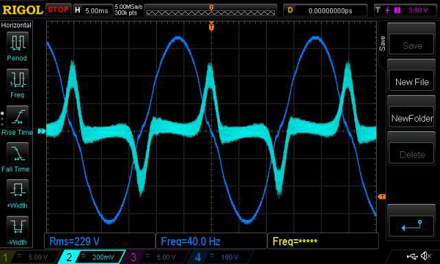

here is current and AC voltage output at 40Hz and 240V AC output
This is an extreme example.
The toroid core/secondary winding is not designed for this combination
since it clearly is saturating.
It's not going to blow up or burn out it will just be inefficient.

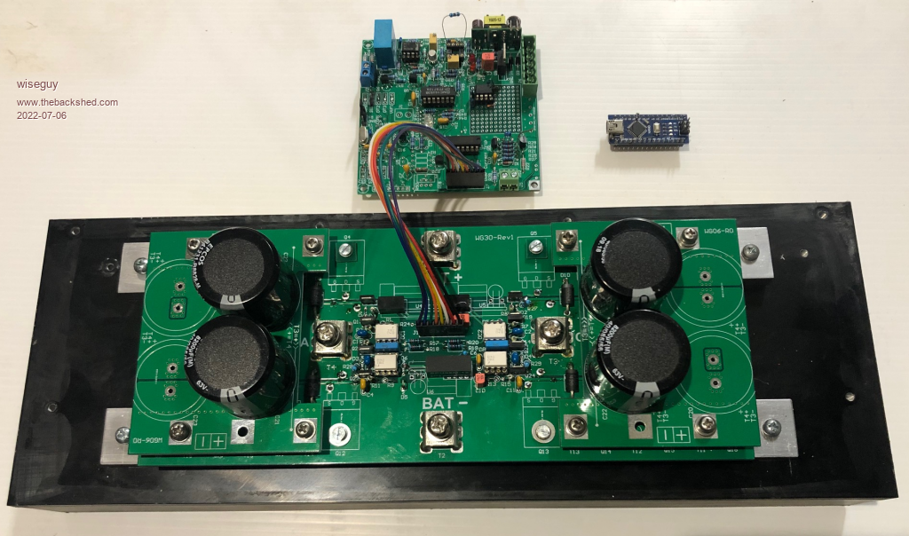

Two pictures of the new design with 16 HY5608s ready to detonate......
8010 Control PCB with 8way connecting cable.
Vertical shot to see the multiple transistor sandwich.
Cheers Mike
rogerdw
Joined: 22/10/2019
Posts: 957
Posted: 02:49pm 06 Jul 2022
That's looking great Mike, love how compact it looks. And it should be good for 5kW with the right transformer? You must be close to sorting out the 'grunt' issue, it surely can't elude you much longer.
I'm happy to visit and help get started with the winding if you do go down the track of winding a pair of cores.
Cheers,  Roger

Peter Thanks for the code mods to try out, you raised an interesting point re resonance. The choke and capacitor usually has a resonance > 500Hz. However the capacitor and transformer is the fundamental one usually discussed. When I had a single transformer its resonance for 50Hz and 75Hz was 3.5u and 2.1u respectively.
Now that I have 2 transformers in parallel I had a 4u7 capacitor across the output and I cant recall ever rechecking the resonance.  My earlier experiments had shown me that despite Warps warnings about resonance build up and becoming an issue I never had or experienced any ill effects resonating at 50 or 75Hz.  In fact there was slightly less distortion at 50Hz.
So I fired up the signal generator and checked the resonance of the 2 transformers in parallel setup I am using, it was now 150Hz which as a fluke also happens to be the third harmonic of 50 Hz.  I calculated the inductance to be 0.239H so I found another 12uF and connected that in parallel with the 4u7, I checked with the signal gen that resonance was now near 80Hz and then ran the inverter again.
The secondary current due to the capacitance on the transformer revealed ~ 1.2A flowing, the idling current went from 17.2W to ~20.5W and ramp grunt etc was essentially unchanged - slightly worse if anything but the buzz at idle was now a bit louder.  FYI, the secondary current with just the 4u7 was ~ 0.35A)
Some more calcs show me that I would need 18.8uF to resonate at 75Hz or 42u for 50 Hz.  Surely there is something rotten here to need such large capacitance to resonate ?  I did not disconnect the inverter power board but all the FETs were off so I believe it is valid to leave it connected. It was a very low level from the signal generator I'm guessing less than a volt.
The best result is still the 1000 step ramp up but I want to work out what to do with the transformer capacitor issue before experimenting further.  Any ideas or comments to help would be appreciated.
Edited 2022-07-07 22:53 by wiseguy
Cheers Mike

Ok Today I re-tested for resonance with my transformers and got quite different and more believable results. I did find a clip-lead that was open circuit and another with a dubious crimp connection. Usually I dismantle and solder clip leads as I have never trusted their wire crimp connections, don't know how this one missed out.  That must explain the crap results. The strange thing is that after working out the L from the resonance formula and adding capacitors etc all the calculations and measurements looked correct? Just goes to show, crap in = crap out..... (a bit like 1 = 2  -that sounds familiar hmmm)
The much better figures I got today is for resonance at 76 hertz = 6.7uF still high but only 36% of yesterdays calcs so I will set it at that.
An interesting discovery during the re-testing was that I got the same resonance with just one 240V winding as I did when both 240V windings were connected in parallel.  This didn't make sense at first. Then I realised the 48V spwm windings were still connected in parallel. This effectively put the 2 x 240V windings in parallel - on the same core effectively if you think about it. If I had disconnected/separated the 48V spwm windings I would have got a much different result, but the connections were buried & not easy to access.
It is like winding two bifilar windings on the same core and discovering that with one winding you get the same uH value as with the other or with 2 windings connected as one, then they just have half the R value with the same number of effective turns & inductance.  Probably useless information for most...
Now to get back to testing Poidas new codes, but with resonance now in check !
Edited 2022-07-08 19:26 by wiseguy
Cheers Mike

Boy have I been having fun today, every time I went to confirm the resonant frequency I was getting different answers and I was getting quite frustrated. I was beginning to doubt my sanity again - some others may have already wondered.....
The remanence in the transformer can apparently change the resonant frequency by nearly 100%.To confirm my findings I ran the nano code with a slow stop. Then I checked my resonant frequency and it was 76 Hz.
Next I turned on a variable source with 1V @ 0.5A and placed it across the mains winding momentarily. Bingo! the resonance peak dropped and after a re-tune the peak was now at 132Hz. I then ran the nano code & soft stop and we're back to 76Hz AT LAST I finally nailed it !!  Even 50mA momentarily injected could cause a 20Hz shift in the peak
I was using a signal generator, output 5Vp-p sine and a 15K resistor in series with the 240V winding and parallel capacitor, the CRO was across the winding.
So when checking the resonant frequency, the core should be de-magnetised/de-gaussed or you can end with a misleading answer, this was totally unexpected !  The signal generator was also capable of removing the remanence by shorting the 15K resistor and driving at resonance and reduce the output slowly to zero. Unshort the resistor and resonance is back to its lowest value, for my set up 76 Hz.
I also found that even disconnecting the signal generator whilst running & checking resonance and reconnecting it could temporarily detune the result also.  The crux (flux?) of this finding is that the inductance is reduced if there is any remanence still in the core, this will result in an increased resonant frequency value.
Last test, I shorted the transformer/choke connection points on the Power PCB (no power connected to inverter !!) whilst I still had the resonance set-up connected, this enabled the last test to be done, I tuned for the peak which was found for my setup at 760Hz. this is the mains capacitor & choke combination resonance.
Edited 2022-07-09 02:25 by wiseguy
Cheers Mike

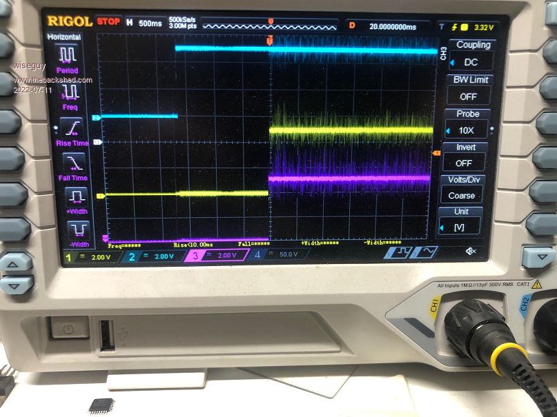

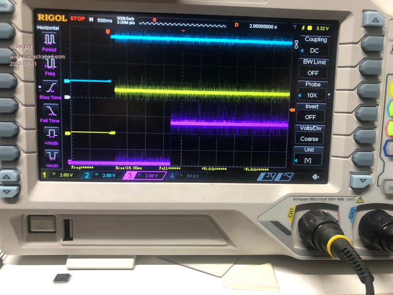

Aaron, first I installed a capacitor across the winding. The reason I looked for the resonance with a sweep was that it cuts out some guess work & tells me where the peak is now, if the frequency is greater than 75Hz I need to add more capacitance, if less I need a smaller cap. Alternatively you could use the resonant frequency formula and solve for L  using the existing caps value for C and the resonant peak for F. Then plug the calculated L back into the resonance formula using 75Hz for F and solve for the total value of C required - I proved that it does work.
I have good news and I have bad news.
The good news is I modified the code and it finally started quietly with minor grunt & overshoot and very brief hunting whilst it settled, using the 1000 step code.  I then tried to modify the 1000 step original code to see if I could get it to start and settle faster, still accepting the low level grunt.
The bad news is a (good?) cure was found, but unfortunately the patient died in the process of trying for even more improvement
I am embarrassed to actually say what I did, cause Poida will point out what I did was probably really stupid and couldn't have fixed it, so okay here goes, fess up - get the dunce hat ready.....
I changed sst = 0 to sst = 100, I had been reasonably happy with the quieter grunt but I wanted to speed up the ramp. I reasoned that if the ramp was now 1000, I could save 100 steps of time at the beginning of the ramp as there was not a lot happening down there.  In fiddling with the sst number some unusual things happened, one of these was a very loud bang, but we'll get back to that later. Poida rolling on the floor laughing about now
When I changed sst = 200 it appeared to change the timing between when D8 got the start signal and when D5 enabled the outputs ( it actually behaved as though D5 was already high before D8 told it to start).
So ok I then tried sst = 100 & voila grunt was totally gone, a very stable start up and no dithering at the end of ramp, life was looking good - briefly.
Then feeling gung-ho/smug I decided to try the other code;
2022-07-07_093602_nano_1_v7_no_bessel_smooth_stop_50Hz_control_loop
Which only had 250 step start up so I went for a smaller sst value to see if it helped with the grunt on this codes faster ramp - what could go wrong....
I tried sst = 100 but the D5 issue was happening again so I reduced to sst = 80 and tried again, the result was a fairly large grunt - bang event.  This time though I need to totally rebuild the power board, after the previous bang event & repair 6 odd months ago, whilst soft starting the inverter with a compressor on the output, I would not trust it for further rework.
It served me well and I was using it as a test bed before I hooked up my latest power board to the nano, I really wanted to solve the grunt if possible and decided on sacrificing the original inverter for experiments.
So Poida why does sst = 100 make my inverter start with no grunt and no slight overshoot or slight wiggles whilst settling, it just rose and sat solid with a gentle hum.
I thought sst was a count up to 1000/1001 starting at zero normally - what did my sst = 100 actually tell it to do ?
The failure mode was very similar to the first failure, one of the 4 high side FETs had become shorted and saved its 3 mates, but when the bottom FETs turned on the dead upper FET passed enough instantaneous current to despatch all 4 low side FET's  to FET heaven (or is that FET hell) any way I'm in the process of fixing it up again for more torture.
There is a bit of a coincidence going on, due to the inverse optocoupler I deduce that shoot through is not the problem and that trying to drive a saturated choke/transformer is the likely culprit. A FET on the high side died in both cases whilst ramping current to the choke/transformer whilst grunting. It is reasonable to guess it (they) exceeded their max current rating and one was faster to sign off and  take one for the team, before then taking out the whole other half of the team when they were next commanded  "on".
Last query Peter, the 250 step code I believe takes 5 seconds, I expected the 1000 step code (un modified by me) to take 20 seconds but it only took 10 - something that I didn't quite get. It's probably something to do with 50 versus 100 Hz steps......
After sleeping on it and then reviewing what I did against what I should have done.  I offer the following advice - as Poida said somewhere - they are your FETs !  (respect them)
So the moral of the story is after making software changes - especially if software is not your forte -  it would be wise to analyse the outputs with a CRO first and maybe a small output test stage and use a current limited supply and small bulk capacitors, before taking out a heap of FETs and the ensuing grief of repairs.
Edited 2022-07-10 15:49 by wiseguy
Cheers Mike

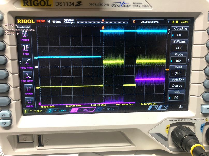

poida
Joined: 02/02/2017
Posts: 1497
Posted: 07:53am 10 Jul 2022
aw Jeez Wiseguy. you broke it.
last question:
You are correct. I made a 1000 step version and that uses 100Hz updates
so it needs 10 seconds to get to PID change over.
The 50 Hz update version used 250 steps and needs 5 seconds (250/50..)
before PID takes over.
To change the step number here is what you need to do:
for instance, if it's 250 and you want 100 then
find all the "250" in the below code and change to "100"
find all the "251" and change it to "101"
find all the "250.0" and change it to "100.0"
void loop()
 float ch0;
 // sample channel..
 // In the past, I low pass filtered this. not now, no need thanks to active LP filter on Vfb
 ac_output = (float)analogRead(ADC_OUT) / 1024.0; // scale 0 - 5V to 0.0 to 1.0
 if(uf == 1  )    // this will execute at 100Hz
     {            // it runs at near zero volt crossing of AC output
     uf=0;
     ac_setpoint = 0.55;       // for same Vfb as EG8010. change AC output voltage via Vfb voltage divider trimpot
     if (oen == 1) sst++;      // slow start. If output is enabled, keep starting up. sst = output pwm% or approx. voltage.
     if (sst > 251)sst = 251;  // stop increasing when sst has got to the end of slow start. when = 251, this enables PID. See below..
     if (oen == 0) sst--;      // if stopping, slow stop
     if (sst <= 0)             // once fully stopped, no more changes to sst needed
       sst = 0;
       cbi(PORTD,5);     // pull IR2184 shutdown LOW to disable gate drive output
     else
       sbi(PORTD,5);     // pull it HIGH, to enable output
     if(sst > 0 && sst < 250)     // slow start timer counts to 250 with gentle ramp up, then switches over to PID control. (gulp!)
       {                          // sst can increase or decrease, giving the slow start and slow stop.
       if (oen == 1)              // slow stop? I think of it as de-gauss
         if(ac_output < ac_setpoint)
           pwr += 1.0/250.0;     // bang-bang control, should AC output reach setpoint prior to PID.
         else                    // During slow start need to ensure output is tracking setpoint
           pwr -= 1.0/250.0;     // should output get close enough to matter.
       else
         pwr -= 1.0 /250.0;      // this will execute in slow stop
     if (sst == 251)       // once sst = 251, run PID. the above bang-bang control will NOT have executed, because sst = 251
       Setpoint = ac_setpoint;
       Input = ac_output;
       do_pid();
       pwr = pwr + Output;
I could or maybe should have already provided a setting via the menu to
set the number of steps of the soft start/stop AND a setting for the
control loop update rate. I thought there would be no need for it.
possibly you did not change all of the above and so the soft start did not progress to output nearly equal to setpoint which is when I only ever want to switch over to
PID control. And maybe D5 was enabled/HIGH at a bad time such as a sudden increase in PWM duty. I need to be the fly on the wall when you are doing your voodoo on the bench. I promise not to heckle.
Unmodified nano_1_v7_no_bessel is bullet proof. I run this on my home inverter
and it has restarted nearly daily for 3 years now and it still runs great.
I can't help recalling the air compressor tests I did with a 4 x 3 FET inverter
running nano_1_v7.. and seeing it do 12kW. No point to  be made, it just came to mind then. When you get it right, you can move mountains with this system.
I did the most testing on a 4 x 1 FET power board. 1kW load testing and lots of
looking at Gate drive details. This board had about 6 x 3900uF caps on it
and a current limited PS. The caps always would blow a FET if I got it wrong.
But so easy to diagnose and repair.
did I answer what you needed?
I'm tired. Had a huge day on the mountain bike, stopped riding due to no more strength in my fingers and I could not hang on. I ride until I can't, it's so much fun.

Posted: 12:29pm 10 Jul 2022
  poida said  aw Jeez Wiseguy. you broke it.
Nope - not even close :(  but thanks for trying - I will try to ask more concisely
I wanted soft start to count up to 1000/1001 not 100/101
I tried to get soft start to begin from count 100 up to 1000/1001 (saving 100 steps low down)
So I changed SST value from SST = 0 to SST = 100 in the 5th line below headed by **
note: I thought most //comments of 250/251 should have been changed to 1000/1001 ??
I never touched anything else.
The code below started the inverter perfectly no grunt whatsoever, best start ever repeatedly.
But changing back to SST = 0 grunted again.
Obviously it seems my setting to 100 changed something for the better - but what ?
Also making SST = 200 appeared to make D5 high the second I set D8 to go - from the code I couldn't see why.

I have rebuilt a new power PCB but before I hooked it up to the Nano I wanted to run some testing as I was sure there were some issues with D5, the enable for the outputs.
The transformer is ~31.2V at ~235V out.
It was intended to still provide 235V at 44V which is the low voltage cut out.
If I did it again I would probably go for ~33V and be happy with a bit of droop below 46V as it approaches 44V.
The following CRO pictures tell an interesting story (apart from my lousy/noisy ground).
The Purple trace is the D8 input that tells the Nano "please start"
The Yellow trace is D5 & its supposed to go High at ramp up start after D8 has been told "go".
The Blue trace is just the 5V coming to life after turn on, for relativity.
This is the 1000 step code as received
This is the 1000 step code with SST = 100
Note D5 went high for 1 second immediately the 5V rail went active & before D8 was told to "go"
This is the 1000 step code with SST = 200
Note D5 went high after Power up and just stayed high
I did say yesterday that it behaved as though D5 was being enabled before the start command.
Poida this is why we pay you the big bucks, to solve all the weird problems
Its probably caused by a missing comma or = sign or something simple but the results are a bit bizzare.
Thanks for your comments on what I did and agreeing it should have had the effect I wanted - it looked reasonable to me but I am software challenged and software is easily broken.....
The really sad part is that the middle picture with the premature enablation (is that a word ?) is the one that doesn't grunt and starts real nice
Edited 2022-07-12 00:31 by wiseguy
