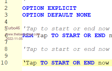

Seems like the single quote is wrong or misunderstood?

Hi Bill,
Thanks.
I've got the syntax set to Picomite (as it should be) but it also does it for others.
I've tested by changing a ' to REM and it still does it.
Does it do it for you? (so to speak?) {Edit: Oops, I see that I am alone . . }

This is what I see:

Hi Bill,
What I'm suggesting is that we should see:
REM Tap to start or end . . .
or
'Tap to start or end . . .
and not:
'Tap TO START OR END . . .
(I'm suggesting text colour and case after a ' or REM, without MMEdit automatically changing the case and colour. I can't do colour here)

Yes Andrew, I agree. But I don't see:
as you can see from my photo. REM does not seem to work correctly in my copy of MMEdit5 but the:
  Quote  'Tap to start or end now
was a copy and paste from your post.
Did you type the "'" from within MMEdit5 or copy and paste from a word processor? I can get the same result as you if I copy and paste from LibreOffice writer but the "'" is different:
if you look closely.

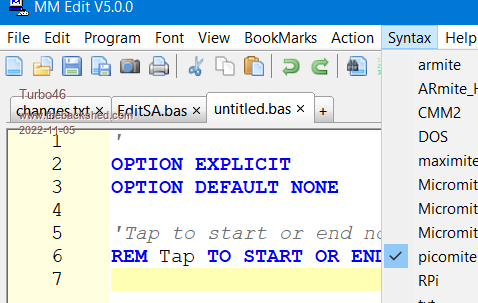

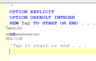

Posted: 01:56am 05 Nov 2022
There is something fishy going on.
MMEdit should (and does for me) recognize the single quote as a comment and leave the rest formatted as such.
MMEdit doesn't recognize REM as a start of comment so in that case, it will show keywords in the comment.

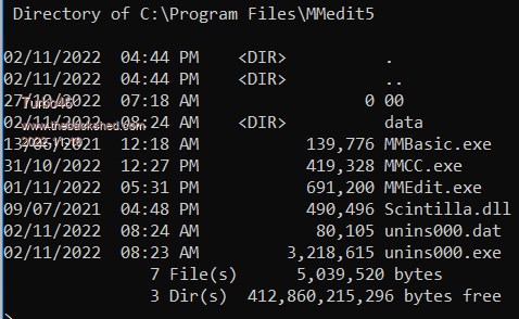

One thought.
Did you get caught up in the new scintilla.dll saga from a few days ago
  Quote  Urgent!
If you downloaded MMEdit in the last 24 hours or so, you may have a buggy dll file.
Windows 64bit users should check the program folder and see if Scintilla.dll is 479k bytes in size.
If not, there should be a file Scintilla1.dll there as well with the correct size of 479k
To replace the buggy dll, delete Scintilla.dll and rename Scintilla1.dll to Scintilla.dll
32 bit Windows users and Linux users don't have to worry.
The packages that are now on my website have the dll file replaced so you could just download it again.
I think Bill has the answer. Pasting from pdf etc can use "smart quotes" which aren't very smart.
Try "program/remove non-ASCII characters" and see if that fixes it.
If you are pasting from external sources, Paste as ASCII will do no harm and catch this sort of thing, if that is the problem.

Bill & Jim,
I think Scintilla problem & will test further - can't stop now.
Andrew

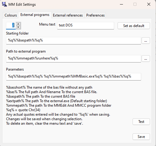

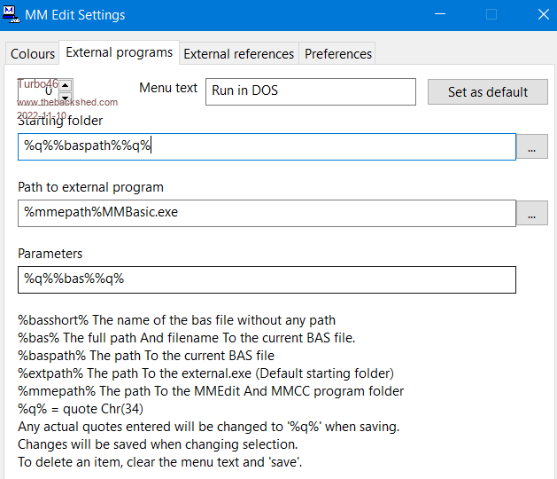

Sorry Jim, I've a little problem running a program in MMBasic DOS that needs to load other files from the same folder. The preferences settings suggest to me that the starting folder is the folder in which the program is located.
When the program crashes because it can't find the file(s) to be loaded, I ran the FILES command and it appears that the working folder is the MMEdit5 one.
Somehow MMEdit found MMBasic DOS and put it there? That might get confusing if there is ever an update to MMBasic DOS but anyway, how do I get the basic program to run in the folder in which it is located?
Bill
Posts: 6603
Posted: 06:06am 10 Nov 2022
Something strange going on Bill.
The copy of MMBasic.exe in the program folder is correct. I put it there so new users could run it without having to jump through too many hoops. When there is an updated version, just change the exe path to the new version.
Now to the problem.
MMBasic for Windows correctly sets the starting folder.
MMBasic for DOS no longer sets the starting folder and uses the folder from the calling program instead. That has not always happened so I expect a subtle change to Windows.
Until I come up with a way to get MMBasic for DOS starting in the correct folder, the simplest work-around is to use CHDIR at the start of your program to set the current folder to the one you desire.
I hope i don't have to resort to batch files.

Posts: 6603
Posted: 06:59am 10 Nov 2022
I found that MMB4W was remembering it's own starting folder rather than listening to my command so it looks like all exe types now have a problem.
Copy the batch file in the attached zip to your MMEdit program folder and setup a new 'deploy' with the following settings:
runhere.zip
I will change MMEdit to use the batch with the original settings. It is too complicated with the 'temporary' fix.
It should get you working again.
You can save a bit of typing by putting this in your MMEdit.inf file:
Ext2 = test DOS|%q%%baspath%%q%|%q%%mmepath%runhere%q%|%q%%baspath%%q% %q%%mmepath%MMBasic.exe%q% %q%%bas%%q%
Add it with MMEdit shut down and change Ext2 to Ext1 or whatever to keep the sequence correct if needed.
Edited 2022-11-10 17:02 by TassyJim

Posts: 6603

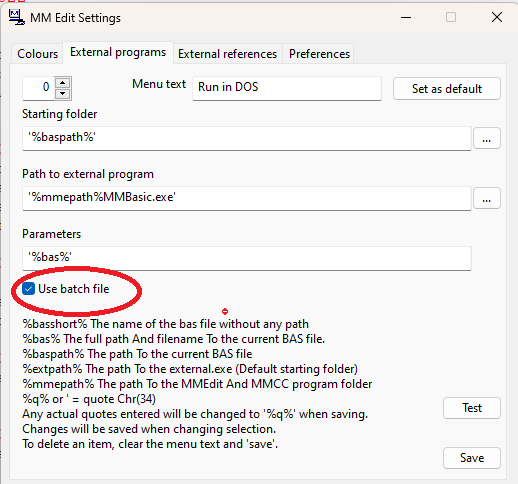

Posted: 09:08pm 10 Nov 2022
I have just updated the Windows packages with a fix for the external program starting folder bug.
Action settings now have an option to "use batch file"
This relies on a simple batch file that uses 'CD' to change to the required folder before running the external program.
You can now also use a single quote instead of %q% to signify a double quote in the settings. This is a lot easier to read. %q% is still valid and should be used if you have a single quote that you don't want changed.
Existing users will need to edit the settings (Action/Edit List...) to tick the "Use Batch file" box if they are having problems with the starting folders.
