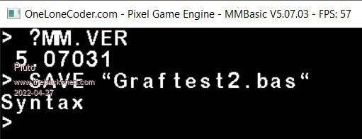

Posted: 07:22am 27 Apr 2022
V5.07.03b10:
Running a testing program "Graftest.bas". OK
Trying to save a copy of the program as "Graftest2.bas". NOK
Program stored in the default MMBasic directory.
I am probably doing some stupid mistake. Need advice.
/Fred
Posts: 12062
Posted: 07:32am 27 Apr 2022
SAVE is not implemented as it has no logical use. Files are saved when exiting the editor or when using autosave. For your use you can use the copy command or the "save as" in the editor (ctrl-W)
NB - doesn't exist on CMM2 either as both implementations are "disk-based"

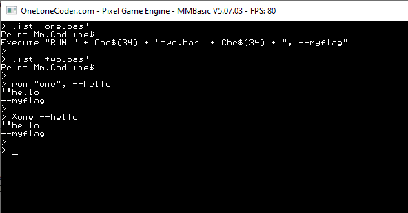

Hi Peter,
I'm back on MMB4W for a couple of days, here's a bug for you that I'm suprised I didn't notice previously:
Observe that the hyphens passed from the prompt are not handled correctly (I'm guessing they are being converted into tokens), but those passed via EXECUTE are. I vaguely recollect that the CMM2 had the same issue but that you kindly fixed it for me.
Edited 2022-06-03 19:28 by thwill

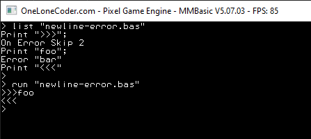

And here is another one for you:
Observe the spurious newline that has been inserted as a result of throwing and skipping an ERROR.
Edited 2022-06-03 19:56 by thwill
Posts: 12062
Posted: 10:42am 03 Jun 2022
Will fix first , the second is too obscure to waste time on - sorry
Posts: 4405
Posted: 11:59am 03 Jun 2022
  matherp said  Will fix first , the second is too obscure to waste time on - sorry
Pretty please .
I believe the offending line is in Commands.cpp:
void cmd_error(void) {
   char* s, p[STRINGSIZE];
   if (*cmdline && *cmdline != '\'') {
       s = (char *)getCstring(cmdline);
       if (CurrentX != 0) MMPrintString((char*)"\r\n"); // <<<<<<<<<<
       strcpy(p, s);
       error(p);
   else
       error((char *)"");
IMO cmd_error() should not be printing anything directly, that should ony be occurring in the implementation of error() and even then only if not skipping errors.
Apologies that I can't fix/build/test myself and send you a patch. My Windoze machine requires an older Visual Studio tool-chain installed for the purposes of my dayjob and I'm not accomplished enough with the Windoze tools to get MMB4W building with it.
Edited 2022-06-03 22:08 by thwill
