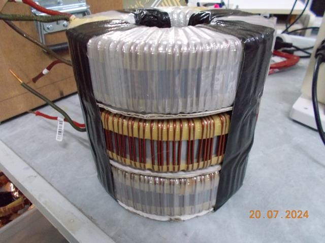

  KeepIS said     Surprised that I got the three Toroids done a lot faster then I remembered taking the last time, then I recalled that I had carefully unwound the 230v AC windings back then, in this strip down, I cut the windings off as I had no use for them
Gulp What!!!  You just cut it off  ... that's terrible.
I know it's quicker but I couldn't do that, I'd feel too guilty.
Anyway, what were these toroids from in their previous life. And what diameter is that wire?
And when you fit them together, do you put anything in between to protect the windings from each other  ...  especially where there are high spots pressing together.
Cheers,  Roger

Best to use some high temp epoxy potting compound to keep them from vibrating too much and causing a short.
I use high temp pvc with adhesive to wrap up the secondary winding. Works really well. Some people call it high temp mylar wrap.

2.56mm on the dig caliper.
Yes, two thick compressible circular separating sheets, thick insulator on the base.
Center open, convection and forced air cooling when/if needed. On both Toroid stacks, 6 toroids in all

  Cpoc said  Best to use some high temp epoxy potting compound to keep them from vibrating too much and causing a short.
The existing three don't vibrate, quite as a church mouse except for the very occasional heatgun, or my Wife uses a hair straightener, both caused from a Diode in series with AC on LOW. Yes, I've read about micro vibrations, but that is a whole other discussion when you look into it.

I can see you used some high heat tape. It should not be problem.

BTW: They will be partly wrapped with fiberglass tape when stacked 3 high.

BTW in case it's not obvious, I did not wind these, they are the existing windings,  93VAC and wound first on the Core in these Toroids.

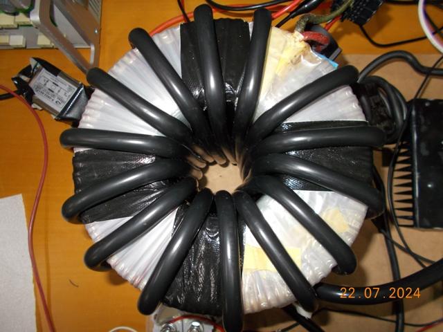

Test setup ready for a 14 turn primary which I pick up in the morning, basically a 200mm X 200mm round lump of copper and steel, a bit taller when the primary is fitted.
I'll check the output against the existing toroid stack, if it's in the ball park and other tests pass, I'll do the final assembly of the transformer.

Very happy, the 2nd 3 stack transformer with 14 turn primary has exactly the same AC input to output voltage and power reading on the Variac.
Found some different low cost toriods for the chokes. A larger hole and similar size, they needed an extra turn for the same inductance, I still have to test saturation current to be sure they will do the job, I can always use an extra core if needed at the price.

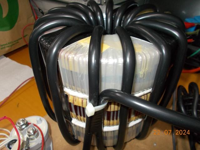

Picked up the cable for the chokes this morning as well as the Primary winding for the 3 stack transformer, it took just under 8 meters of cable for 14 tight turns.
EDIT: Now running in the test inverter, and with incorrect lower value chokes it's idling at 23 watts @ 241vac, hopefully I'll get the chokes tested and running tomorrow before a forced lay off, and hopefully only for a few days

This 2AWG 35mm2 cable is rated at 188A continuous. The Weld Flex rated at 220A is a bit thicker and did not feel as flexible in cold weather, decided to go with first cable.
Each toriod will only be required to handle around 3kw continuous, and that would be for around 1 hour a day worst case, so a total of 6kW continuous for 1 hour, the current single 3 stack inverter can do that, and start huge Induction motor loads.

As with the first 3 stack toriod, a heat gun on low heat is used to warm the cable on each pass through the toroid, especially each bend, it sure makes it easy to pull straight and get tight curves around the toroids, and shortly after removing heat, the cable holds shape and does not try to unravel.
