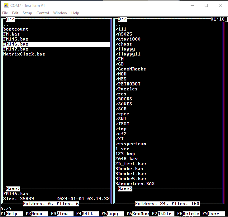

Installing the Perfect_DOS_VGA_437 font partially solves the problem of displaying the pseudographics symbols of the PicoMite encoding.

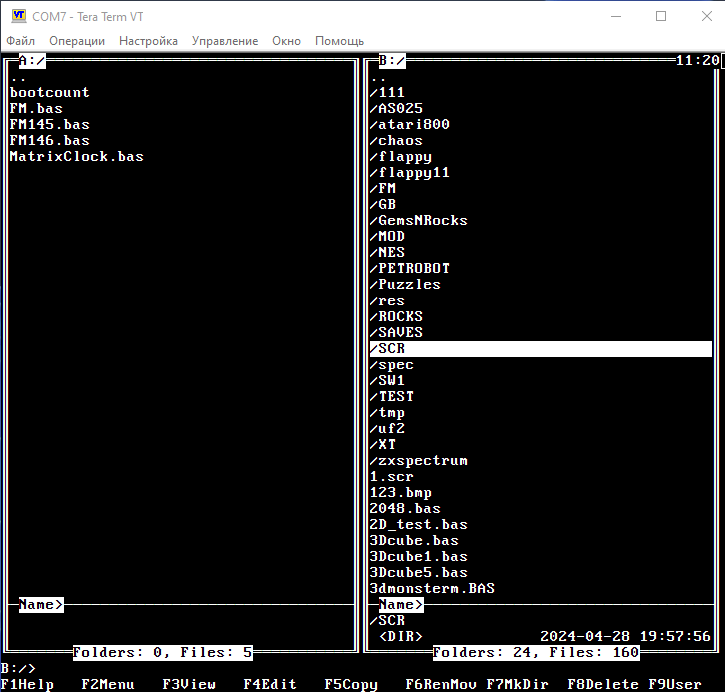

I am talking about a simple version of FM without adaptation for VT100.
For me, if I turn on the "Terminal" font in TeraTerm, everything looks like this.
Maybe it's a question of choosing the right encoding for the country, I don't know, but with the installation of a new font for DOS, it solved the problem with pseudographics for me.
My desire to make all the symbols of the PicoMite font appear the same in the Terminal on the computer.

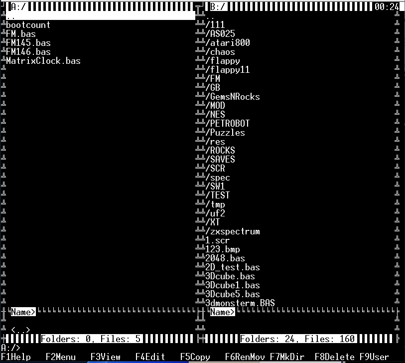

@Vadim:
  javavi said  ... I don't know, but with the installation of a new font for DOS, it solved the problem with pseudographics for me. ...
This is what your FM145 looks like with the 437 (Perfect DOS VGA 437 Win.ttf) font:

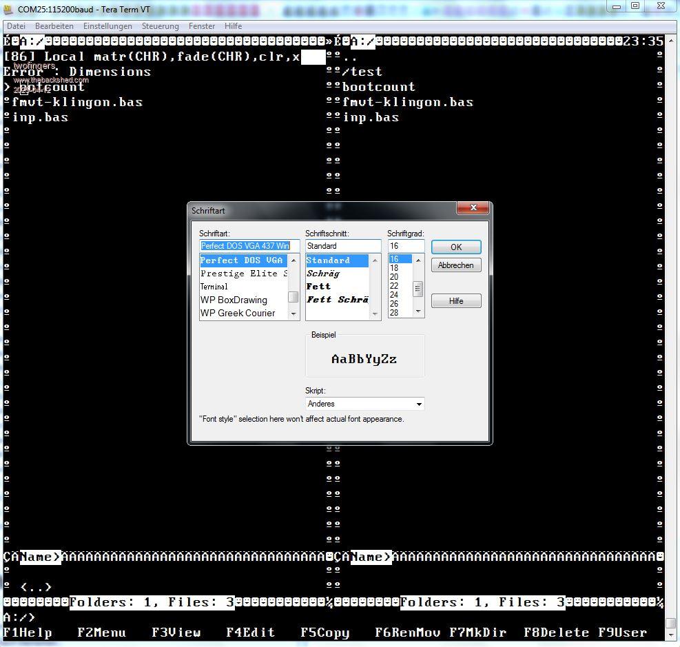

This is what your FM145 looks like at mitr with the 437 (Perfect DOS VGA 437 Win.ttf) font:

  twofingers said  What I'm looking for are clear instructions to achieve a specific result.
Try setting up TeraTerm with this DOS font size 12.
Additionally, configure the encoding:
Setup -> Additional settings... -> Coding: recive English/ISO8859-1
I managed to achieve the result with this encoding

  javavi said  ... configure the encoding:
Thanks Vadim, unfortunately, I don't have this setting yet (Teraterm 4.85). I found the setting in V5 (but I don't like V5 very much). I won't be contributing much more anyway, because the VT100 version is sufficient for bare Picos boards, and I have few ideas for improvements for VGA.
