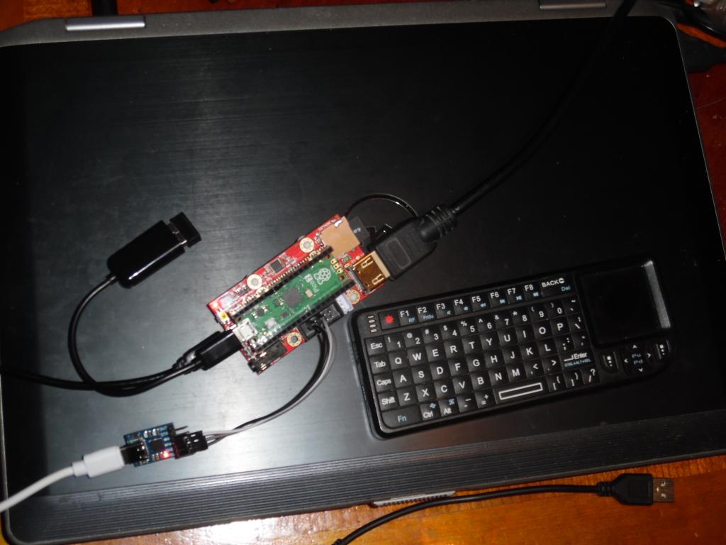

Posts: 2807
Posted: 09:48pm 25 Oct 2024
this was posted to show pin use
MM.Startup
end
Sub MM.Startup
Local Integer m, n
For m=0 To 28
 n = MM.Info(pinno "GP"+Str$(m))
 If MM.Info(pin n)="OFF" Then SetPin n, DIN, PULLUP
 print n,"GP"+Str$(m), MM.Info(pin n)
Next
End Sub
but get
RUN
1     GP0     DIN
2     GP1     DIN
4     GP2     DIN
5     GP3     DIN
6     GP4     OFF: Boot Reserved
7     GP5     DIN
9     GP6     OFF: Boot Reserved
10    GP7     OFF: Boot Reserved
11    GP8     OFF: Boot Reserved
12    GP9     OFF: Boot Reserved
14    GP10    DIN
15    GP11    DIN
[8] n = MM.Info(pinno "GP"+Str$(m))
Error : Invalid pin
Posts: 3323
Posted: 10:10pm 25 Oct 2024
My guess is HDMI pins are not treated as GPIO pins.
To test this idea, at the command prompt type:-
? MM.INFO(pinno GP12)
then
? MM.INFO(pin GP12)
If either gives an error modify MM.STARTUP to exclude the HDMI pins from testing.
I don't have a HDMI setup so can't test.
It works without error on VGA
Edited 2024-10-26 08:19 by phil99

Posts: 8966
Posted: 06:31am 26 Oct 2024
Correct - HSTX (HDMI) pins are not GPIO pins and are not available. The Pico has probably disconnected them from the GPIO pin matrix and connected them to the HSTX peripheral internally so they no longer exist. :)
Posts: 3323
Posted: 07:51am 26 Oct 2024
Thanks for confirming that Mick.
Stan, try this version for the Olimex HDMI board.
It should skip over the HDMI pins, but as I don't have one it is untested.
Sub MM.Startup
 Local Integer m, n
 For m=0 To 28
  if m=12 then m=20
 Next
End Sub

Posts: 2807
Posted: 02:18pm 26 Oct 2024
  phil99 said  Thanks for confirming that Mick.
Sub MM.Startup
 Local Integer m, n
 For m=0 To 28
  if m=12 then m=20
 Next
End Sub
Phil. results, get one, they're tidy boards.
RUN
