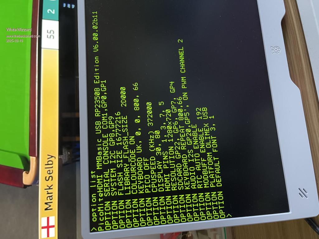

Posts: 2991
Posted: 08:40pm 15 Feb 2025
I am confused by some contradictions and now need clarification.
What does OPTION DEFAULT MODE do/set?
My understanding is that on power-up it will switch to this mode (with the exact pixel resolution dependent on OPTION RESOLUTION). My understanding is that this mode can be changed by using MODE x at command prompt.
What does MODE do at the command prompt?
My understanding is that this will switch to mode x until changed either at the command prompt or changed from the program (and upon exit of a program, the mode will remain as last set by the program)
What mode does the EDITor use?
You have previously mentioned it switches to mode 1 but if this is the case, why mention above that my default mode being set to 3 will mean I won’t see the mouse highlighter?
I need to ensure that I understand the above fully as  currently I am performing thorough testing which is required prior to several magazine articles I am writing in the very near future.
It is vital I get a stable hardware setup, understand any limitations (hardware and software), and am aware of any ‘gotchas’
Posts: 2991
Posted: 08:55pm 15 Feb 2025
Think I need to ask slightly differently:
With having set OPTION RESOLUTION 1280, is there anything I need to do/change/set to get to see the mouse-highlight in the editor?
