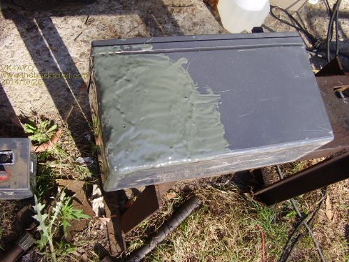

HI Isaiah
A photo of the resealed battery, I had to do it twice as there was a leak through the porosity but it looks OK now.
I have refilled all four damaged batteries and now included them in the battery bank for a equalization charge.
All the best
bob

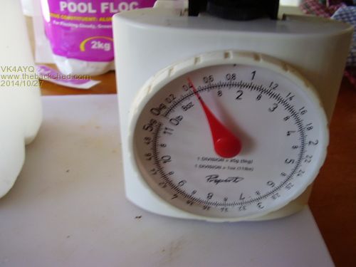

Battery number one is now filled with ALUM electrolyte but it dosen't look to promising as it is only taking a small conditioning charge, the indicated volts off charge 11.5 volts but Not much capacity at this point, according to the experts it takes four or more cycle charges to get the capacity up so once again time will tell, I will leave overnight tonight and do another cycle tomorrow.
Preparing the electrolyte.
I used a four liter bottle of water to 400 grams of ALUM by weight.
I heated the water to make it dissolve the ALUM faster.
On filling the battery bubbled strongly and evenly across the cells, one hour later it settled down to a slight bubbling across all the cells, I then put it on the trickle charger and all the cells started bubbling evenly again so it is all active all that remains to do is to cycle it a few times and see if I can get any worthwile capacity.
All the best
Bob

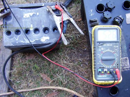

Hi All
I have done one equalization charge on both batteries, battery number one shows a high internal resistance as the charge went up to higher than expected voltage.
Battery number two showed a better absorption rate of 30 amps at 18 volts showing it is the more active of the two.
When I was doing the flush cycle today I was amazed how much grunge came out of it it makes you wonder haw much plate material is left
After sitting on a trickle charge for a few hours both batteries where showing 12 volts at rest. Finding a suitable load was a problem as I tried a 150 Watt driving light of my truck but that was too much load initially, so I reverted to a 10 watt LED work light, on battery number one the voltage loaded with this light sagged to 9 volts and kept slowly decreasing before stabilizing at eight point five volts and sat at that for all the afternoon.
Battery number 2 was put under load about 5;30 PM and is still running I think it will go all night as it sagged to eight point five volts and is staying there.
A few more discharge / charge cycles on the trickle charger will tell the real story.

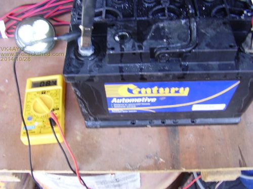

Hi All
Battery number two run the light for eight hours overnight and went down to seven volts where the light dropped out, so it seems that the best output voltage is between eight point five and seven point five volts.
Battery number one sat on nine volts without load overnight and this morning run the light for several hours. On both batteries there has been a increase of activity after the first cycle but it brings into question as to how useful these batteries would be with the low voltage, before they had none so it proves it is an improvement but is it a useful improvement for all the work gone into them.
I think that the concept of getting an old battery from the scrap heap and making it into a new useful battery is busted, as both these batteries where from the scrap heap, both nine plate 50 AH batteries and the best they demonstrate so far is low voltage and around 10 AH for battery number two and 4 AH for battery number one, a few more cycles may improve the AH capacity but the lower operating voltage limits their usefulness to running LED lighting system or some other low voltage application.
I will try a couple of non dead batteries that are working OK but will not start the mower and the car, I am using these on my water pump solar setup so that will be interesting to see if they can go back and do the same job or better once converted to ALUM.
All the best
