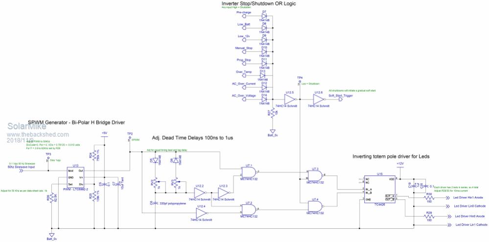

Hi Wiseguy, here is part of the circuit that I use to generate dead time, uses a few logic gates and gives you independent control of leading and trailing edge dead-time signal; thus you can set the correct dead-time at the gates of your final power stage taking into account any differing delays introduced by the high speed opto-couplers, drivers etc.

Solar Mike shows a way too, with discrete logic to give complimentary outputs from a single input.

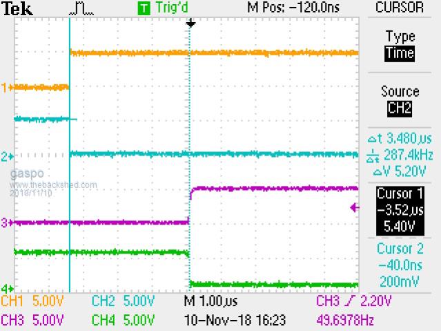

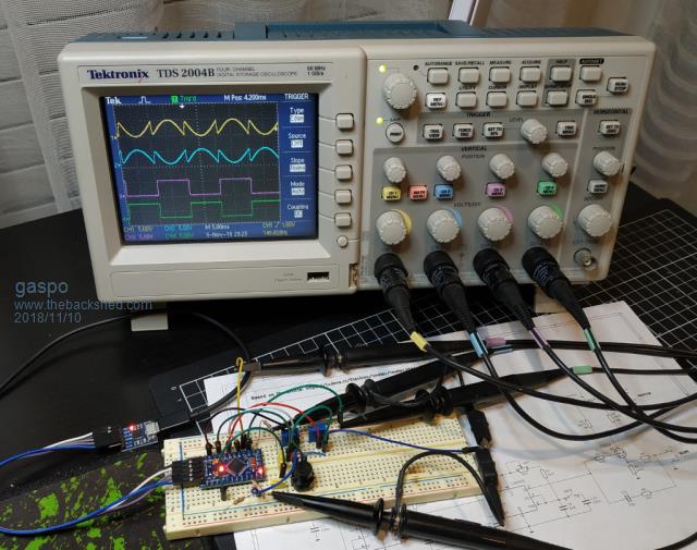

Here's Arduino 328P 4 lines mod simulating EG8010.
2018-11-10_002954_uno_inverter_eg8010.zip

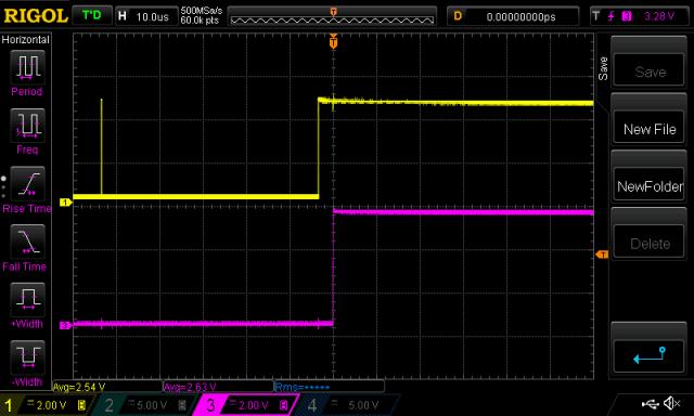

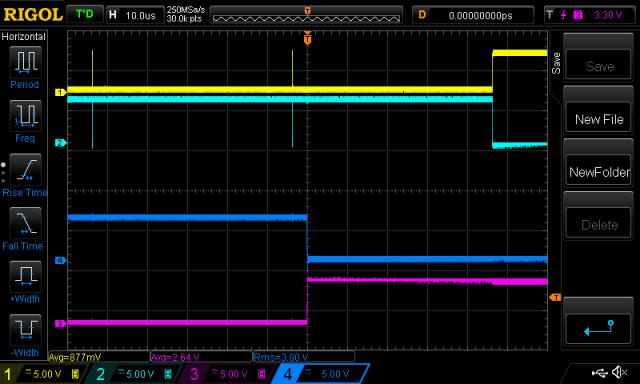

Dead time will be provided by gate drive circuits of course. I wonder how your prototype will turn out, I can't wait to see.
One thing I found with the 50Hz / 20kHz combination is that I could never obtain the
exact timing of the 50Hz signal with respect to the SPWM as the sine wave passes through zero. Maybe 5us difference was the smallest I could achieve and that was with some very unclear ordering of events in the 20kHz interrupt block.
The bigger the timing mismatch of this transition from high/low or low/high, the bigger the wobble in the output AC frequency.
This transition in effect delivers a pulse to the primary, of the duration of the mismatch - exactly when we want to drive a zero voltage (it's the AC sine waveform zero crossing point isn't it?).
I think your code might display a bit of a wobble in the AC which you just can't ever remove. Do not accept my view on this, please show me how to do it better.
This timing mismatch was what keeps me using the 2x sine code.
Here is the mismatch for your code:
Here is the mismatch for my code (which requires IR2184 or similar 1/2 bridge driver)

It came down to the difficulty of changing the polarity of the SPWM at the exact time required. I found that I could move the 50Hz transition time around a bit, via unclear code placement, arriving at 5us best result. This still injects a 5us pulse of DC supply into the primary winding when we want zero volts....

  poida said  It came down to the difficulty of changing the polarity of the SPWM at the exact time required. I found that I could move the 50Hz transition time around a bit, via unclear code placement, arriving at 5us best result. This still injects a 5us pulse of DC supply into the primary winding when we want zero volts....
Poida, you are right - not ideal to synchronize 50Hz with 20Khz via code. This needs to be done by hardware. 328P cannot do it. It needs a timer with 2 channels each able to output complementary signals. I think higher end ATMEGAs can do it and probably all ARM Cortex devices. I will move onto STM32.
After some code rearrangement I got it down to 3.5us
