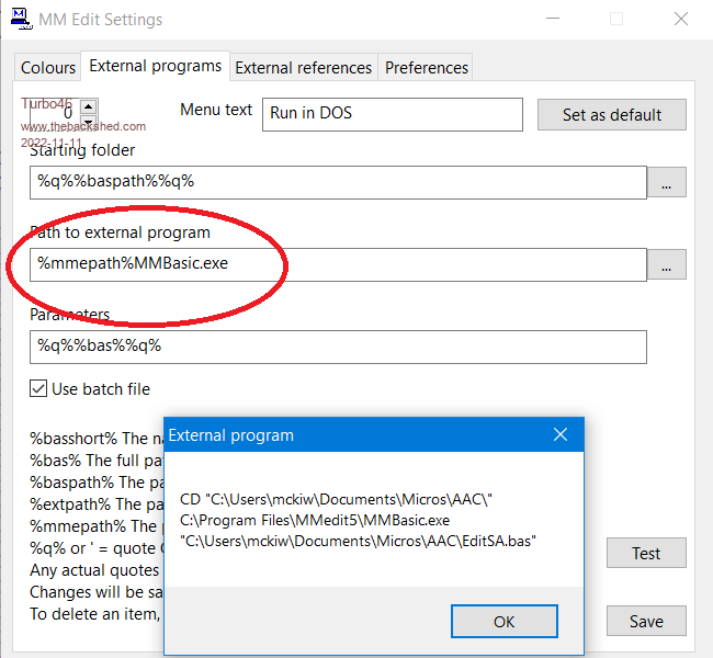

Thanks Jim, But (why is there always a 'but') my settings look like yours
Apart from the %q% replacing the single quote in yours.
The 'use batch file' box is ticked
There is no ext1 or ext2 in my MMEdit5.inf file.
The batch file is there in c:\program files\MMEdit5\ along with MMBasic et al.
Now when I click on the little gear icon nothing happens apart from a very brief blink of the display as if the focus is briefly going elsewhere.
Sorry.
Bill

  .inf said  External hot link = 0
Ext0 = Run in DOS|%q%%baspath%%q%|%mmepath%MMBasic.exe|%q%%bas%%q%|1
[New File Text]
The paths in the TEST box look correct.
I didn't bother to change the quotes.
I'm sure it is some simple thing that I am not grasping.

I notice that there are no quotes around the path to the exe. They will be needed due to the space in Program Files.
Either %q% or ' each end and you should be under way.

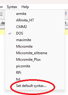

Did you add the quotes to the 'Path to external program'?
'%mmepath%MMBasic.exe'
Getting the system32 starting folder when you 'open with' from Windows Explorer demonstrates the problem I was having. Windows thinks it knows best and can be difficult to tame sometimes. That's why I went with the batch file.
To change the default syntax, select it in the Syntax menu then select the last entry: Set default syntax...
I must put a popup to acknowledge the change.

  Quote  Did you add the quotes to the 'Path to external program'?
No I didn't because it had the %q% there instead and you said the either/or is OK. If you check the screen shot above you will see them.
Then I checked again and they were gone? Don't know how.
So I entered the single quotes as per your example and IT WORKS!
Tried a few times just to be sure to be sure and it's still working.
Sorry about the 'set default syntax' thing I just expected it to save the last one used as MMEdit4 does.  It would be nice if you could indicate what the current default syntax is somehow though.

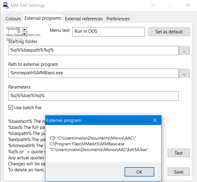

Posts: 6603
Posted: 06:03am 11 Nov 2022
Your screen shot shows the %q% missing.

  Quote  Your screen shot shows the %q% missing.
Of course it does, I was confusing it with the starting folder.

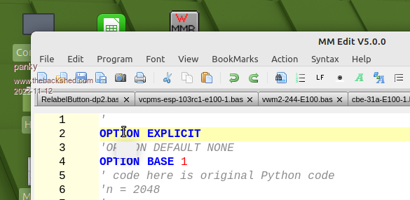

Hi Jim,
Perhaps unrelated but I have a problem with syntax help in the Linux version of MMEdit5
Positioning the cursor over a command - OPTION in this case - and pressing F1 just brings up a blank shaded box below the cursor
Shift F1 works fine bringing up the full syntax help window.
Thanks again for a great program.
Doug.

Posts: 6603
Posted: 03:09am 12 Nov 2022
Doug,
In the Linux version I am unable to show the help in the popup.(not my fault this time)
It is shown in the status bar at the bottom of the window. It replaces the file name until you move the cursor to a different line.
The Windows version can display the popup help but it also uses the status line.
I find holding the help while entering the rest of the line very convenient.
