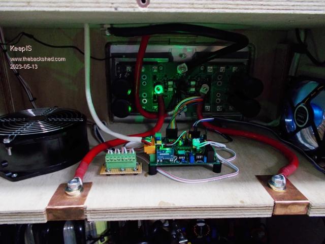

1: I wanted to make it easy to remove the controller board without having to undo screw terminals.
2: I wanted to make it easy to swap another type of controller in and out without mucking around with the external signals, VFB, IFB, FanSw and LED status indicator.
I fitted an 8 way header to the base and wired those signals to it, the plug is connected to the screw terminals on the Controller.
Now, simply unplug a couple of connectors and remove the board, easy, and no chance of making a mistake when reconnecting or shorting anything out.
Basically the Main cabinet interface wiring is now independent from the controller and inverter power board.
Interface connector is on the Left of the controller board.
Edited 2023-05-13 19:12 by KeepIS

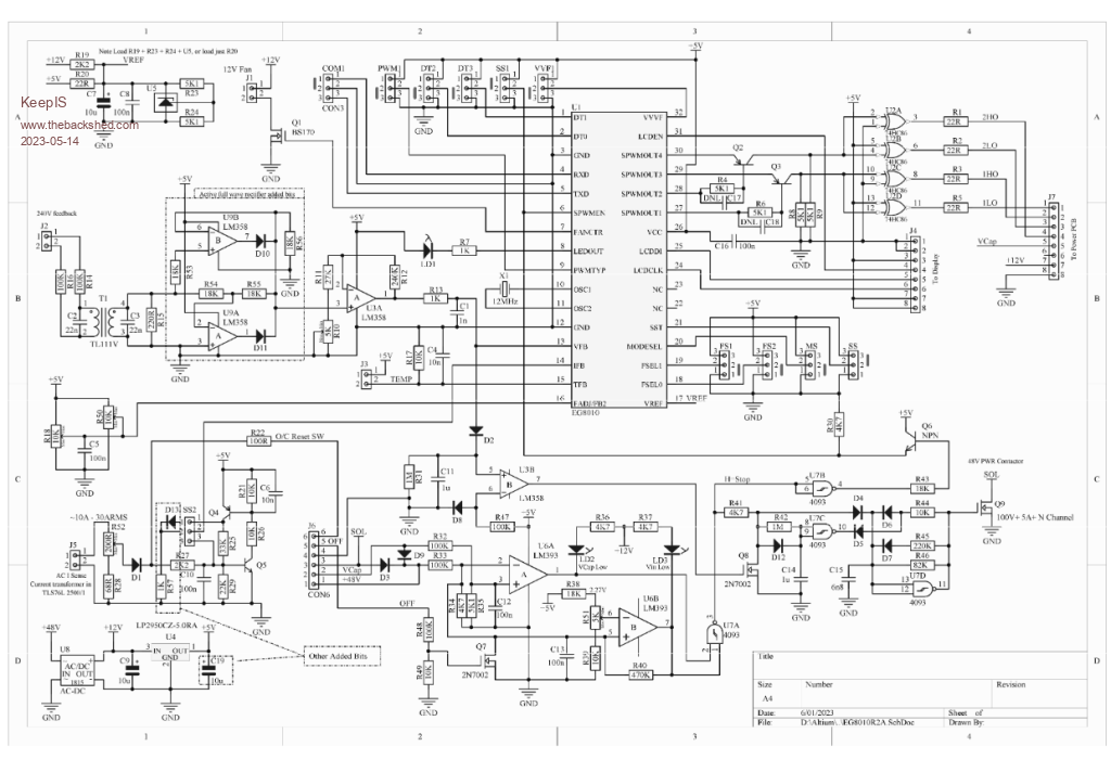

Am I missing something or is the Fan Control pin a complete joke on the EG8010 sinewave generator chip.
From the information sheet.
FanCtr pin:
Turns on at 45℃. It turns low when the temperature is below 40℃.
Pin TFB:
TFB’s over temperature voltage sets at 4.3V. EG8010 will set the level of SPWMOUT1 to
SPWMOUT4 at “0” or “1” and shut down all power MOSFET to decrease the voltage to zero
depending on pin (9)PWMTYP’s setting. Once over temperature protection activates, EG8010 will re-determine environment temperature. If pin TFB‘s voltage is below 4.0V
Now I just tested the TFB pin, and it triggers at 45℃.
The FanCtrl output is only turned ON at 45℃.
So, unless I'm missing something, we have a chip that waits until the thermostat shuts the Inverter down from over temperature, BEFORE turning on the fans to cool the over temperature condition. Not before, but after the device shuts down?
Shirley you can't be serious, I must be missing something?????
I do have a separate stand alone temperature control ready to wire in if this is the case

I've been testing the Current Trip on the bench, wondering if I could get the Digital display of current to indicate something instead of just indicating garbage values all over the place.
At the same time I was trying to figure why the LED from C of Q4 [pin 1 SS2] would not light if the link was between pins 2 and 3 of SS2.
I removed the added components and finally got a clean reading of on the LCD that increased in a linear fashion and did not hunt around.
However the Current trip LED always LIT on power up, to cut the rest of story on testing short: With pins 2-3 linked, to give me a meaningful readout, and adding a 4uf in series with a 2K resistor from pins 2-3 to ground, stopped the Trip at power up. Now it works perfectly, no false trip, a clear indication of the trip value as ac current varies.
I know you drive the collector voltage on trip via D13 to pin 2, and pins 2-3 if linked, but this stops me from resetting when pins 2-3 are linked, and the R57 stops a linear display of current if connected. I found the Latched voltage on Pin 2-3 is about 400mv above the Trip voltage and holds the IFB pin high correctly without D13.
I have removed LED LD1 from the board and placed a 2 pin header there, soldered the LED to a plug and added a big LED indicator on the front of the inverter control panel, the lead from the control panel LED also has a plug that obviously plugs into the LED header when the board is in the inverter, if I want to work on the bench, I just plug the "LED soldered to 2 pin connector" into the board.
Just tested everything with the BandSaw, adjusted R52 back until it tripped starting up the BandSaw, the lights flick as it trips and AC drops back Mains, the Inverter Front panel LD1 is flashing a double Pulse and the Current trip Button (has a LED) is LIT, press the button and Trip LED (button) turns off. A few seconds later the double flash stops and Inverter soft starts, whereupon the workshop LED lights flick once as it auto switches from Mains AC back to the Inverter AC power.
A slight adjustment of the POT and it can start the BandSaw and the Compressor @ 540A DC input, without tripping.
Perfect, those two indicators make a world of difference.

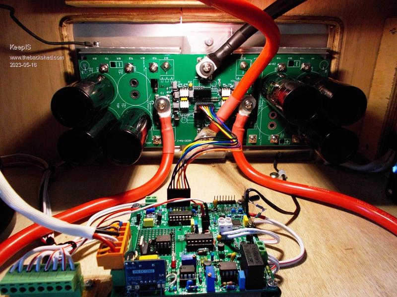

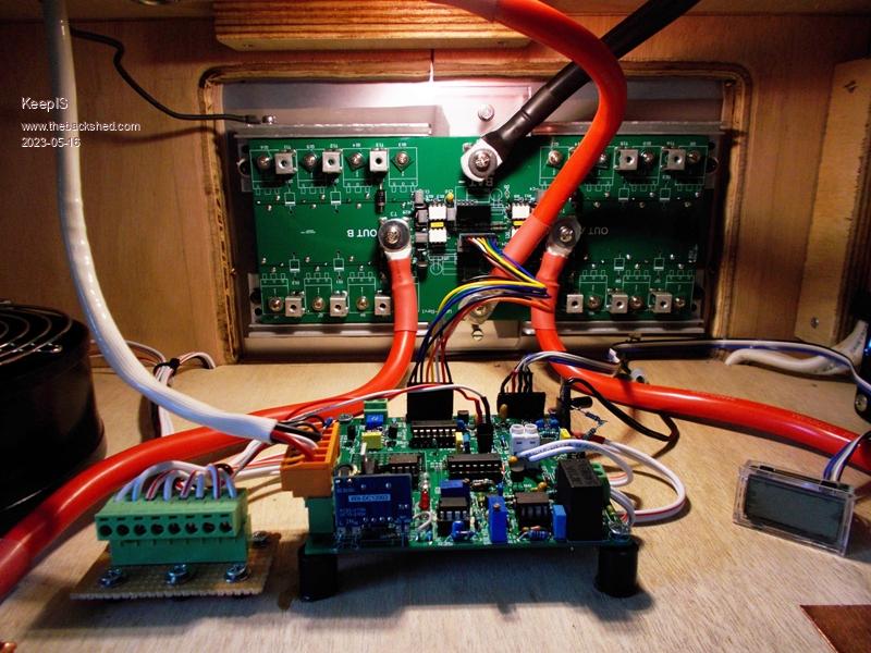

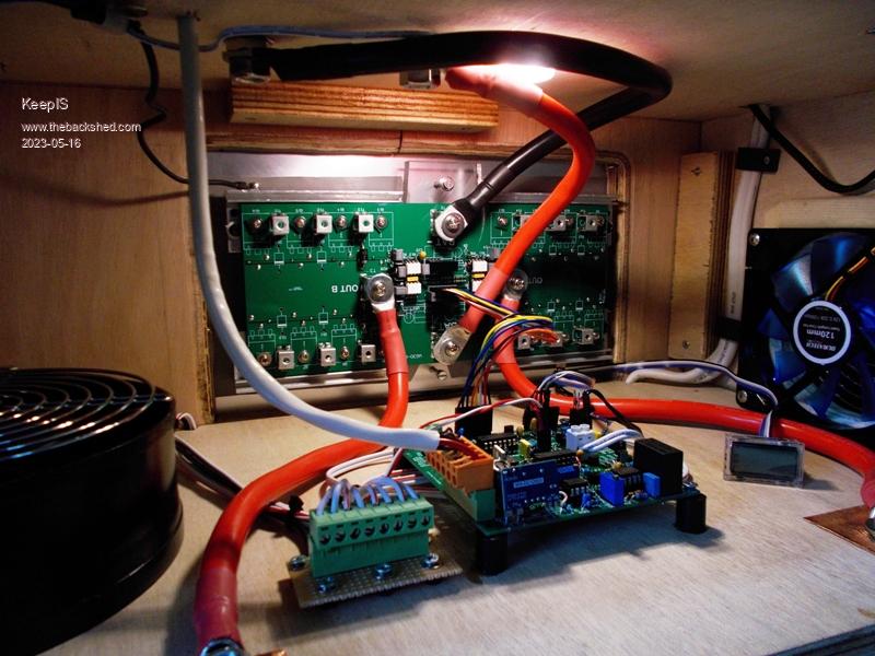

I added a door operated Flat LED light to the Inverter Controller and Power board deck.
While I was at it I took the Cap boards off, how fast can you unscrew 6 screws on each board with nothing in the way and complete access to everything? really quick.
I added another 2 x 10,000uF caps, this is to see if there is any change to the very slight warmth I felt running at a bit over 3kW for an hour or so.
A few Photos.
Cap boards removed. The LCD on the right is not going to be used.
With Caps and a spot for one more on each board, 60,000uF there at the moment.
The black leads going to the intermediate heatsink bars are Screw in temperature sensors.
BTW: You can see here that the Power board without the Cap boards doesn't even intrude into the cabinet.
Edited 2023-05-16 15:52 by KeepIS
