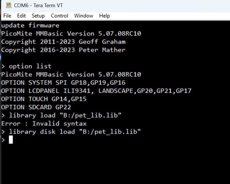

That's interesting,
with Bleep the LCD version works, with Lizby and me loading the library leads to a total crash.
To narrow this down,
OPTION SYSTEM SPI GP6,GP3,GP4          º
OPTION AUTORUN 1                       º
OPTION CPUSPEED (KHz) 252000           º
OPTION DISPLAY 28, 80d SELECT          º
OPTION LCDPANEL ILI9341, RLANDSCAPE,GP2,GP1,GP0
OPTION TOUCH GP5,GP7
GUI CALIBRATE 0, 368, 294, 882, 666
OPTION SDCARD GP22
OPTION AUDIO GP20,GP21, ON PWM CHANNEL 2
OPTION MODBUFF 128
I use an original Pico, not a clone with more memory. Since this is soldered in for reasons of space, in the Game*Mite I can't even change it quickly to test it with a Pico clone with more memory.
However, a test with a new bare clone showed the same result (endless boot),
At the moment I have no idea what the difference is, but I have to go to work now, so I can't look at it again until later.
@ Volhout
This only affects the Picomite version. the PicomiteVGA version runs smoothly.
I'm going to test your new version this evening   .
Have a nice one
Mart!n
Edited 2023-10-19 15:17 by Martin H.

MMBasic (non VGA) crashes through LIBRARY DISK LOAD even there is nothing configured
freshly unpacked, No SPI no SD Card etc. configured.
'no comment

  matherp said  Please post the library file in question and your complete option list when trying to load and exactly which firmware version you are using - suggest you re-download from Geoff's site before anything else.
the Lib file is in the Zip  Archve, Bleep posted yesterday.
I posted the PicoMite version in the Error message:
library delete
> library disk load "LCDLIB.BIN
Error: Invalid address - resetting
PicoMite MMBasic Version 5.07.08RC10
Copyright 2011-2023 Geoff Graham
Copyright 2016-2023 Peter Mather
so it is PicoMite MMBasic Version 5.07.08RC10
I don't know which version Bleep is using
Edited 2023-10-19 19:23 by Martin H.

Posts: 5998
Posted: 09:35am 19 Oct 2023
I created the magenta version of the library with RC10 (since ti requires RC10 to run). This version saves only the active part of the library (~90k), not the whole 100k, as in previous library publications. Maybe Bleeps derived version is incomplete ?
Could this be of importance ?

Posts: 11662
Posted: 10:20am 19 Oct 2023
Loads perfectly for me using the RC10 in the download from Geoff. Also tested on VGA version with no issues
UPDATE: loads but won't run as the index of sprite addresses seems wrong. Line 342 fails with invalid dimensions i.e. the w and h are out of range
