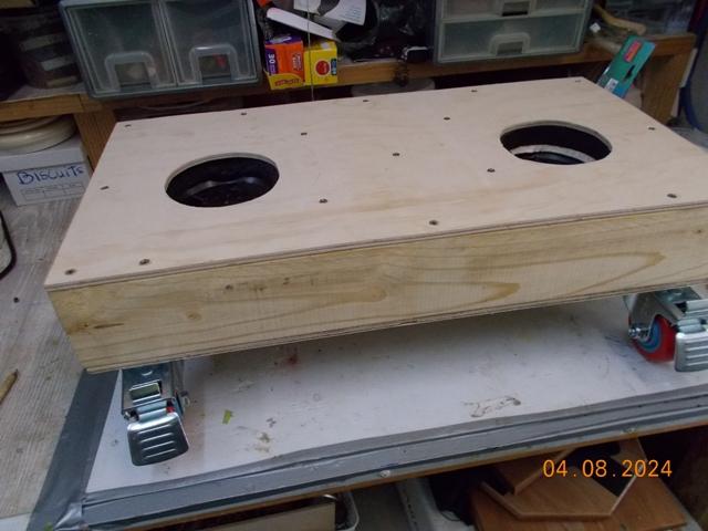

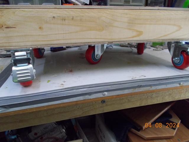

I was going to start building the toroid cases first, so glad I didn't, instead I built a 5 wheel Base that will support the cases that make up the inverter.
The frame is built with 90mm x 35mm pine, has three internal braces using the same timber, supporting the toroids on each side of the base, the top and bottom covers are 7mm ply.
I incorporated 2 x 100mm 240vac fans in the base, one for each toriod transformer.
The two fans are sandwiched between very thick dense rubber blocks that have some weight to them, but very springy texture, don't know what it is, but I removed them from some 12v LifePO4 battery boxes, they supported 4 heavy 3,2v cells on all sides.
The two 240v fans are wired in series when the temperature relay not energized, and they are absolutely silent - seriously silent when mounted between rubber blocks like this. In series, these fans exaggerate the natural convection air flow through and around the toriods, when Inverter AC is on, these fans run silently all the time.
I have found after a year and more of running a similar air flow setup on the existing single toroid, having this exaggerated convection air flow around and through the Toroid at all times makes an amazing difference to long term toroid running temperatures.
When the Nano controller Toroid temperature control kicks in, it enables a 12v 0.8W relay in the Base housing, this relay switches the Two fans from series to parallel connected for toroid cooling, and once again, the lack of any bearing or AC motor noise through the case is amazing. Once the toroids are mounted and the toriod cover is fitted, I doubt I will even hear this very high Air flow.
The light weight five wheel Base fully supports two x 3 stacked toriod transformers and 4 chokes, the fifth wheel means it will never sag, it supports two of us standing on it with ease, and I can lift it easily with one hand.
My plan to build two toroid cases has changed, now just a single removable cover over the two toroidal transformers and four 6 stack toriod ring chokes, these simply sit on the base, and no, they do not and can not move, no mounting hardware needed except for a simple mount for each choke.
Like most of us, I'm sure the plans will change slightly as the build continues.

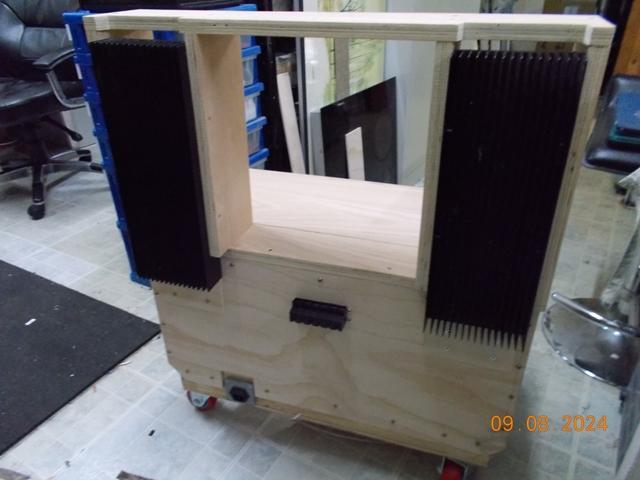

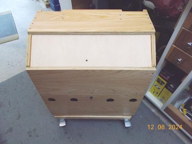

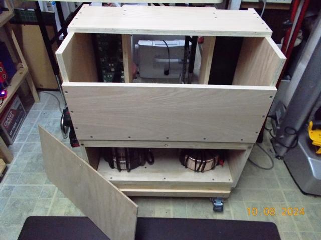

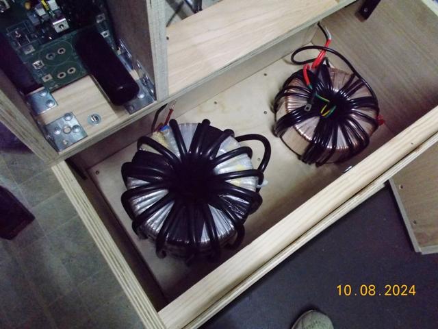

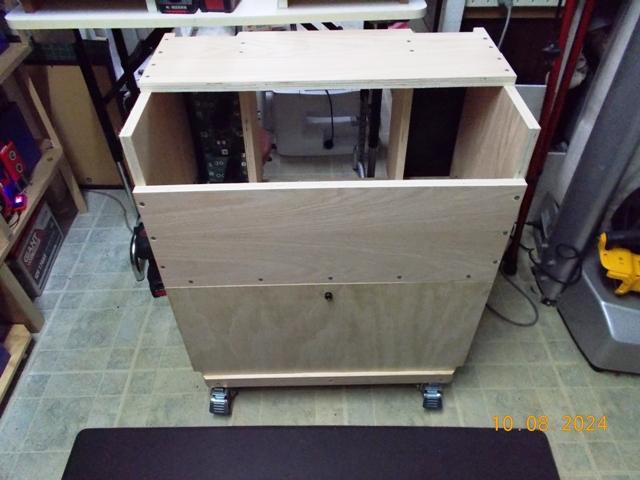

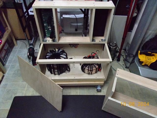

I finally have the basic cabinet finished, still has to be sanded and coated.
The pictures show only one 3 stack toroid, an Aerosharp toroid is there just to balance the weight as I built the cabinet.
The PLY cover over the Toriod housing will be replaced with 7mm thick hardwood which is the same material appearance as the 18mm case, the same 7mm ply will be used to make a sloping front display/control panel.
The idea was to make servicing or modifying as simple as possible, and make choke or toroid removal or modification easy to do.
Each power board and heatsink take only minutes to remove or install.
The lower Toriod cover sits in a slot, it's held on with rare earth magnets and a lock bolt in the center top. The Big opening in the top compartment is for the Sloping panel for inverter controls, meters and various LCD displays and LEDs.
The large compartment and display panel (not fitted) simply lifts out for full access to the Toroids, that compartment will plug into the back panel (not fitted) making it simple to remove, the display panel will hinge down for access and adjustments without having to remove the compartment.
The front cross bar is held in with a big Hex screw and metal screw thread inserts in each end of the cross bar, removal allows full unhindered access for Toroid removal.
Heatsinks are retained by two metal screws on each side. Lower AC socket is for dual base Fans. Large terminal block is for the Dual toroid AC outputs.
Still needs the center back cover and toroid compartment exhaust ports.

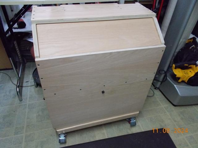

Getting closer, sanding, edge round-over and stain / oil to go.
I will start the wire up in a day or so, then shut down the current Inverter and transfer that 3 stack toroid into the new cabinet.
I'll be using a temporary control panel that I can botch up and finalize the layout with before transferring the final design over to the good control panel, but I will have the inverter fully running with the ugly temp panel before that.

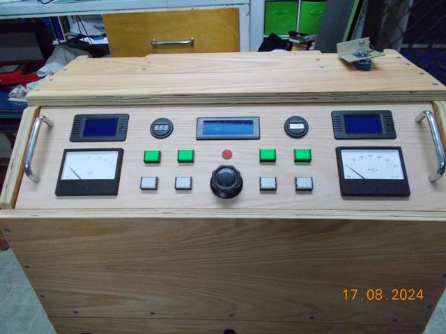

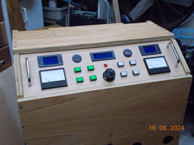

Finished a bit faster than I thought, start wiring and component layout tomorrow, dam Chinese wood oil has a strong smell (plant based).
I'm thinking of taking the main Inverter off line tomorrow and just swapping the power board, Nano controller and Toriod over to the new cabinet.
That should allow a build to basic test running state of a couple of days.
Sacrificial mock-up front panel fitted, cabinet looks way better in real life.

Thanks, it looks a little strange, but this one is all function over form, don't care if cabinet screws are showing, or timber does not match.
The base area is similar to the last smaller unit, but this one is higher, so in reality it takes up no more floor space, the 5 rollers are a joy to move the weight of this cabinet with twin 3 toroid stacked transformers, 4 big heavy chokes and two big heatsinks.
It may not look like it yet, but this is designed to give the cleanest and shortest heavy 2G and 0G cable flow from the battery to the kilovac, power boards, chokes, and Toroids, along with maximum natural convection airflow over two long vertical mounted heatsinks on the cabinet back, and fan enhanced convection air flow with high flow forced fan cooling through and all around the two toroids as needed.
This also evolved as I built it, and now that it's built, I would not change a single thing about it, it's the cabinet I wished I had built after finishing the first build, but isn't that usually the way it happens.

I have been dreading cutting out the front panel, so I made a timber template first and mirrored it on the front panel at each end as a cutting guide, I had planned a day (tomorrow) for doing this because of how careful I have to be with it.
But a few hours this afternoon and it's almost ready, the fancy color lettering overlay will be made and fitted after the inverter is fully tested, just in case I need another LED or switch added. A quick test fit and everything is aligned and fits perfectly.
Now only two small Heat-sink temperature meters, a power switch, reset switch and LEDS, and I can wire this up for the Nano controller and other Sensors.
BTW The front panel does not require any holding screws because of the way it's recessed in opening, the handles allow it to be lifted out and placed on top in an instant. This is just so easy to work on.

Posted: 09:06am 16 Aug 2024
Getting close now.

The top row of meters are L to R
1: Power stage 1 DC Volts, Amps Power
2: Heat sink 1 temperature
3: Nano controller LCD
4: Heat sink 2 temperature
5: Power stage 2 DC Volts, Amps Power
Two analogue meters are 600A FSD Peak DC Input current:
LH - Power stage 1
RH - Power stage 2
Bottom row LED indicators (white) are Two on the Left - Power stage 1 and Two on the right Power stage 2, AC and DC current trip Indicators.
Middle Green LEDs:
1: Battery 53V DC connected
2: Low Voltage Input
3: RED LED: Nano Controller Status LED
4: Main Over current RESET button plus OC Indicator
5: Dual Power Mode enabled.
Center large Black knob - 3 position Inverter power:
(1) OFF - (2) AUTO start - (3) ON
