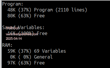

Hi Mick,
Including a program into the library, something as large as the filemanager, may not be a good thing. Note that the filemanager then is part of your user program. All the memory it reserves (for all the filenames) become part of your programs heap. And to handle large (SD card) file systems, they reserve quite a lot of heap (59k of 100k on a VGA unit with twofingers KLINGON version of the filemanager).
The result will be that your user program can only be small (cannot use large arrays or lots of strings). Maybe sufficient for your fish tank controller, but that is it. And since it is in the library, that accounts for ALL program you want to run on that pico.
When it is in a flash slot, it is -either-or-. So it is a separate program, and yes, it uses a lot of heap, but when you close the fm, and start your own program all heap is yours.
I think it is wise to keep it in a flash slot.

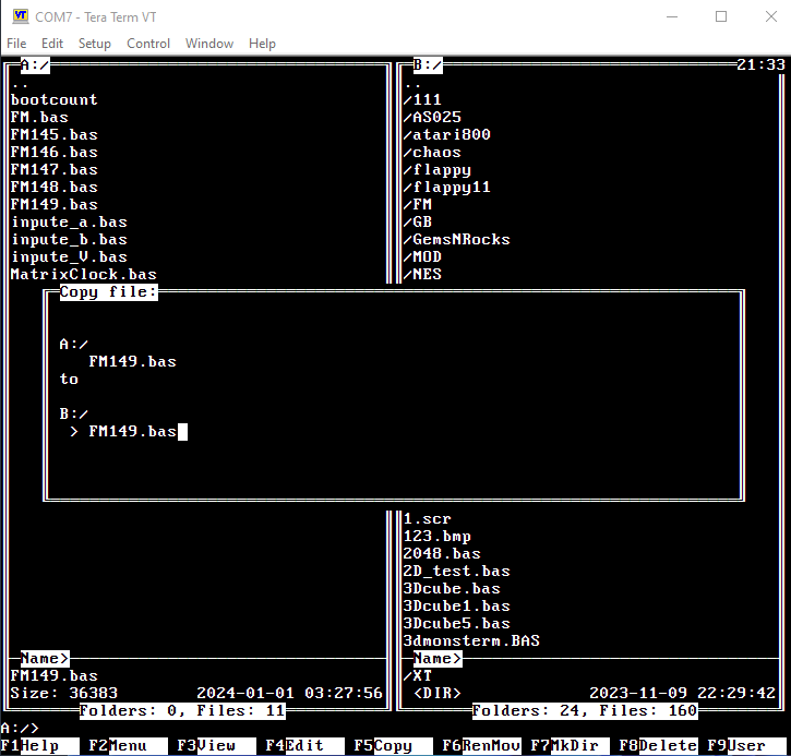

javavi
Joined: 01/10/2023
Location: Ukraine
Posts: 603
Posted: 07:30pm 16 Apr 2025
FM 1.49
NEW Input Line EDITOR. Thanks @twofingers
CHANGED some file coloring colors @Volhout
You can disable file coloring by explicitly specifying the color of the constant.
DFColor=15 for all white!
In the future I want to make a configurator for color settings and other things in the program itself
FM149.zip
With the terminal properly configured, File Manager works simultaneously on both the local PicoMite VGA/HDMI screen and the PC terminal.
Edited 2025-04-17 05:34 by javavi

question: How can I rename a file with "F6 RenMov" without moving it to the other drive? Somehow I can't get it to work and I think I'm missing it.

  homa said  question: How can I rename a file with "F6 RenMov" without moving it to the other drive? Somehow I can't get it to work and I think I'm missing it.
Hallo! Matthias,
To rename a file, you need to select the same directory on both panels and change the file name when moving it using F6.
However, I checked and I couldn't switch the panel to another disk via the console.
It looks like the console doesn't transmit the Alt key code. It looks like the terminal doesn't transmit the Alt key code, but uses it to switch to its menu.
I'll fix this and also see what can be done about other issues.
Thanks for the feedback ;))

Posts: 6094
Posted: 06:13am 17 Apr 2025
@javavi,
Twofingers found the same. In the "non-VGA" version of his filemanagers he used the BACKSPACE key to toggle (as ALT does in the VGA version).
Later on he changed the behaviour to use the DELETE key to toggle the active pane between A:/ and B:/
(as there is only A and B, a toggle avoids the use of function keys al together).
You could try his "KLINGON" version (the last version) to see if you like the behaviour before you implement it. But it is only console.

File Manager v1.5
@homa
+ Additional [BS] Key for enabling [Alt]ernative functions via terminal
+ When exiting a folder, return the cursor to the previous directory
@twofingers
+ Copying and moving folders with files
+ Launches when there are a large number of files, but displays only the maximum file list size set.
FM150.zip
